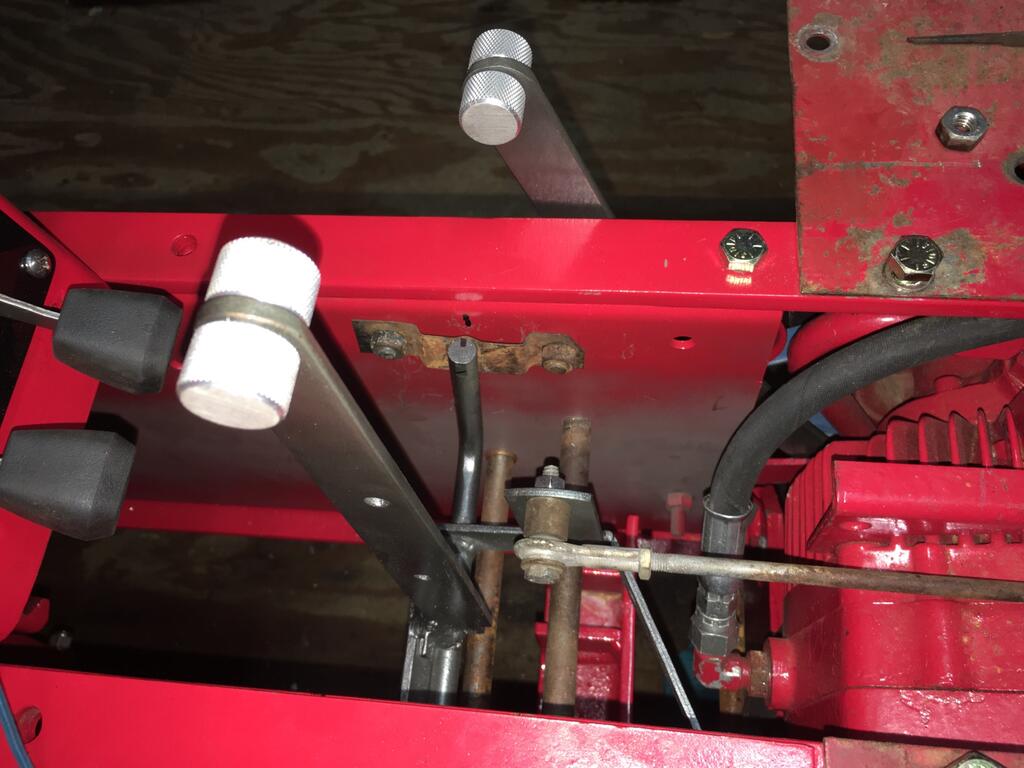

rmaynard 17,578 #4 Posted July 16, 2022 By the way, whatever happened to Gene Simpson? He went by haasman35, then @Gene_S. He used to make a set of three nice aluminum thumbscrews. Anyone heard from him lately? Share this post Link to post Share on other sites

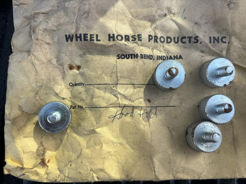

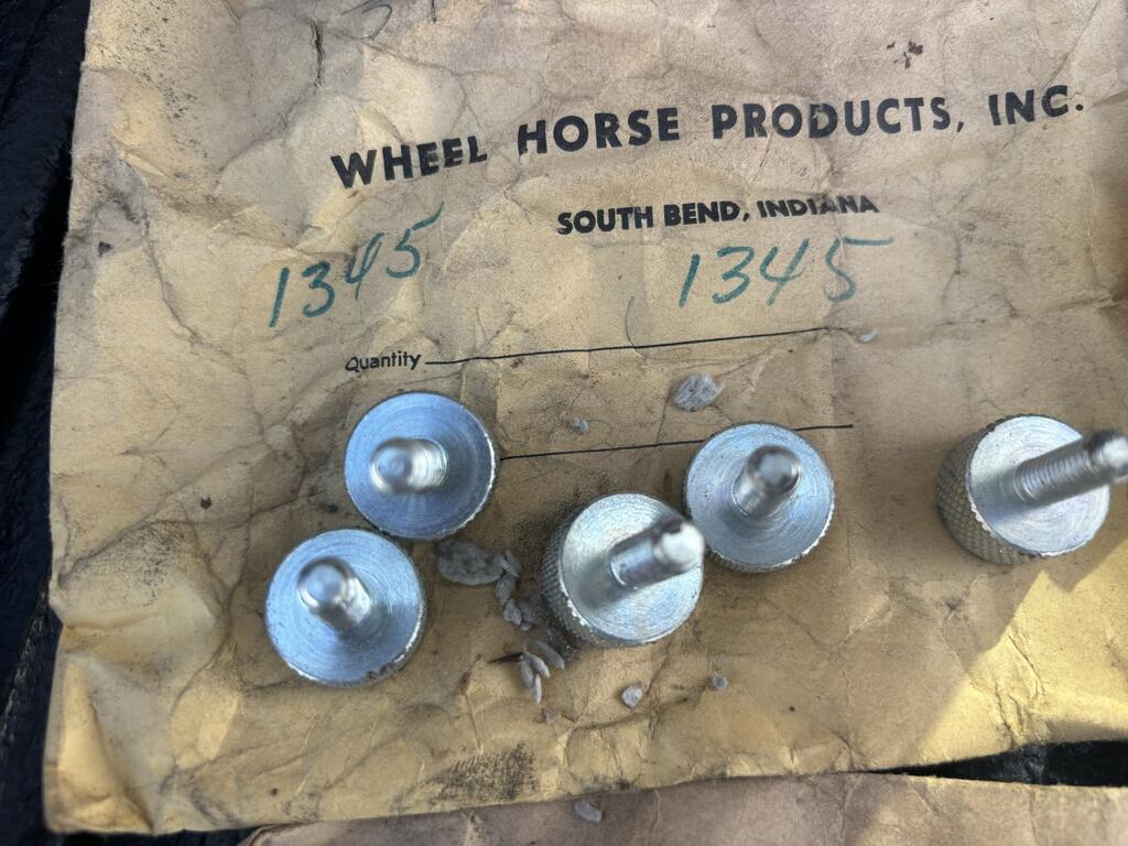

Wild Bill in VA 1,596 #5 Posted July 17, 2022 One of the original problems with the thumb screws was that the lower screw that holds the bottom of the hood (part number 1346) was 3/4 of an inch long in the length of the threads and if a person just threw the thumb screws in place and turned that long thumb screw into the gas tank ..... well things broke! The thumb screws in the gas tank were part number 1345 and had a length of 3/8 of an inch. The thumb screws were used on Wheel Horse round models from the 1961 model 701 all the way till the 1968 Lawn Ranger. Another odd fact was that Wheel Horse used lock washers under the thumb screws only on the models that did not use the aluminum gas tank, the 1964 model 654 would use lock washers but the 1964 model 854 did not. Now here's a story that got a few folks upset at an auction in Pennsylvania, a dealer that I knew was selling out and held an auction to get rid of old inventory. Before the auction I pulled the owner aside and ask him a question, he then took me over to a flatbed trailer full of old parts and pointed to a box. Well when that box topped full of old chainsaw gaskets came up to be auctioned, I just held my hand up for auctioneer to take my bids and I got the box real cheap. Folks started to look at me and wonder why did "Mr Wheel Horse" buy a box full of old chainsaw gaskets???? Because right underneath of the gaskets in the box it was full of 1345 and 1346 thumb screws, some N.O.S. and some old! Wild Bill in Richmond VA 4 3 Share this post Link to post Share on other sites
19richie66 17,932 #6 Posted July 17, 2022 23 hours ago, rmaynard said: By the way, whatever happened to Gene Simpson? He went by haasman35, then @Gene_S. He used to make a set of three nice aluminum thumbscrews. Anyone heard from him lately? I have bought several sets from Gene through facebook. Very nice too. I used them on my gt14 shift levers. 1 3 Share this post Link to post Share on other sites
rmaynard 17,578 #7 Posted July 17, 2022 2 hours ago, 19richie66 said: I have bought several sets from Gene through facebook. Very nice too. Thanks for the info. I contacted him and he is taking care of me. I've purchased two sets from him before and I like his quality. 3 2 Share this post Link to post Share on other sites

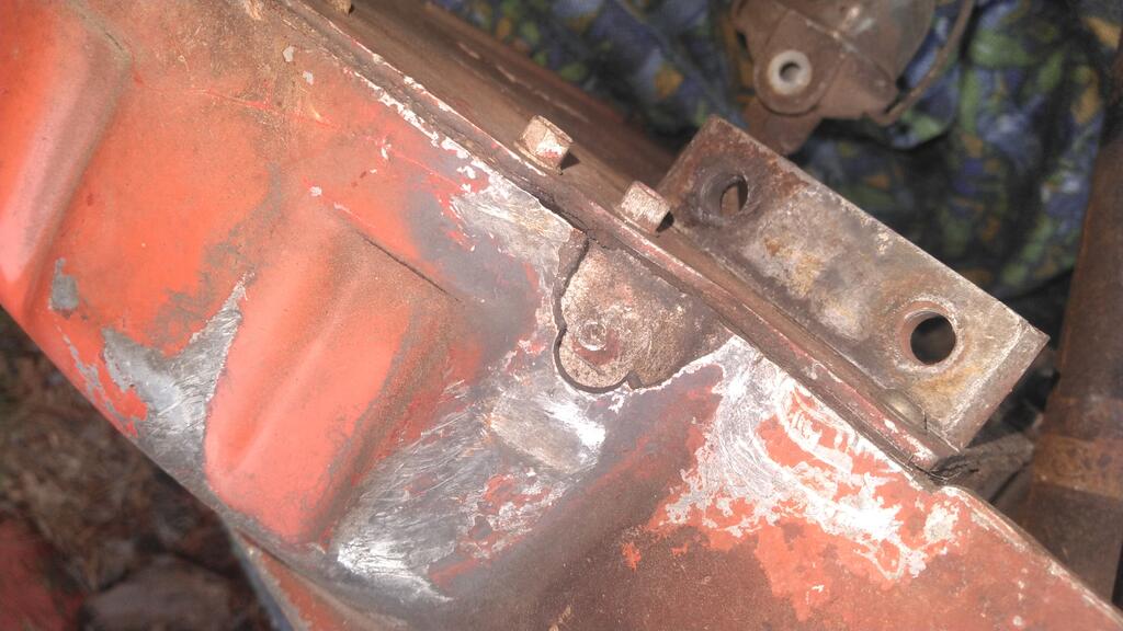

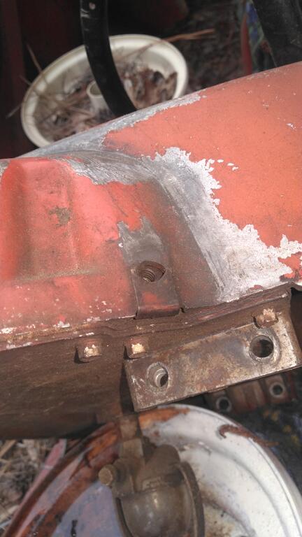

Wild Bill in VA 1,596 #10 Posted July 17, 2022 On 7/15/2022 at 8:31 PM, raymater99 said: Quick question to see if anyone knows what the name of the part is that the thumbs screw for the hood screw into and where I could get them. The gas tank of my 854 is missing these on each side and there is nothing to screw these into. I looked at the user manual and I did not see this part listed. Thanks I believe this is the part you're asking for, it is called a "J" nut in a 1/4 x 20 thread size. They slip up into the cast cut out, so you can turn the thumb screws into to hold the hood on. As you see what happens when a longer thumb screw or bolt is used. These are industrial standard parts and can still be found. Wild Bill in Richmond VA Share this post Link to post Share on other sites
