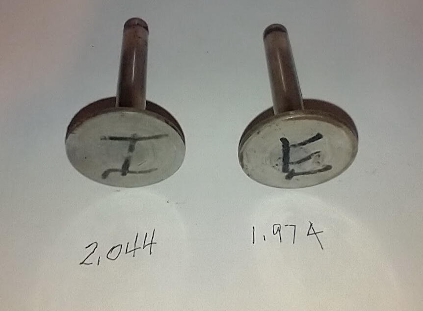

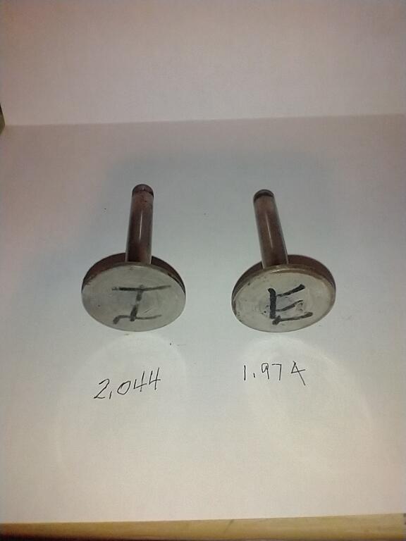

rmaynard 16,771 #9 Posted July 15, 2022 (edited) 6 hours ago, squonk said: Exhaust tappet for ACR cam is 2.02" Spark advance 1.964 Hahaha 😂 Apparently I marked the tappets wrong when I removed them from the K181 over 5 years ago. Edited July 15, 2022 by rmaynard 1 Share this post Link to post Share on other sites

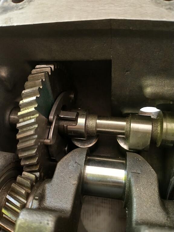

rmaynard 16,771 #10 Posted July 22, 2022 On 7/15/2022 at 7:30 AM, squonk said: Exhaust tappet for ACR cam is 2.02" Spark advance 1.964" Cam end play .005"-.010" Actually Mike, it's not. As I showed in the picture below, which I thought was marked wrong, the intake tappet is longer than the exhaust. 62 When I installed the 2.044" tappet in the exhaust location, it stuck up way too high. So I replaced it with the 1.974" tappet and clearly it was the correct one for the exhaust. And to make me even more nutz, it was way too long for the intake as well. I didn't check the K181 to see if anything was different. So I ended up with the 1.974" in the exhaust, and a 1.962" from the K161 in the instake. I still had to grind the valve stems for both. Now, for the life of me, I don't see any difference between the exhaust tappets other than 0.012" in length. Anyway, the tappets are installed, and the ACR cam is installed as shown ACR functions correctly, and my specs are as follows: Tappet clearance: .006 intake, .017 exhaust Valve lift: .308 intake, .311 exhaust So if anyone can tell me if I did anything wrong, let me have it. Share this post Link to post Share on other sites
