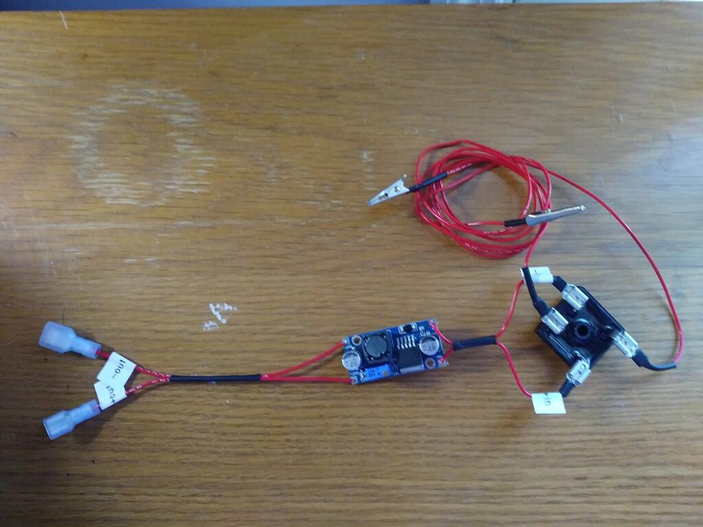

subvet720 179 #1 Posted July 11, 2022 Just finished a little gadget to tie into the headlight circuit on my 310-8. A bridge rectifier converts the AC to DC (12-25VDC) and buck converter dials the DC in at 12VDC using the potentiometer on the board. With the light load the LEDS provide, I will be able to run bunches of addressable LEDs from my phone. Parts: LM2596 DC-DC Buck Converter - $3 on the Amazon (Thanks Jeff Bezos!) GBPC25005 Bridge Rectifier (or similar) - $3 on the Amazon (Thanks again Jeff!) By doing this, I eliminate flickering LEDs if they are run on AC and no need for an extra battery strapped on the mighty Conrad Weiser Marching Band Wheel Horse. 1 7 Share this post Link to post Share on other sites
Jeff-C175 7,209 #2 Posted July 11, 2022 52 minutes ago, subvet720 said: run bunches of addressable LEDs from my phone. I know I could ask Mrs Google, but could you elaborate on this a bit please? 1 Share this post Link to post Share on other sites

subvet720 179 #7 Posted July 12, 2022 7 hours ago, Jeff-C175 said: I know I could ask Mrs Google, but could you elaborate on this a bit please? Addressable LEDs have an IC with each LED that allows each one to be controlled independently. Using a microprocessor, Arduino Nano in my case, you can put on a really nice light show. Thanks to our Chinese friends, all of the components are very inexpensive. 3 1 Share this post Link to post Share on other sites
