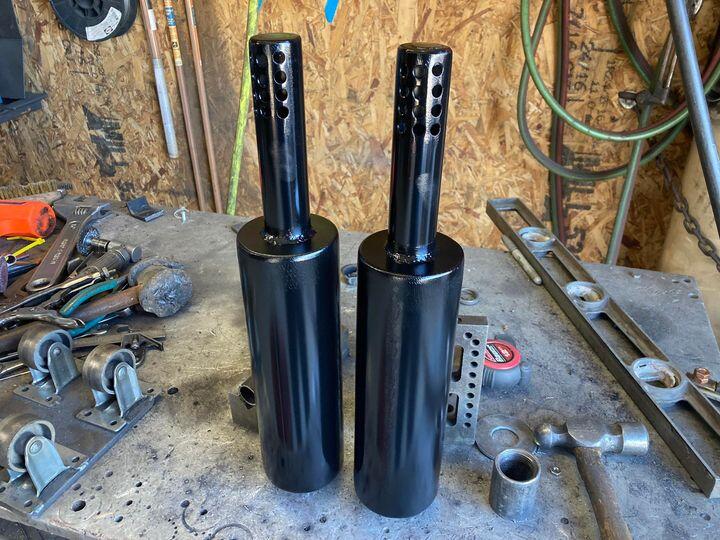

jimkemp 528 #1 Posted July 11, 2022 Well i have been building the chrome stacks for years now , this is the first set of D200 stock location mufflers i have built , hopefully the owner of this pair will post some pictures when installed and give us all a report on them , still building the chrome stacks but the price of material has gotten crazy so im going to venture out into other styles here in the near future 12 Share this post Link to post Share on other sites

OutdoorEnvy 1,807 #4 Posted July 11, 2022 Those are sweet! Nice work! 1 Share this post Link to post Share on other sites

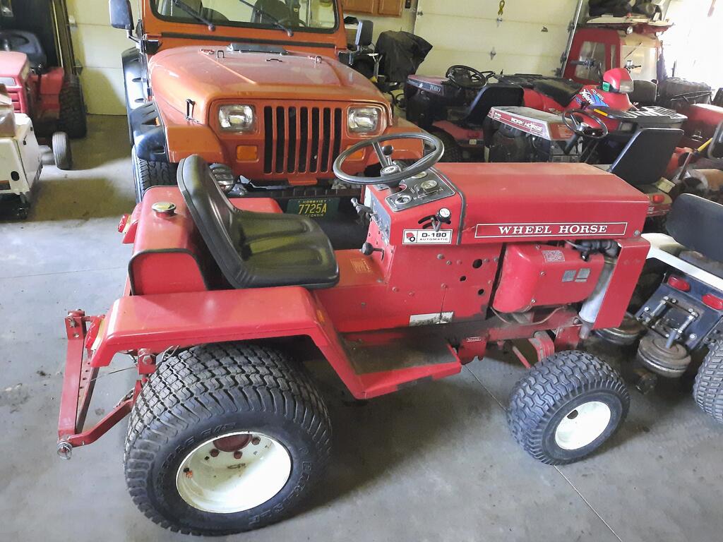

jeremi3210 743 #7 Posted July 11, 2022 18 minutes ago, WHX?? said: Didn't know you had a D Jer. You and Jacob are gonna love seat time on @Achto's & take the missus out for a love ride! We just picked it up, d180. That would be fun, the d's kinda grow on ya. This one is in amazing shape just missing one muffler. And best thing is I know the hydro is good cause I rebuilt a few years back. 1 5 Share this post Link to post Share on other sites

jimkemp 528 #9 Posted July 12, 2022 22 hours ago, jeremi3210 said: I'd be interested in some d mufflers! Let me know if ya build some more. Well the prototypes are on there way , hopefully they work out and i will build more if they do , please stay tuned 1 1 2 Share this post Link to post Share on other sites

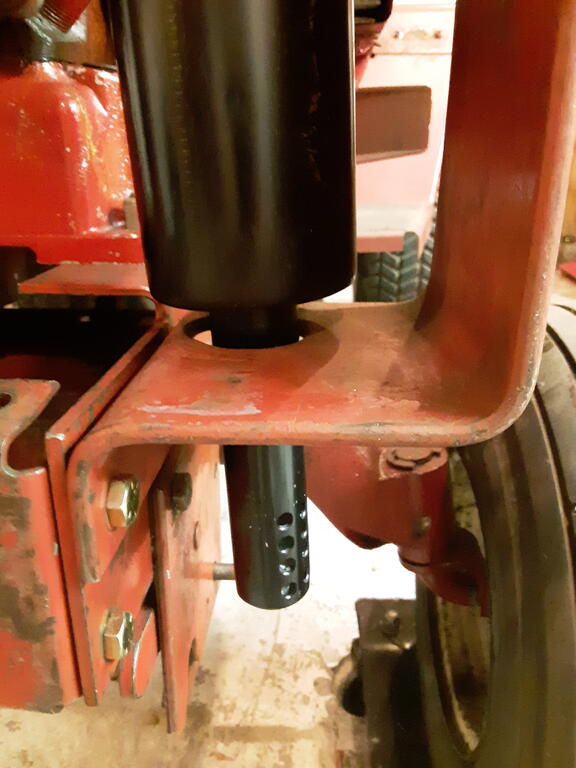

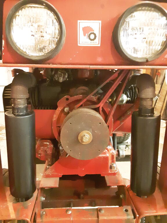

BMW1 44 #10 Posted July 18, 2022 I made some videos and included some pictures of the D200 mufflers Jim Kemp made for my D200. I am very happy with them and did not have any issues installing them. I used a 1" x 2" steel nipple(purchased at Home Depot) at the top. The video sound quality is not that good. I don't have a decibel meter but no muffler was definitely louder. Jim's muffler sounded better than the showerheads, in my opinion. Jim's muffler was a lot heavier gauge material then the stock mufflers on my other D200 and look significantly better than the showerhead mufflers. MufflerOff.mp4 MufflerShowerhead.mp4 MufflerJimKemp.mp4 1 Share this post Link to post Share on other sites
sjoemie himself 3,106 #11 Posted July 18, 2022 @jimkemp nice work on the mufflers, looks like heavy duty quality. If I may ask, what does the inside of your muffler look like? Do you use baffles for silencing or do you use a 'straight-through' design with perforated steel and rockwool or something similar? Share this post Link to post Share on other sites
jimkemp 528 #12 Posted July 19, 2022 5 hours ago, sjoemie himself said: @jimkemp nice work on the mufflers, looks like heavy duty quality. If I may ask, what does the inside of your muffler look like? Do you use baffles for silencing or do you use a 'straight-through' design with perforated steel and rockwool or something similar? They are fully baffled inside just like my stack mufflers , they are not straight through design , the exhaust changes direction twice before the outlet , sound waves changing direction cuts down the db 2 Share this post Link to post Share on other sites
sjoemie himself 3,106 #13 Posted July 19, 2022 9 hours ago, jimkemp said: fully baffled Thank you so much, that explains a lot. I've been struggling with my diy stacks being too loud. They were built in the 'straight through' design thinking that would be best.. my mufflers are probably too small to work in this configuration. I'll try again with baffles 1 Share this post Link to post Share on other sites
