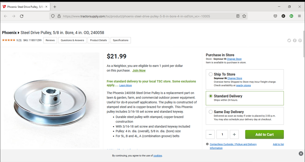

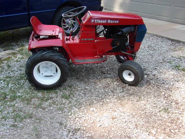

Snoopy11 5,731 #84 Posted July 26, 2022 So... the pulley on the 110995 transmission is a 5/8x6.5 inch pulley... thus... I plan to go with this: Don 1 Share this post Link to post Share on other sites

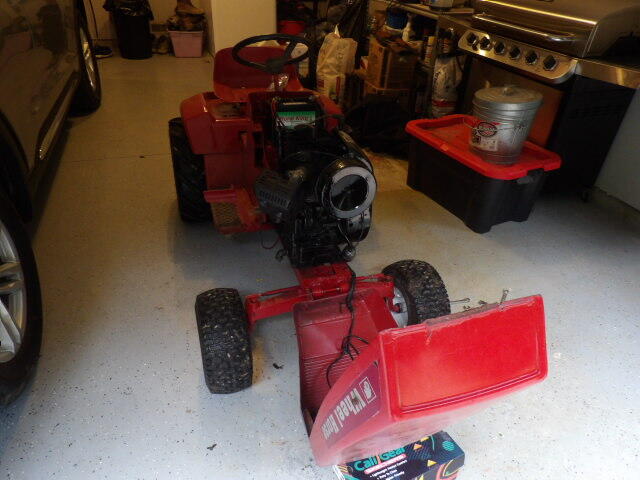

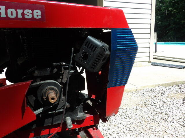

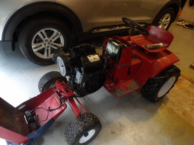

Snoopy11 5,731 #85 Posted July 29, 2022 (edited) I got the muffler changed today. I hated the look of that big muffler coming out of the side... Oh, and as you can see in the picture... I put a 90 degree oil drain plug in... instead of the long piece of steel pipe that went over the axle... See below for the "before" oil drain Don Edited July 29, 2022 by Snoopy11 1 3 Share this post Link to post Share on other sites

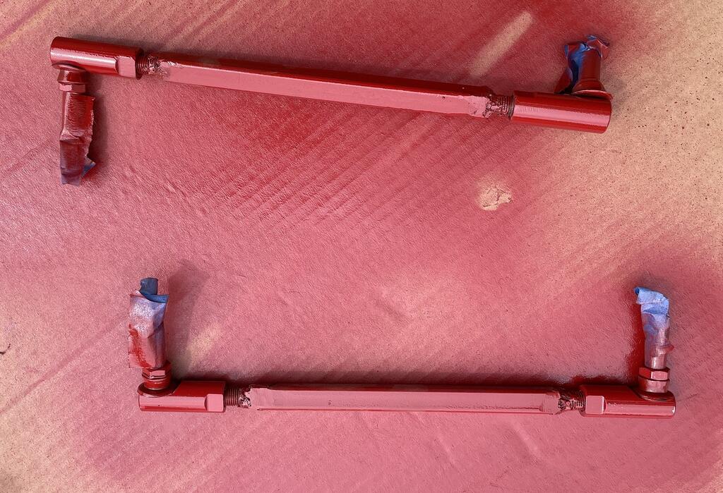

davem1111 2,320 #91 Posted August 1, 2022 Tie rods: I thought I'd add this here, since it's somewhat related to Don's resto-mod. Before I gave him the tractor, I wanted the 8" wheels off the front to replace the 6" ones on my 312-A. I had them mostly swapped before I realized that this changed the required tie rod length on BOTH tractors. I guess the "ear" location on the spindle is different. I don't know if Don was able to adjust his enough or replaced them, but mine would not adjust far enough, so I needed to replace them. New required tie rod length was about 10". Buying another set of "stock" tie rods wasn't likely to work, since they would be the wrong length too, so I looked at some options to make some new ones. I'm kind of wishing I had gone with the Heim ends that someone suggested... I went with standard ends. I couldn't find 3/8" 24 threaded rod locally so I ordered a long piece. At Lowes I noticed that a 3/8" rod slid nicely into a 1/2" square steel tube so I bought some of that too. These new tie rods are 3/8" 24 threaded rod inside 1/2" square tube, with a little weld at the end of the tube to keep it from sliding around. I guess I could have used nuts to accomplish that but 1) it didn't occur to me at the time, and 2) I didn't have enough 3/8" 24 nuts on hand when I dove into this. I think these will serve well, but if not, I have some experience making them now and some ideas how to make even better ones. Tractor is back in service, front alignment is straight, and she steers nicely. 5 Share this post Link to post Share on other sites
ebinmaine 80,433 #92 Posted August 1, 2022 1 hour ago, davem1111 said: serve well You'll be just fine with those Dave. Very innovative replacement. 1 Share this post Link to post Share on other sites

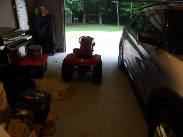

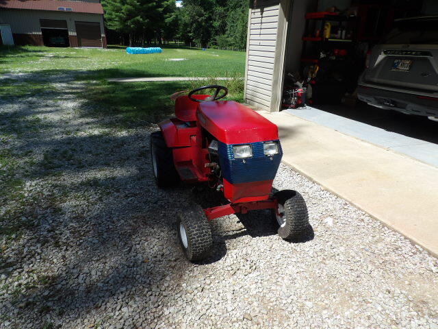

Snoopy11 5,731 #93 Posted August 5, 2022 First comment... now the 416-8 won't stop following me around... it goes everywhere I do. I realize that I am attached to it... but... gosh... now it is attached to me... Second comment... now the 416-8 wants special treatment, air conditioning in the garage...??? The L-157 and the 800S are jealous... Don 1 2 Share this post Link to post Share on other sites
ebinmaine 80,433 #94 Posted August 5, 2022 1 hour ago, Snoopy11 said: now the 416-8 wants special treatment, This can happen with the newer members. They must be carefully assimilated into the herd. 2 Share this post Link to post Share on other sites

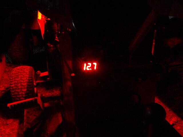

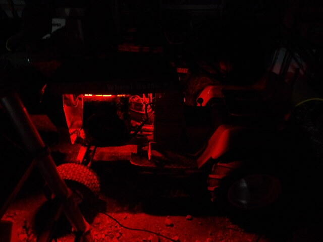

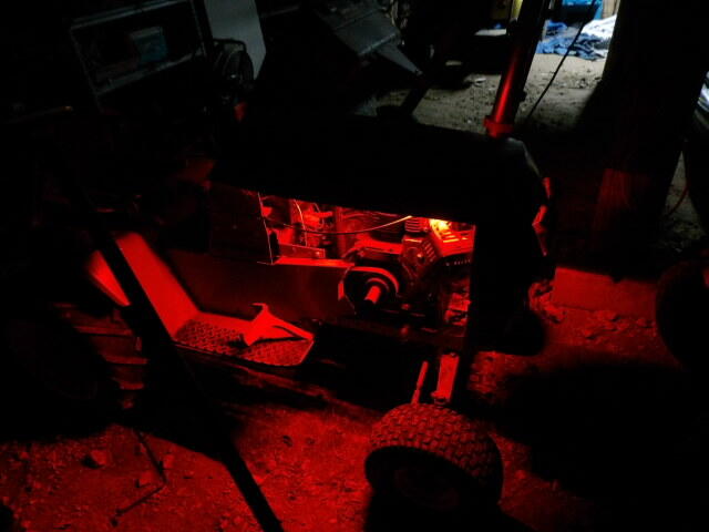

Snoopy11 5,731 #96 Posted September 29, 2022 Got some more goodies on the old girl... @ebinmaine ...I think BBT will like this.... it glows... Don 1 1 Share this post Link to post Share on other sites
