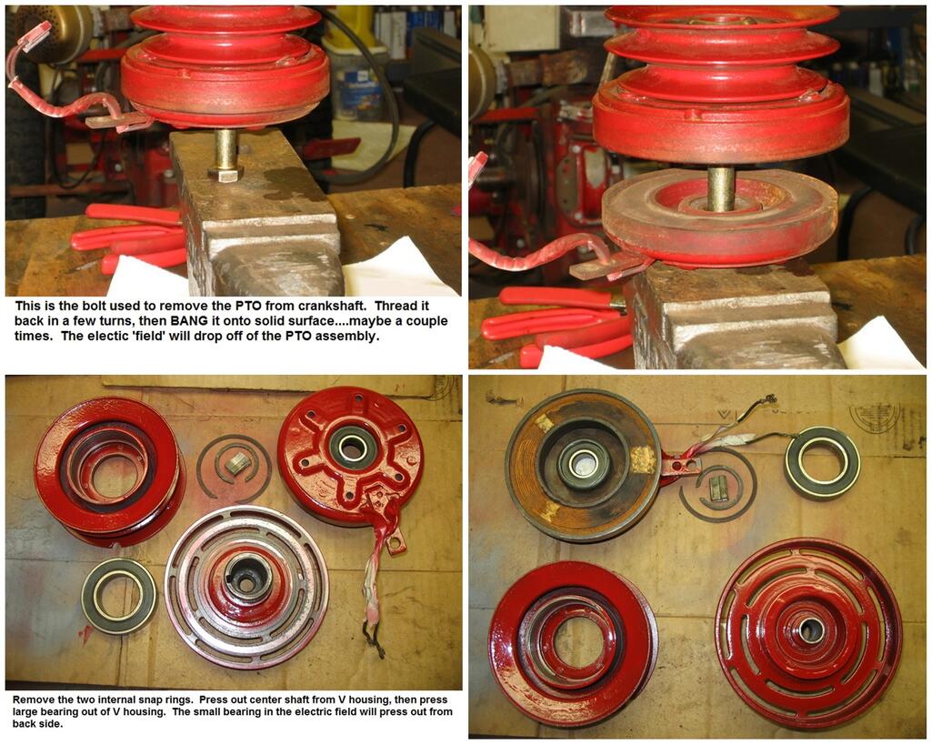

daveoman1966 3,882 #4 Posted July 10, 2022 On 7/6/2022 at 6:01 PM, David Young said: Does anyone think if I put an 1"125 shim in electric pto that it would work on my 1" shift. can't find 1" for mine. Actually, I have an Electric PTO for the 1" dia Crankshaft. Well, everything for it except the Field Winding. $50 bux for it + $9 to ship (via USPS Regional A Box) If you have the field winding, just swap it over to the 1" E-PTO that I have for you. That is easy to do... See this pic for 'How To' Share this post Link to post Share on other sites
