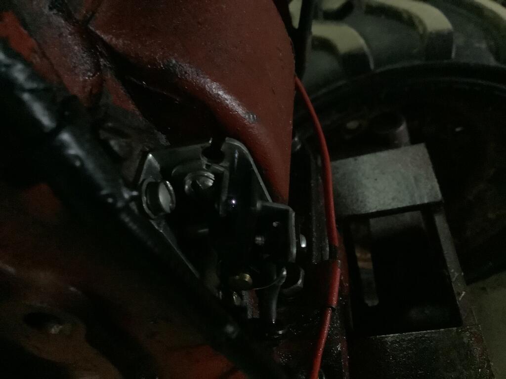

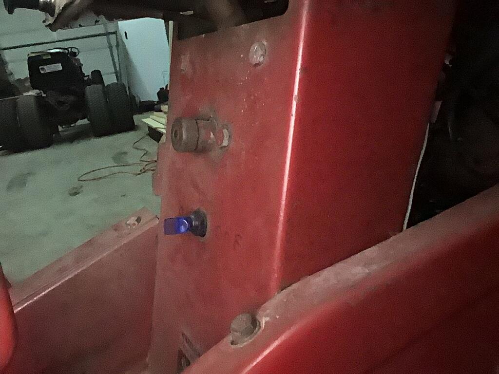

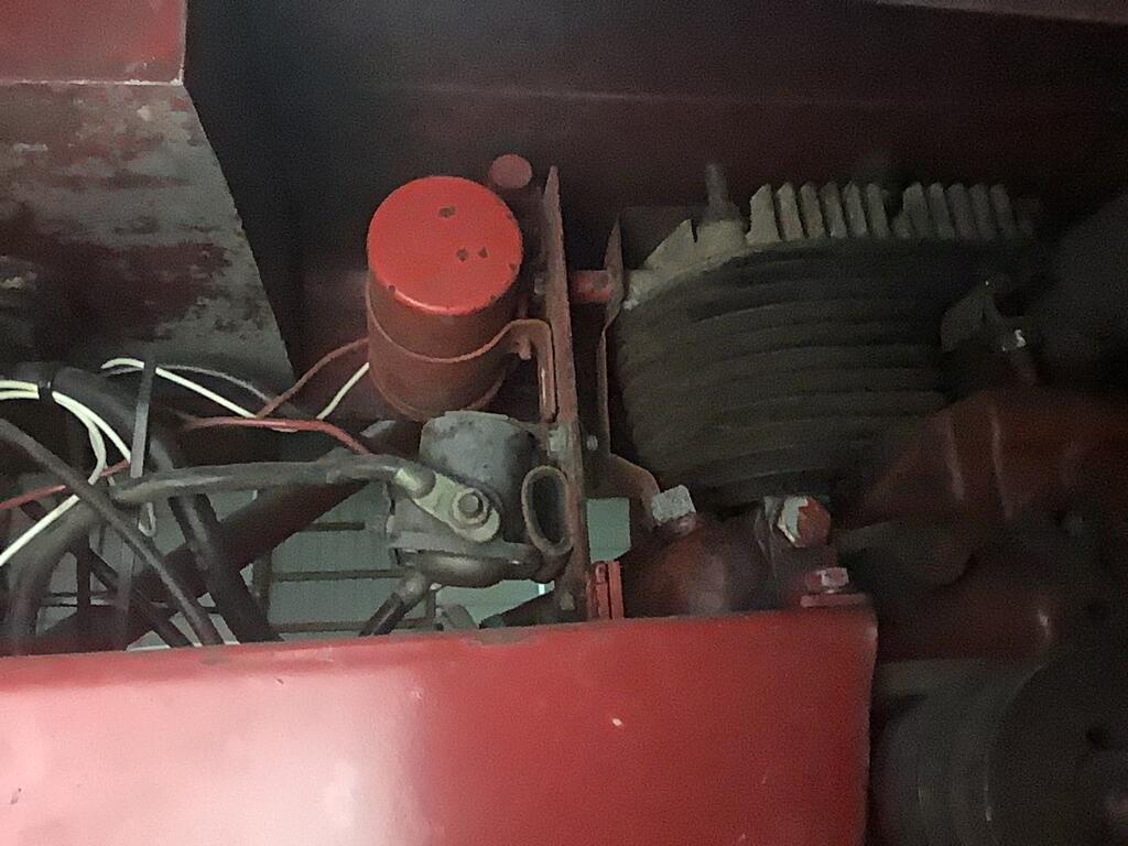

Pullstart 71,004 #1 Posted July 6, 2022 So I’ve had Poppy the 552 on the charger for a day and while I was testing for fire I walked away with the coil powered up. This is a 552 (just a little customized) with a C-81 starter/charging system and a simple on/off switch for the coil and a push button for the starter. Before I tear into troubleshooting… 1) Think I fried the coil? 2) Think I zapped the points? 3) Think I’m totally wrong? 1 1 Share this post Link to post Share on other sites
WHX?? 57,643 #2 Posted July 6, 2022 1 minute ago, Pullstart said: I walked away with the coil powered up. Been ther done that.... if the points were open should be ok. Otherwise try just dollar billing the points or swapping out the coil. 4 Share this post Link to post Share on other sites
cafoose 3,785 #3 Posted July 6, 2022 Is that a lighted toggle that lights up when in the on position? If not, I recommend using one so you can tell at a glance if the coil is powered on 2 1 Share this post Link to post Share on other sites
Pullstart 71,004 #4 Posted July 6, 2022 2 minutes ago, WHX?? said: Been ther done that.... if the points were open should be ok. Otherwise try just dollar billing the points or swapping out the coil. That’s my plan of attack for troubleshooting for the time being 1 minute ago, cafoose said: Is that a lighted toggle that lights up when in the on position? If not, I recommend using one so you can tell at a glance if the coil is powered on not a bad idea Chuck! Currently it is not lit, but not very often do I attempt to start it without running it (and shutting it off) 1 1 Share this post Link to post Share on other sites

Achto 32,253 #10 Posted July 6, 2022 If the coil was not hot to the touch when you noticed the issue, then chances are that the points were open and zero damage occurred. if the coil was hot to the touch then it may be fried as well as the points. 4 Share this post Link to post Share on other sites
Pullstart 71,004 #11 Posted July 6, 2022 1 minute ago, Achto said: If the coil was not hot to the touch when you noticed the issue, then chances are that the points were open and zero damage occurred. if the coil was hot to the touch then it may be fried as well as the points. I didn’t think to check the temp of anything when I did it the other day… but if I dollar bill the points I have spark for about three revolutions then it peters out. Clean ‘em again, it sparks a few times. Let it rest the same amount, still no spark. Tells me the points are burnt and the coil is just fine.. 🤞 3 Share this post Link to post Share on other sites
Achto 32,253 #12 Posted July 6, 2022 1 minute ago, Pullstart said: but if I dollar bill the points I have spark for about three revolutions then it peters out. You might need to get a little more aggressive cleaning. Try running some 400 to 600 grit paper through the points, then dollar bill them. 4 Share this post Link to post Share on other sites

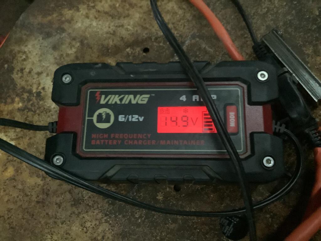

Pullstart 71,004 #15 Posted July 6, 2022 I filed the points and pulled one out of @953 nut’s playbook (swapped out the weak battery for a known good one) and we have fire! 5 5 1 Share this post Link to post Share on other sites
squonk 47,741 #16 Posted July 6, 2022 You mean you didn't check battery voltage first? 13 Share this post Link to post Share on other sites
Pullstart 71,004 #17 Posted July 6, 2022 (edited) 2 minutes ago, squonk said: You mean you didn't check battery voltage first? I did (it had over 12volta) but noticed a pretty steep voltage drop when cranking. Edited July 6, 2022 by Pullstart 3 Share this post Link to post Share on other sites
