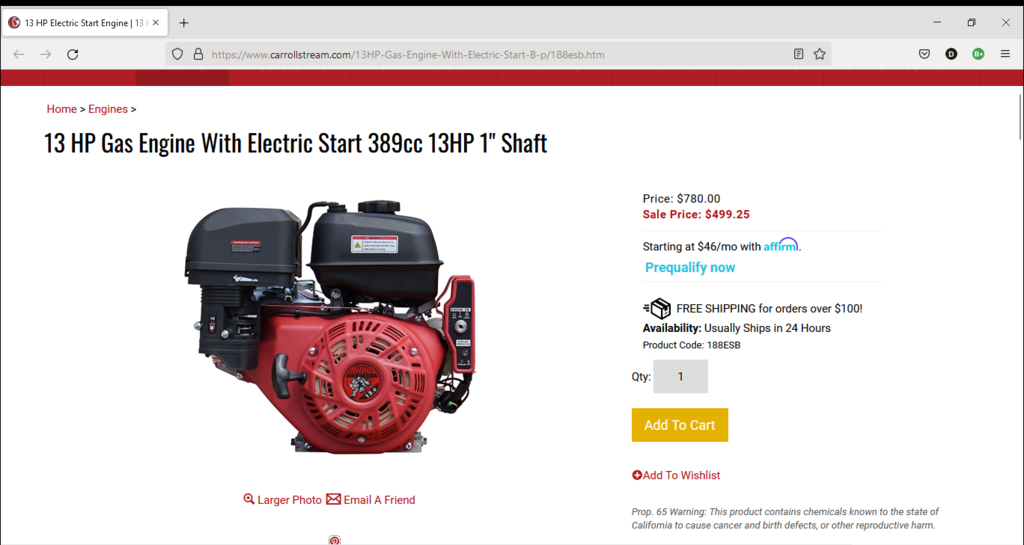

Snoopy11 5,731 #13 Posted July 6, 2022 Could always throw a Carroll Stream motor on it if worst comes to worst... and it would save time... effort... and money... and get a little power boost to boot! https://www.carrollstream.com/13HP-Gas-Engine-With-Electric-Start-B-p/188esb.htm Don 1 Share this post Link to post Share on other sites
