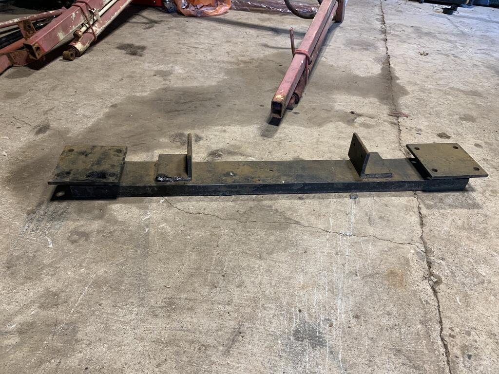

857lover 291 #1 Posted July 4, 2022 so i just picked up a quick way loader with everything for 300 bucks it came off of a bolens and i know nothing about loaders but i now am seeing that the subframe should attach at the atachamatic and this one bolted right to the frame on the bolens what should i do ?? i have a 416-8 with a onnan 1 Share this post Link to post Share on other sites

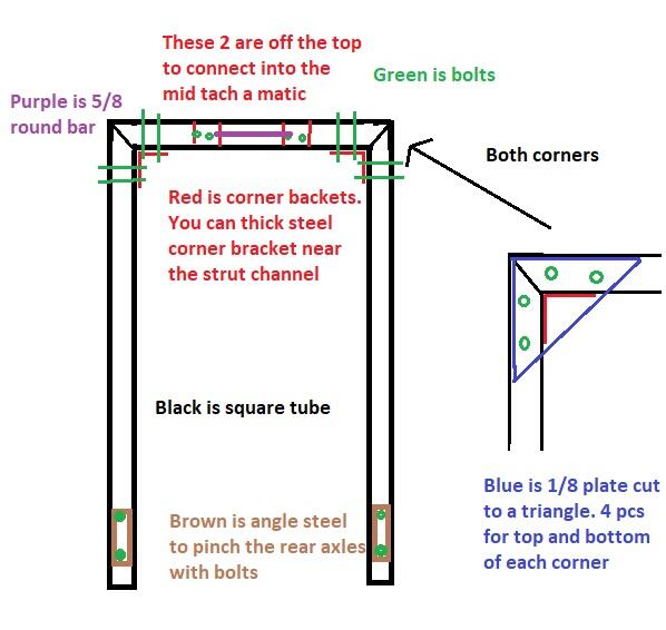

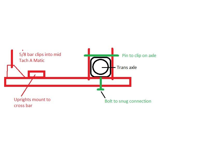

wallfish 20,510 #12 Posted July 5, 2022 3 hours ago, 857lover said: wow i do not have a welder unfortunately This can be done by drilling and bolting some parts together too. A good metal cutting saw will save time like a Pota-band saw but it's not completely necessary. If you need help with some ideas or some how to stuff just us know. I can make another drawing. Basically use 1 1/2" or 2" square tube and some 2" angle steel. Maybe some 1/8" plate steel to make gussets and corners for bolting pieces together. Shouldn't be too expensive to find a local welder to fab one up for you. Use the money you saved by buying a $300 loader! LoL 3 Share this post Link to post Share on other sites

wallfish 20,510 #16 Posted July 5, 2022 (edited) Basically a U shape with 1 1/2" or 2" square tube. You will have to take the measurements for what you need and building it. The U length needs to go minimum from the mid tach a matic to the rear axle. I suggest running them long so you can add a weight box on the rear of the tractor. The width needs to be just wide enough to clamp to the rear axles of the trans. Once you get this far and post some progress as you go we can work on modifications, add ons and the front attachment point. I'm figuring if you can get this far you deserve all the help to continue but I don't want to waste a bunch of time spelling everything out for you to just not do it or have a shop build something for you. Edited July 5, 2022 by wallfish 1 1 1 Share this post Link to post Share on other sites
wallfish 20,510 #17 Posted July 5, 2022 (edited) This brace might work for the corners and possibly skip the 1/8 plate https://www.amazon.com/Genuine-Unistrut-P2484-EG-Gusseted-Connector/dp/B0195UGD38/ref=sr_1_10?adgrpid=1332609599482466&hvadid=83288325852194&hvbmt=be&hvdev=c&hvlocphy=103037&hvnetw=o&hvqmt=e&hvtargid=kwd-83289060397227%3Aloc-190&hydadcr=8925_13537810&keywords=unistrut+support+bracket&qid=1657061843&sr=8-10 Here's what the corner brackets are that I referred to https://www.amazon.com/Genuine-Unistrut-P1325-EG-Connector-Bracket/dp/B00HZT18LO/ref=sr_1_14?adgrpid=1332609599482466&hvadid=83288325852194&hvbmt=be&hvdev=c&hvlocphy=103037&hvnetw=o&hvqmt=e&hvtargid=kwd-83289060397227%3Aloc-190&hydadcr=8925_13537810&keywords=unistrut+support+bracket&qid=1657061950&sr=8-14 Lots of uni strut brackets and parts can be used for building stuff with bolts and I even use them for welding stuff and braces etc Just search uni strut brackets. They come with 1/2" or 3/8" holes. I would NOT use any bolts smaller than 3/8" Edited July 13, 2022 by wallfish 2 Share this post Link to post Share on other sites
857lover 291 #18 Posted July 6, 2022 (edited) 23 hours ago, wallfish said: so i see how this attaches to the transmission but how does it attach the the front and where do i put my towers on each side ? Edited July 6, 2022 by 857lover Share this post Link to post Share on other sites
953 nut 68,481 #19 Posted July 6, 2022 If you plan to use the Mid Mount Tach A Matic you would attach the front to that with the 5/8" rod as @wallfish has shown. Actually I think that would be 3/4". The towers would be located about even with the steering tower or a bit further forward. Share this post Link to post Share on other sites
wallfish 20,510 #20 Posted July 6, 2022 43 minutes ago, 857lover said: where do i put my towers on each side Bolt the cross bar you already have to this frame! Read the red writing on top of the drawing for the place to mount the front. Mid tach a matic. Where the mower deck would connect to. The tach a matic is just an easy place to do it but you can bolt it directly to the frame too. 2 Share this post Link to post Share on other sites
857lover 291 #21 Posted July 7, 2022 22 hours ago, wallfish said: Bolt the cross bar you already have to this frame! Read the red writing on top of the drawing for the place to mount the front. Mid tach a matic. Where the mower deck would connect to. The tach a matic is just an easy place to do it but you can bolt it directly to the frame too. so i can use the bolts to the frame and then use the one around the transmission Share this post Link to post Share on other sites
wallfish 20,510 #22 Posted July 7, 2022 2 hours ago, 857lover said: so i can use the bolts to the frame and then use the one around the transmission Not the ones on your cross frame. New ones from the new sub-frame you need to build instead of connecting into the tach a matic. The tach a matic is just bolted to the tractor frame too so use that or make new brackets to bolt to the frame instead. You need to build a strong ass sub-frame for the loader so it doesn't bend up your tractor. Short cut on that step and the hydraulics will probably bend the tractor frame. Do NOT just look for the "easy way" to do it for this application!!!!!! Do you have the tools (saw, drill, tape measure and drill bits) and ability to build that simple U shape frame I did the drawing for? You need to be able to cut and drill steel and you can do it with bolts. Welding is better but you said you don't have one so I'm trying to help you. 1 1 Share this post Link to post Share on other sites

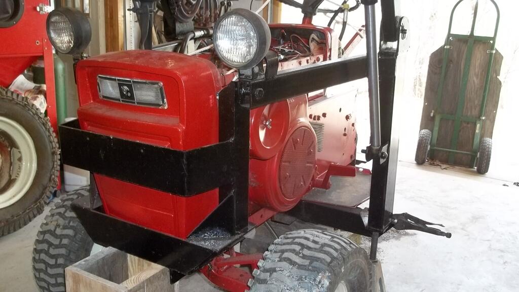

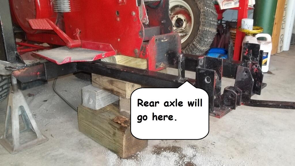

Thor27 892 #23 Posted July 8, 2022 Not a quick way, but same principle. Here are a few pics I took when building mine for an ARK. I tried to mimic the original as much as possible, I use the original front subframe, as well as the front hanger on this subframe. I used a disassembled tractor to mock it up and tac weld it together. If you want to take up welding, It would be a good project to learn on. Any questions just ask. I can get some measurements if helpful. Build the frame first, stick it in place and tac on the axle saddles, slide in the cross member and assemble the loader where it wants to sit, tack on the crossmember, remove and final weld. I plan to pull mine off for some tractor maintenance, when I do I will cut off the rear behind the axle so I can access the rear hitch pin and use a sleeve hitch again. I use a bolt instead of a pin above the axle, so there is a nut welded to the front uprights. Makes it easier to install with the wheels on. Don't see it here but there is a a 1/2" nut welded to the sadle for a tension bolt from underneath. I had set up a weight box to go in the receiver hitch, but it is a huge pita. I use loaded tires and inner outer weights instead as the weight box gets in the way and hangs up on stuff, but it would be nice to have the option, especially when you lift weight in front of the bucket.. I plan to make the box so I can lift it with the sleeve hitch so I can drop it on wheeled cart (think a steel furniture dolly) and roll it out of the way with out having to empty it. 1 1 Share this post Link to post Share on other sites
