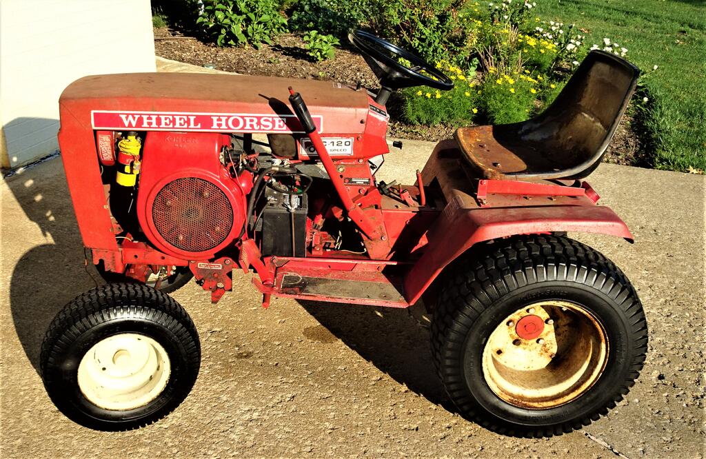

giddyap 1,574 #5 Posted July 9, 2022 (edited) I have money to burn, said I and so here it is. @slim67 It will be "It's my thing #6" in a future post but first. I measured 1-1/8 axle and a 314-8 has a 1 inch axle. I would have thought they were the same diameter. Is this correct? Also I knew it did not run, is it because the wire is gone from the rectifier? I'm thinking about replacing the engine with a Magnum 12 Edited July 9, 2022 by giddyap added member 1 Share this post Link to post Share on other sites
wallfish 20,219 #6 Posted July 9, 2022 1 hour ago, giddyap said: I would have thought they were the same diameter. Is this correct? Nope. Some with 1" like a 314 or a B80 and some with 1 1/8 axles like the 400 series or that C120 1 hour ago, giddyap said: Also I knew it did not run, is it because the wire is gone from the rectifier? No, The rectifier is only for the charging circuit and it should run with or without a regulator/rectifier 2 Share this post Link to post Share on other sites
Pullstart 70,682 #7 Posted July 9, 2022 Cool Jon! Like John said, I’d be inclined to get that K series going before swapping it out Share this post Link to post Share on other sites
giddyap 1,574 #8 Posted July 9, 2022 3 hours ago, wallfish said: it should run with or without a regulator/rectifier So much for the "easy fix". 2 hours ago, Pullstart said: Cool Jon! Like John said, I’d be inclined to get that K series going before swapping it out Yeah I must agree. Best described as a flat liner, I will give it a try and hope to have it running when I create a new post 1 Share this post Link to post Share on other sites
wallfish 20,219 #9 Posted July 9, 2022 3 hours ago, giddyap said: So much for the "easy fix". It still could be. Clean the points, make sure there's 12v to the + side of the coil with the key on, fire it up! 1 Share this post Link to post Share on other sites
