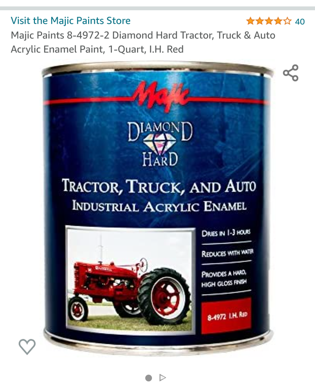

rmaynard 17,582 #1 Posted July 1, 2022 Since I didn't get any action on this post within the paint recommendation thread, I'll just start a new one. I have disparaged Majic paint in the past (rattle can and oil-based quarts), and I still stand by anything that I said. However, I was looking at industrial water-borne acrylic enamels today. I was looking for something that I can teach a 13 year old to apply with an HVLP sprayer. Water-borne because it's safer than oil with hardeners or acrylic urethanes with activators, and it's water clean-up. I know that the EPA will be requiring all body shops to switch over to water-borne in the near future. So I came across this. It's water-borne, and the safety data sheet reads pretty well. Reviews that I've seen have been mixed. Anyone have any experience with this particular paint? 3 Share this post Link to post Share on other sites

JoeM 10,289 #4 Posted July 1, 2022 I looked at it too. Somewhat sceptical, but was the same when the water urethanes came out. They seem to work good. Intrigued by the 1-3 hour dry time. Jump in there and let us know. 1 2 Share this post Link to post Share on other sites

rmaynard 17,582 #6 Posted July 2, 2022 3 hours ago, JoeM said: I looked at it too. Somewhat sceptical, but was the same when the water urethanes came out. They seem to work good. Intrigued by the 1-3 hour dry time. Jump in there and let us know. Got a can today. Haven't had a chance to do anything yet. More to follow. 4 1 Share this post Link to post Share on other sites

adsm08 5,149 #9 Posted July 2, 2022 (edited) @rmaynardThis is the exact stuff I used on the Speedex. I bought three quarts, one primer, one red, one yellow. My feelings on it are mixed. The red I was able to pour right out of the can into the gun and spray with only stirring it up a bit for consistency. The primer was badly separated and required a lot of mixing to get it to a usable state, and I had to do this every time I used it. The yellow. The yellow was bad. The instructions for the paint say to mix it no more than 10% water to thin as needed. To get the yellow to a viscosity that would go through a gun I had to mix it nearly two parts water to one part paint. It came out of the can like frozen molasses. I have had some issues with it coming off easily, but mostly in areas where the metal was greased and I couldn't clean it well enough because after 50-odd years the stuff was just so soaked in to the metal. I also cut through it to bare metal quickly when trying to sand out imperfections, but that may have been a film-thickness issue, which is user error, rather than an actual problem with the paint. It does clean up easily. While it looks good on the tractor, I don't think it will ever produce the mirror finish that I saw on some of the stuff at the big show. I can't say how well it will hold up long term, since it hasn't been on very long, but I was using it to teach my boy to spray, and for that it is good, if you get a can that is well mixed and not too thick. Edited July 2, 2022 by adsm08 4 1 Share this post Link to post Share on other sites

adsm08 5,149 #11 Posted July 2, 2022 19 hours ago, JoeM said: I looked at it too. Somewhat sceptical, but was the same when the water urethanes came out. They seem to work good. Intrigued by the 1-3 hour dry time. Jump in there and let us know. Dry time is dependent on temp and humidity. It does dry fast. I was painting with it through most of May and early June. Most parts were dry enough to handle gently in under 30 minutes, but my hood has a few finger prints in it where I wasn't gentle enough. In an hour it will genuinely be dry. It takes longer to fully cure. The other thing I noticed was that if you keep a respectable distance and don't get too close it was really hard to put runs in the paint. 3 Share this post Link to post Share on other sites

rmaynard 17,582 #14 Posted July 3, 2022 21 hours ago, adsm08 said: While it looks good on the tractor, I don't think it will ever produce the mirror finish that I saw on some of the stuff at the big show. I'm not expecting miracles, just a decent finish. Thanks for your input. 1 Share this post Link to post Share on other sites

rmaynard 17,582 #20 Posted April 20, 2024 Seems a lot of water has gone under the bridge since I started this thread. Never got around to trying the paint until today. And... I opened the previously unopened can that I bought back in 2022 and it was as hard as a rock. Not a good start. More to follow 1 Share this post Link to post Share on other sites
