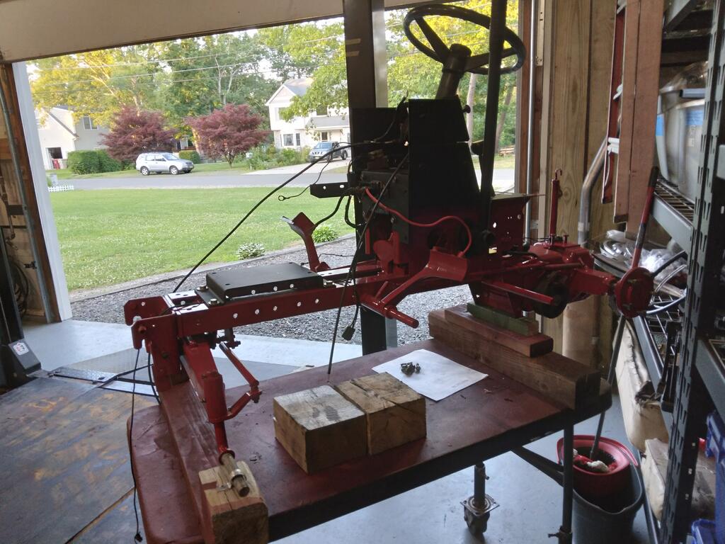

matt monte 232 #1 Posted June 25, 2022 can somebody please help. Im restoring a 308-8. its actually coming out rather well. Anyway it never had PTO linkage. The parts tractor did. i was at a loss on how to install it in freshly painted chassis. I finally bent side panel in parts one to remove. I just got done installing wiring harness, assuming all of this needs to come apart? Share this post Link to post Share on other sites

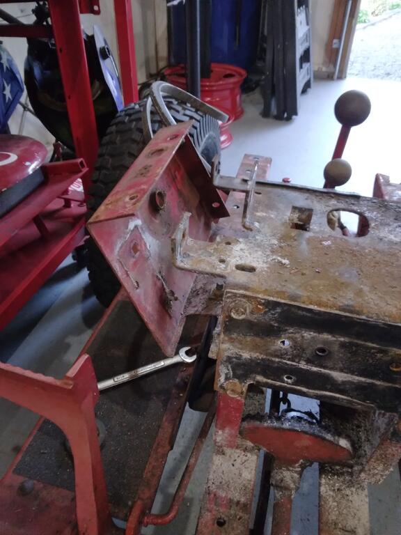

matt monte 232 #3 Posted June 25, 2022 thanks for responding. if u zoom in, its welded. i can see how a previous owner did this Share this post Link to post Share on other sites
matt monte 232 #4 Posted June 25, 2022 there is no way in hell im bending up that side panel to muscle it into new chassis the way i ham fisted it out of parts tractor Share this post Link to post Share on other sites

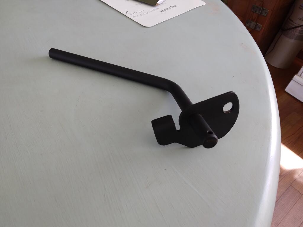

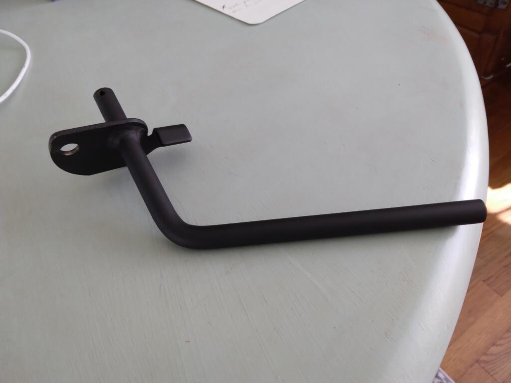

matt monte 232 #6 Posted June 25, 2022 i just re read my post. to clarify: not seeing how the PTO clutch lever gets installed without bending side plate to wedge it in, the rest of linkage bars to engine i can figure out Share this post Link to post Share on other sites

Thor27 892 #9 Posted June 27, 2022 Matt, just have to remove the horizontal shelf that bolts to the sides with 2 carriage bolts. You had them removed out of one side... Share this post Link to post Share on other sites
matt monte 232 #10 Posted June 27, 2022 thanks, took me a while to figure out that comes out. all buttoned up, got linkage bar in place. had to remove a bunch of stuff i had just installed. Was not very happy. Ill post pics when im finished Share this post Link to post Share on other sites
