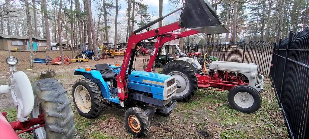

pacer 3,180 #1 Posted June 22, 2022 Well, to start off ... as some of you remember I recently made a post about installing an EPAS (electric power assist system) on a Mitsubishi. So, I had hardly finished that ... lengthy? project when I ran across another Mitsu that I just couldnt pass up (lost my power steer with the deal) OK, the 'new' Mitsu (MTE2000) has a brand new Mahindra FEL installed and it is a thing of wonder ... FAST!! --- but, for some reason when moving ANY cylinder - raise/lower/dump/curl/etc to its limit the motor DIES! Will start right back up and function normally unless I again run the cyl back to its limit. Now, the only way it can kill the engine is to cut off fuel - right? No lectrics involved with a diesel once running.... So.... what is/can be doing this? When the guy installed the new lift did he leave something off/on? maybe? Its a rather minor problem, but can be irritating like when I'm getting a bucket of dirt and go to curl the bucket to settle the load in --- the motor dies! I'm pretty lacking in having any Hyd skills This is the Mitsubishi with loader as it sat in the lot I got it from. 1 1 Share this post Link to post Share on other sites
