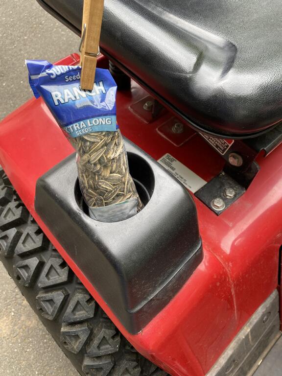

Sparky-(Admin) 26,322 #3 Posted June 22, 2022 Not a fan of Ag tires, but I love these! Carlisle All Trails. Get your self a pair of these and some wheel weights (and eat more snacks while mowing ). 7 1 1 Share this post Link to post Share on other sites

Esbrian 16 #5 Posted June 22, 2022 Just now, Sparky said: Not a fan of Ag tires, but I love these! Carlisle All Trails. Get your self a pair of these and some wheel weights (and eat more snacks while mowing ). Dont think the sunflower seeds will cut it. I'm leaning towards malt for the big gains. 1 1 4 Share this post Link to post Share on other sites
Esbrian 16 #6 Posted June 22, 2022 Those tires are gnarly! Share this post Link to post Share on other sites
