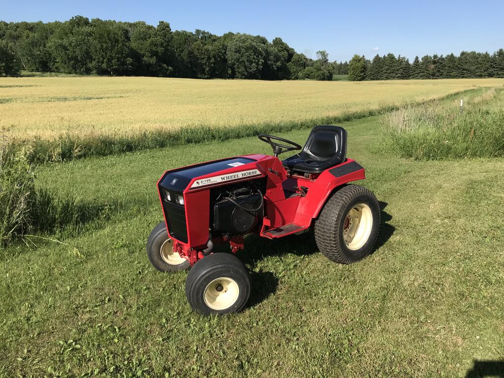

PeacemakerJack 10,743 #1 Posted June 21, 2022 For those of you who have known me for awhile, I have owned a Super C that I named Vader for about 6 years now. My plan was to do a full restoration on it and keep it as a show queen. WEEEEELLLLLL…life happens! I was a building contractor for 20 years but now I’m in full time ministry working with my dad to assume directorship of the ministry he started in 1979. That being said, I don’t have the same time for the tractor hobby that I did a few years ago. However, it will always have a special place in my heart and more-so YOU GUYS! I cherish the friendships that I’ve made through this forum and I know that I need to check in more often than I do. ANYWAY…I’m going to be thinning my herd a little bit over the next year but am still keeping special tractors. I was planning to sell the super C until Judge (my third born) reminded me the other day that I promised him a hydrostatic, law-mowing, work tractor. 🤨🤨🤨 (he has a dedicated plow mule). Is the Super C a good platform for that application. I don’t have a deck for it…wondering who has run a deck on theirs and how they like it. @Skipper has a total custom beast built out of his—please post that link, I’d like to review it. Can a 60” from a 520h be retrofitted to a Super C? Would that be a good deck for the application. Or would I be better with something else? a couple pictures of Judge on Vader from 2018. It isn’t a perfect tractor by any stretch but it wouldn’t take much to make a solid mowing machine for now with potential to fully “restore” someday should Judge choose… Thoughts appreciated! 1 8 1 Share this post Link to post Share on other sites

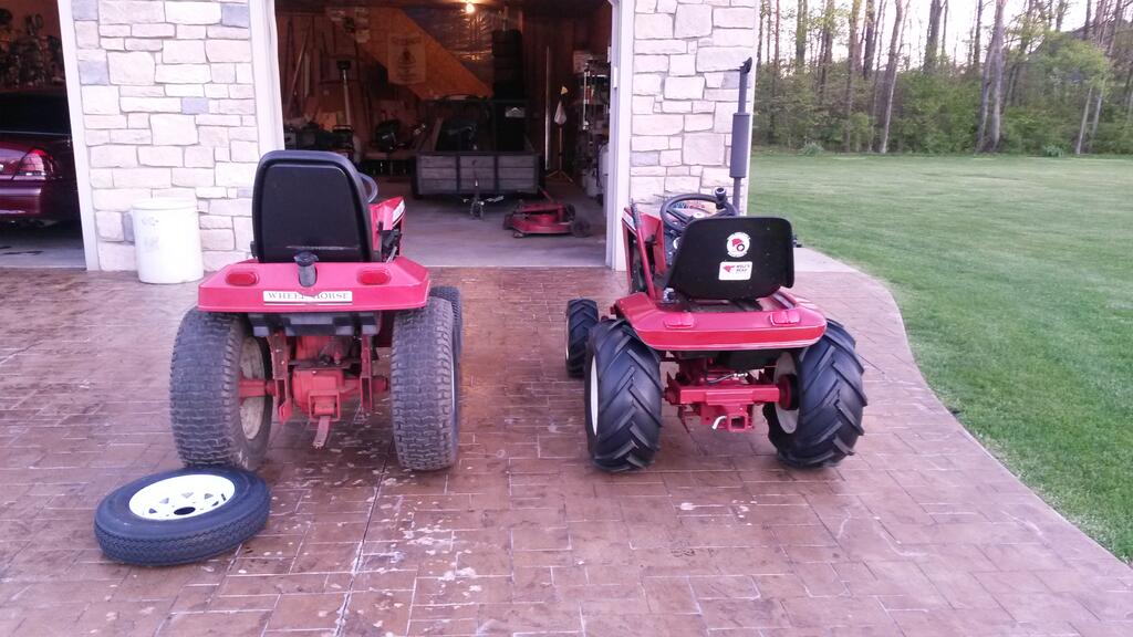

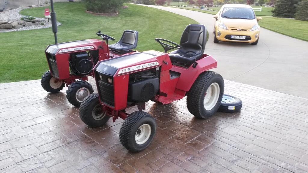

bds1984 1,466 #10 Posted June 22, 2022 The C195 is lengthened behind the foot rests and the fenders are raised substantially compared to the rest of the C/3/4/5 series. D-series are their own and not related to the rest of the herd in any form except for the name. Here is my Super-C I sold (regrettably) a few years ago parked next to my C165 that has the swept axle from a newer 520H. 4 1 Share this post Link to post Share on other sites
OutdoorEnvy 1,735 #11 Posted June 22, 2022 (edited) Looks like it's also a 6 bolt rear axle for the wheels? Is that a different trans than other C series? The D series has the 6 bolt/lug rear wheels as well Also is that a 15" rim on the C-195? Edited June 22, 2022 by OutdoorEnvy Share this post Link to post Share on other sites
bds1984 1,466 #12 Posted June 22, 2022 Yes, they're six bolt wheels. I've never had a D series to directly compare but at a quick glance n a photo, they look similar. The transmission is still an Eaton 1100 but the filter faces forward as it has a different remount mount than the C/3/4/5 series. I know that Super C attachments are different than its smaller siblings, but I don't see why one couldn't use them with minor modifications. I think lengthening the dozer blade frame and pivot handle will work out, but mower decks, not sure, but given how many things interchange, I could see a 48"-42" decks swapping right in with the correct mule drive and belts. The 60" deck on mine cut okay, my 48" on my C165 cuts much better, especially over terrain that is anything but smooth. I've heard the 60" deck on the C195s is an Ariens design and is MUCH lighter than the 60" deck found on the 520s. I was able to pick up the C195s deck by myself and move it around fairly easily. Perhaps the C195's 60" deck with some extra gauge wheels will yield you a much better cut; I believe mine had 5 on it whereas my 48" has 8. I sold mine to someone who wanted it much more than me but if it had been a Series II powered machine, I'd still have her. 1 1 Share this post Link to post Share on other sites
