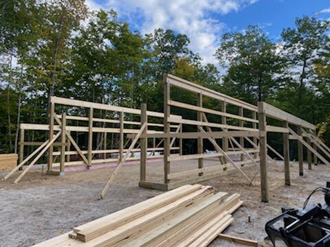

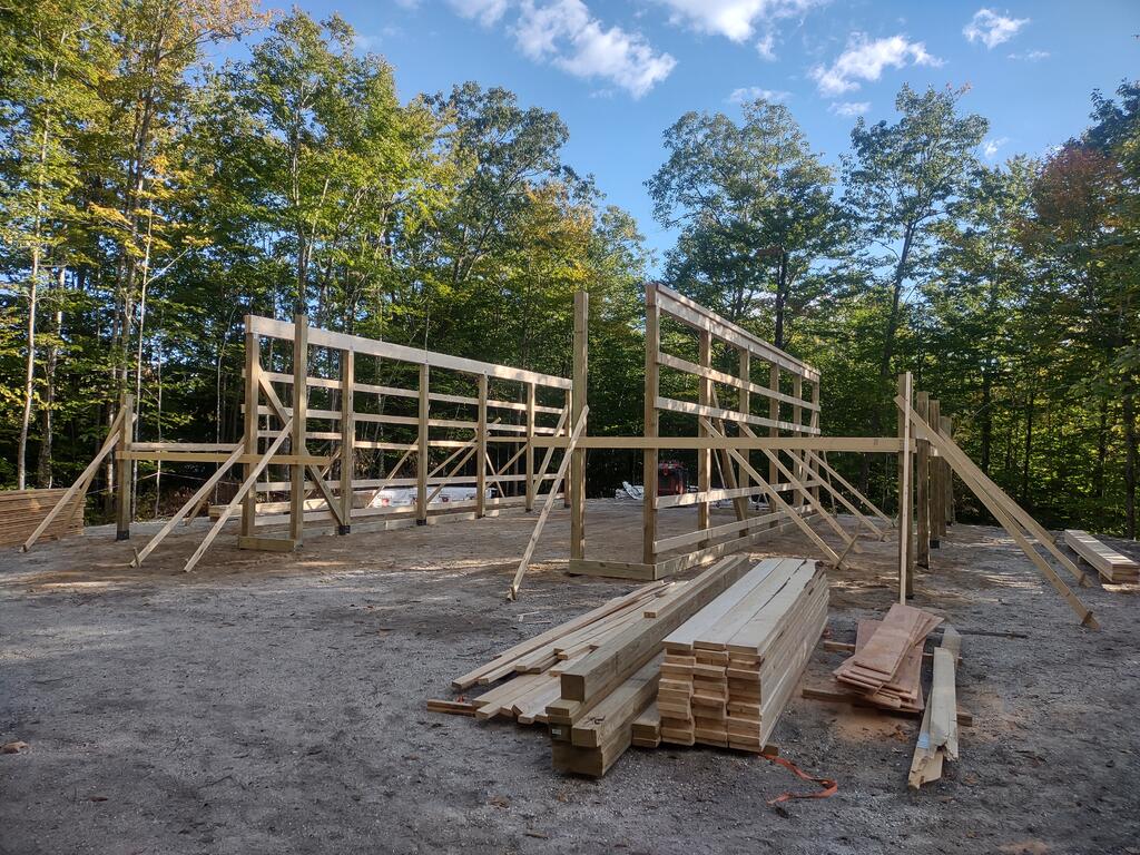

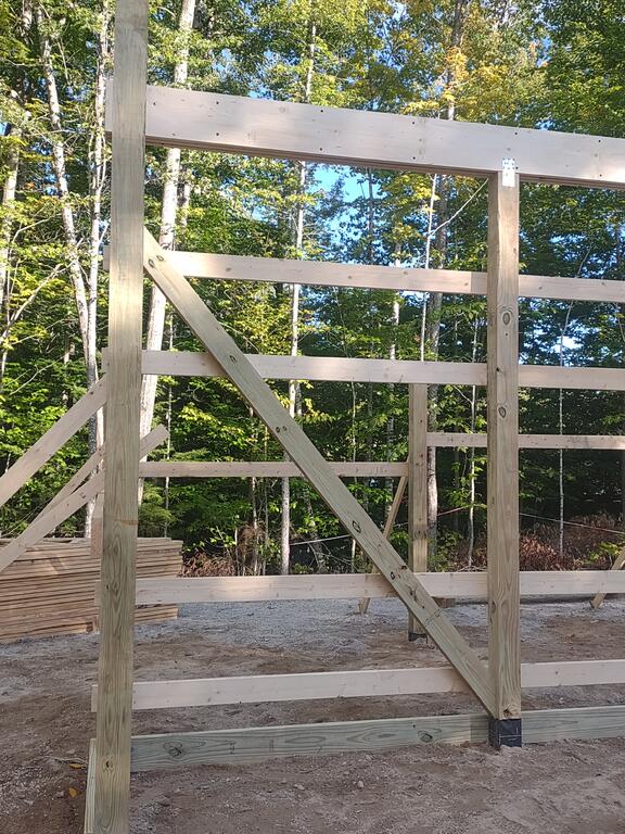

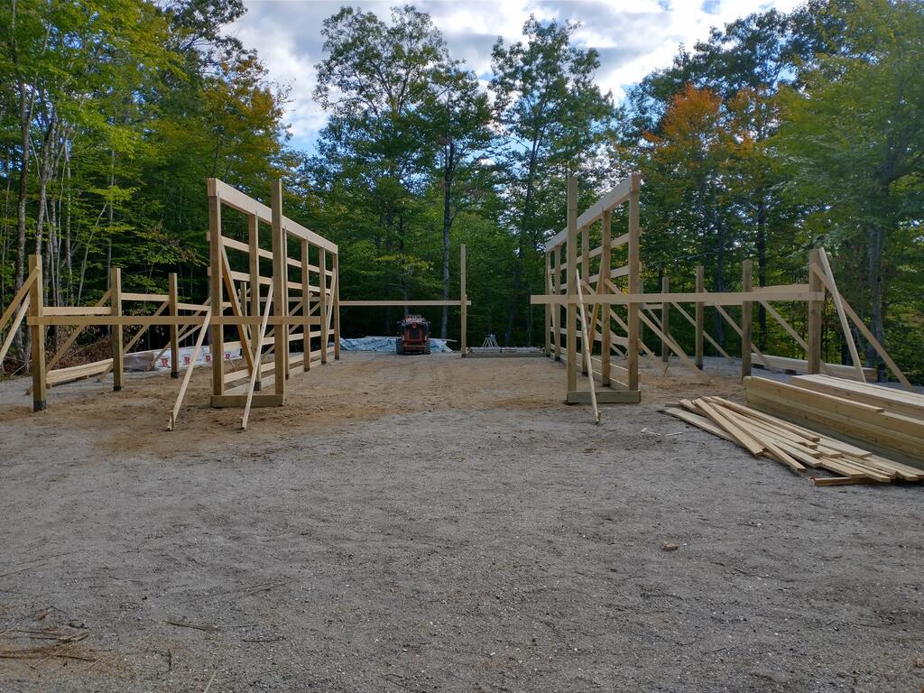

ebinmaine 81,183 #182 Posted September 27, 2022 Today's work was getting the tops of the interior walls built then all the walls at plumb every direction. More bracing both temporary and permanent was installed. The floor was partially compacted too. There's 4 of these PT diagonal braces to prevent racking. 2 1 Share this post Link to post Share on other sites
Jeff-C175 7,211 #183 Posted September 27, 2022 7 minutes ago, ebinmaine said: the tops of the interior walls built This looks like it was 'site built' and not a 'glue lam' ? Looks like three pieces of 1X with plywood between. I'm used to seeing the same with two pieces of 2X and plywood. Is this also something to do with code up there in the frozen Nawt? 1 Share this post Link to post Share on other sites
ebinmaine 81,183 #184 Posted September 27, 2022 9 minutes ago, Jeff-C175 said: This looks like it was 'site built' and not a 'glue lam' ? Looks like three pieces of 1X with plywood between. I'm used to seeing the same with two pieces of 2X and plywood. You're correct in that it's site built. It's 3 pieces of 2 x 12 sandwiching 2 pieces of ½ plywood. Totals out to the same 5½ that the 6 x 6 PT is. Lots of builders use these up here. IMHO... Glue or laminated beams are the work of office basd architects that don't handle the material. MUCH less expensive than a glue beam. MUCH easier to handle because they can be built right in place instead of needing to hire extra hands or even a crane. In this particular case they fastened a piece or two of the plywood to the KD boards and hefted them into place. Then kept passing up whatever's needed. 3 Share this post Link to post Share on other sites
Rob J. 1,945 #185 Posted September 27, 2022 6 minutes ago, ebinmaine said: You're correct in that it's site built. It's 3 pieces of 2 x 12 sandwiching 2 pieces of ½ plywood. Totals out to the same 5½ that the 6 x 6 PT is. Lots of builders use these up here. IMHO... Glue or laminated beams are the work of office basd architects that don't handle the material. MUCH less expensive than a glue beam. MUCH easier to handle because they can be built right in place instead of needing to hire extra hands or even a crane. In this particular case they fastened a piece or two of the plywood to the KD boards and hefted them into place. Then kept passing up whatever's needed. Yeah that standard practice here in Michigan too. 1 Share this post Link to post Share on other sites
Jeff-C175 7,211 #186 Posted September 27, 2022 9 minutes ago, ebinmaine said: Totals out to the same 5½ that the 6 x 6 PT is. Ohhhhh.... yeah.... never mind! I saw 4x4 uprights! So yeah, now I get it. Site built is standard here also, but what threw me was that I saw 4x4. 1 Share this post Link to post Share on other sites
Jeff-C175 7,211 #187 Posted September 27, 2022 (edited) 15 minutes ago, ebinmaine said: Glue or laminated beams are the work of office basd architects Sometimes you need them though. I removed a load bearing wall and opened the rooms up. A pair of 2X12's would not have held the weight of the span. The only way we could do this was with a bigazz glue lam, and lemmee tellya, that suckah was HEAVY!!!! That was the last century, now they would probably spec a steel I-beam. Just as heavy (perhaps more) but also stronger. Edited September 27, 2022 by Jeff-C175 1 Share this post Link to post Share on other sites
lynnmor 9,073 #188 Posted September 27, 2022 3 hours ago, WHX?? said: No floor drain? I built my 1-1/2 story, 2 car garage/workshop just before the code Nazis took over. I put in a grease pit with a floor drain, Since I used it for business there was always the chance of an environmental inspection which would have caused the pit to be dug out, soil to be disposed of and then filled in. They call a floor drain like that an injection well around here. 1 Share this post Link to post Share on other sites
ebinmaine 81,183 #189 Posted September 27, 2022 49 minutes ago, Jeff-C175 said: . A pair of 2X12's would not have held the weight of the span. Oh heck no. These are meant to be supported every 8 to 10 feet. Wide span open area around here means a steel beam or storage trusses like we're using for the second floor. 1 Share this post Link to post Share on other sites

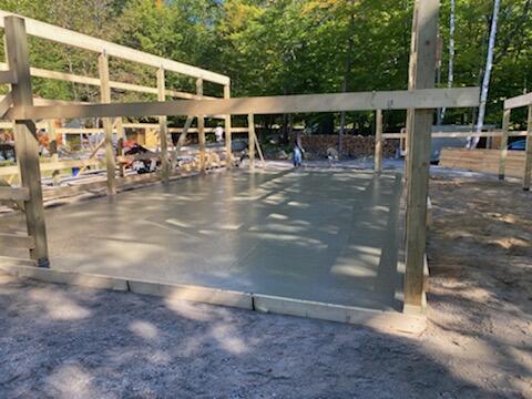

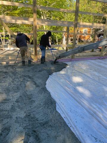

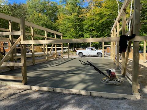

rjg854 13,427 #191 Posted September 28, 2022 23 hours ago, rjg854 said: Is the concrete only being used in the center section? @ebinmaine 1 Share this post Link to post Share on other sites
ebinmaine 81,183 #192 Posted September 28, 2022 18 minutes ago, rjg854 said: @ebinmaine Yessuh. The two outside sections under the shed roofs will remain gravel/stone for now. 1 Share this post Link to post Share on other sites

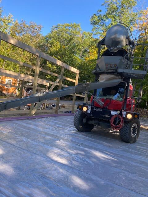

ebinmaine 81,183 #193 Posted September 29, 2022 On 9/28/2022 at 8:57 AM, rjg854 said: @ebinmaine And here you go... 5 3 Share this post Link to post Share on other sites
SylvanLakeWH 32,837 #194 Posted September 29, 2022 Wet concrete??? Where are your initials and the obligatory paw print??? logo??? 2 Share this post Link to post Share on other sites
Racinbob 13,286 #195 Posted September 29, 2022 I've been sitting in the shadows watching this thread. This is a well thought out build and there's been a lot of great ideas. 👍 2 Share this post Link to post Share on other sites
Handy Don 17,693 #196 Posted September 29, 2022 Those concrete guys make it look so easy. Well, been there and done that and it isn't. Looking good there, EB. 1 Share this post Link to post Share on other sites
ebinmaine 81,183 #197 Posted September 29, 2022 39 minutes ago, SylvanLakeWH said: Wet concrete??? Where are your initials and the obligatory paw print??? logo??? The BBT and I haven't made up our minds if we will sign it or not. We didn't do the work.. Wheel Horse logo is an interesting idea. 4 minutes ago, Handy Don said: Those CONCRETE GUYS make it look so easy. Well, been there and done that and it isn't. Looking good there, EB. The guys doing this job are "start to finish" builders. The owner of the company and select members of his crew are the ones that do the concrete work. 8 minutes ago, Racinbob said: I've been sitting in the shadows watching this thread. This is a well thought out build and there's been a lot of great ideas. 👍 Much appreciated Bob. I'd like to remind everybody that ever reads this sentence that Trina and I got most of the thoughts for this build from this very website and its members. 4 Share this post Link to post Share on other sites
