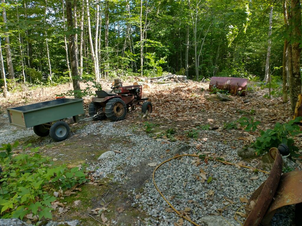

More trees felled and cut up today.
The area is really starting to open up!
Trina and her mom used the 867 Pigpen tractor to haul wood.  🪵 🪵 🪵

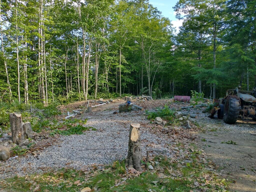

ebinmaine

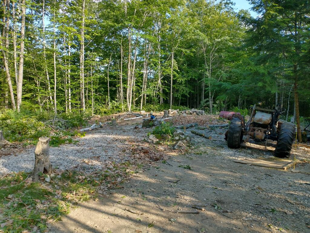

Here's where we're at after 3 days of forest clearing.
We've felled, limbed, sectioned and sorted a good strong 60 or 70 small to medium trees.
On the left and forward of the tractor pictured there are 5 or 6 small trees left. I'll knock those down as soon as the tractor is gone. Should be in the next couple days.
Tomorrow we need to mark the excavation lines and a "suggested NO zone". We'd like to stay a certain amount of distance away (12-15' ?) from the tree line on the left with heavy machinery if at all possible to maintain the health of the forest.
If you zoom in on the center of the picture you can see a pile of future firewood. There's a VERY sizable pile of logs and cut pieces to picture left, out of frame.
We'll have enough firewood for at LEAST 2 seasons after this.

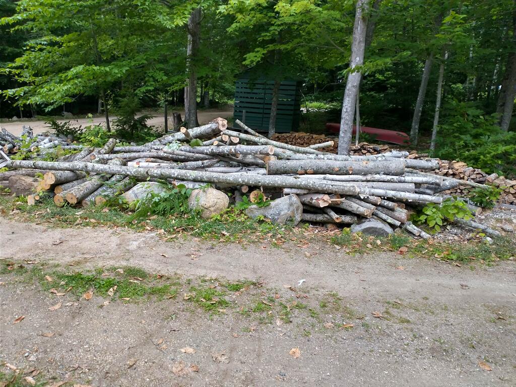

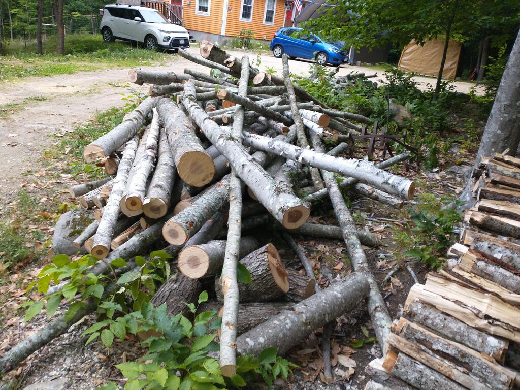

ebinmaine
Here's most of the pile of wood. Burnable stuff of course.
There was a fair amount of hemlock and quite a good many small saplings that we just threw off to the sides...
Left side
Right side
End view of the right side so you get an idea of the size of the pile
  • Like 2
  • Excellent 1
lynnmor
Most of that is a size that will be easy to work with, I have some similar size dead trees that need to be converted to firewood but they will be dropped in a jungle making it a project.
  • Like 1
ebinmaine
Agreed.
We've come to a point as far as firewood that we only process stuff that's larger in diameter than maybe a baseball. If we can't split it at least once it just goes through the chipper or into the brush pile which eventually will go through the chipper.
  • Like 1
  • Excellent 1

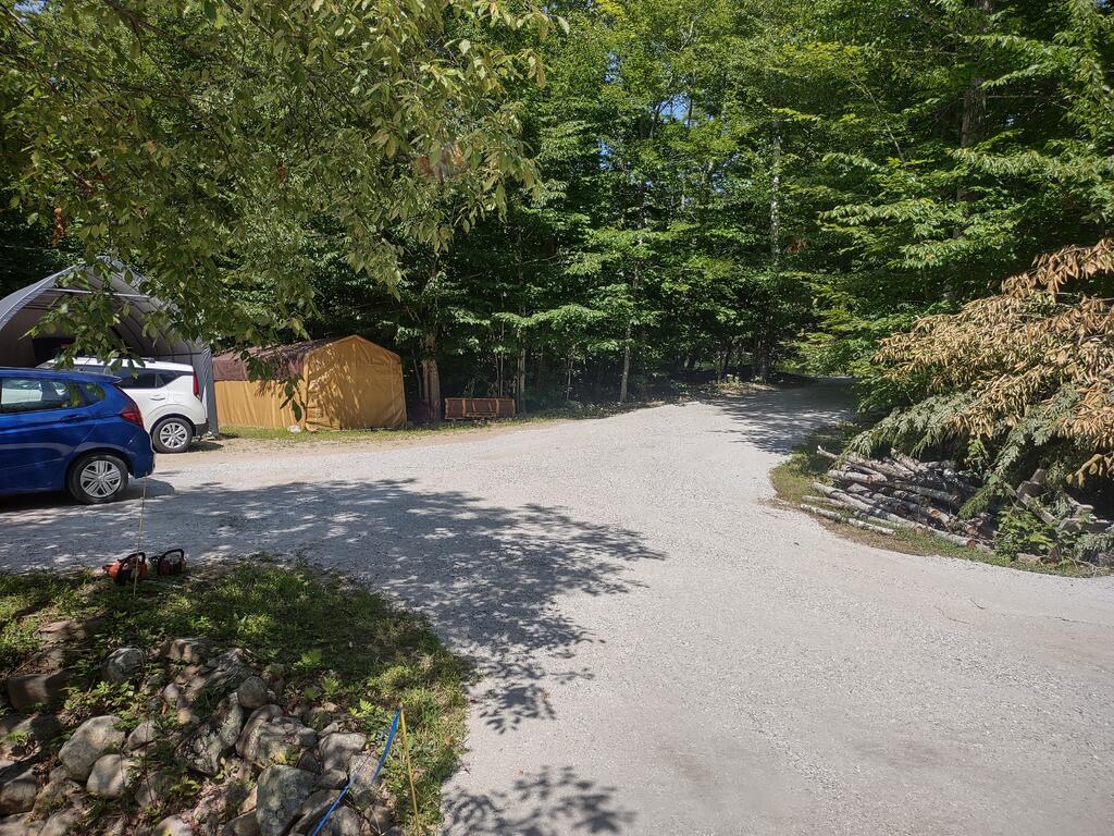

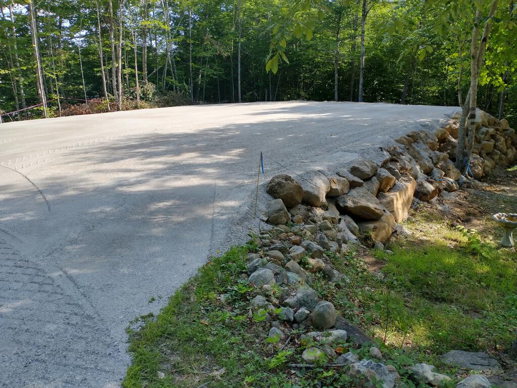

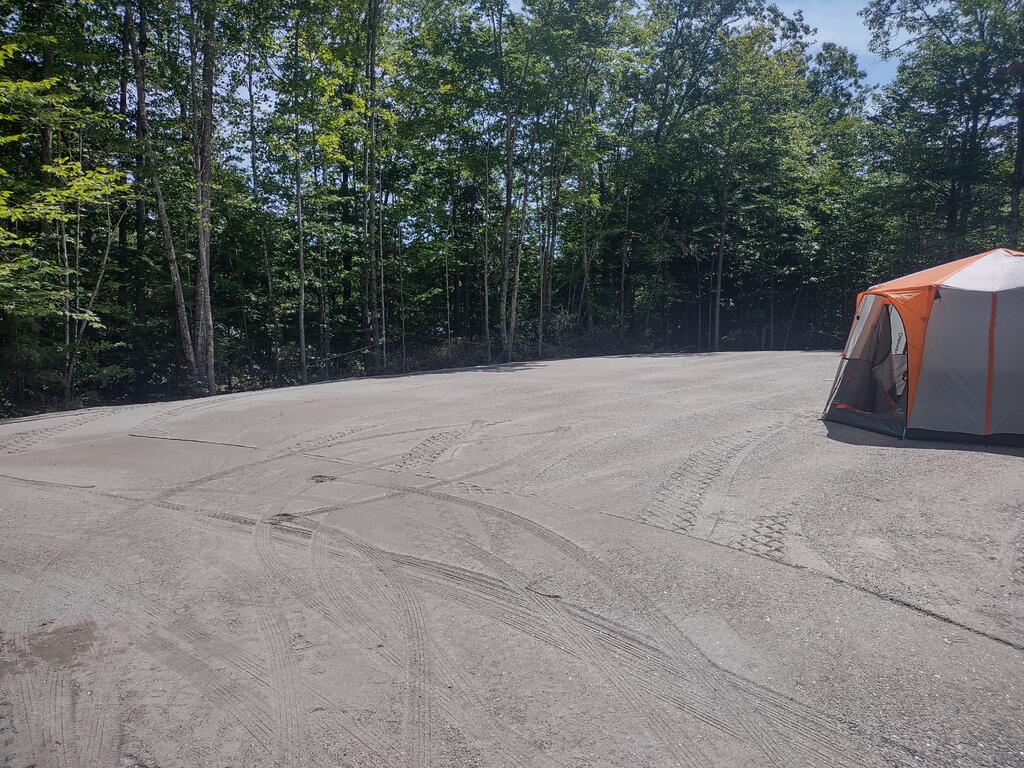

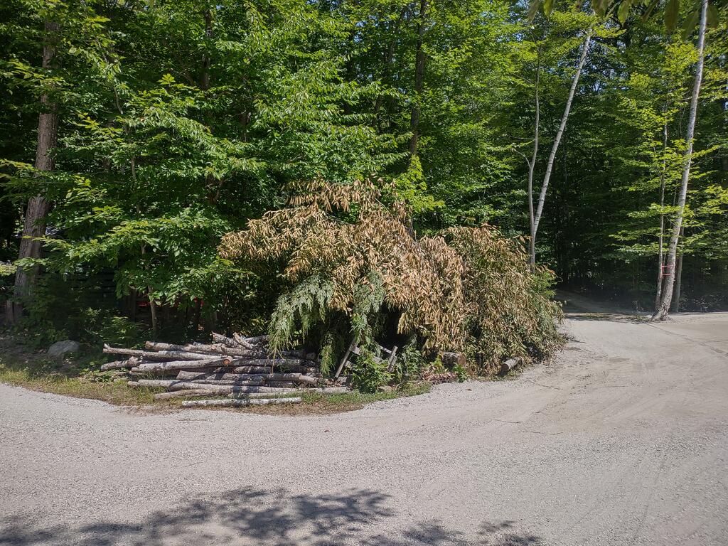

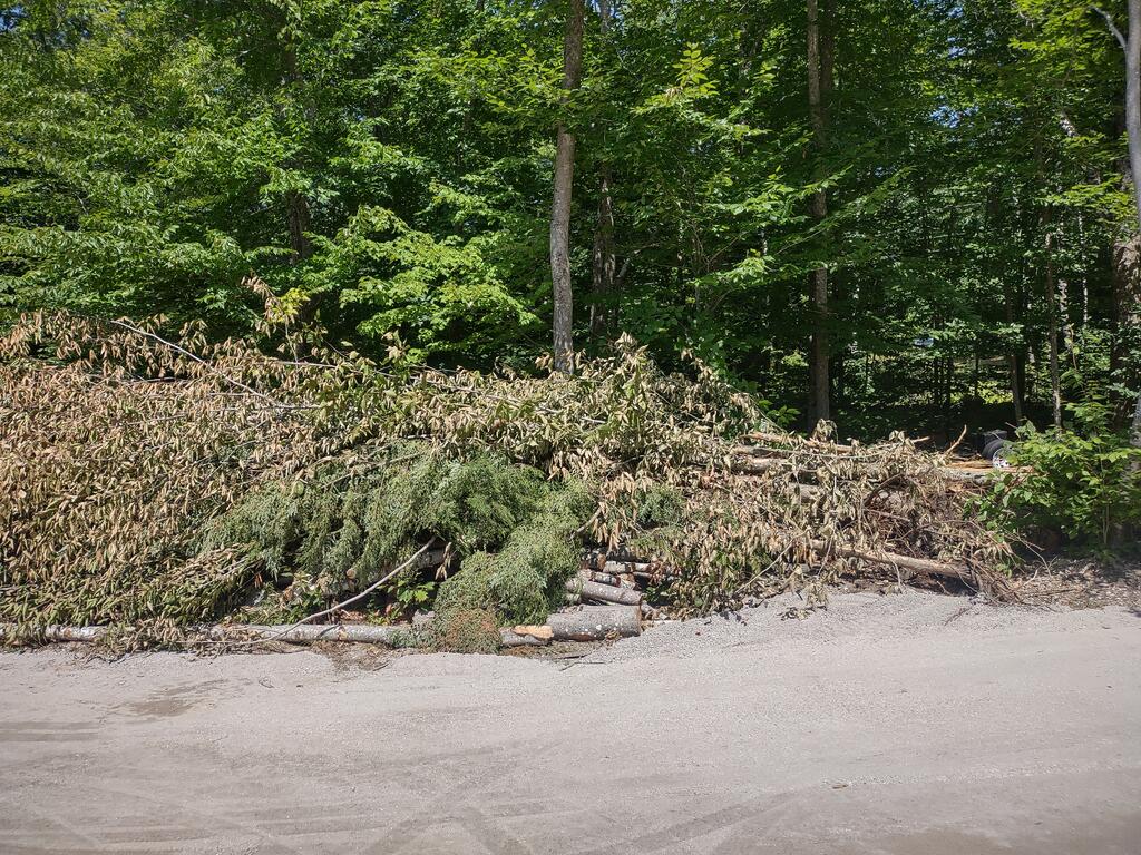

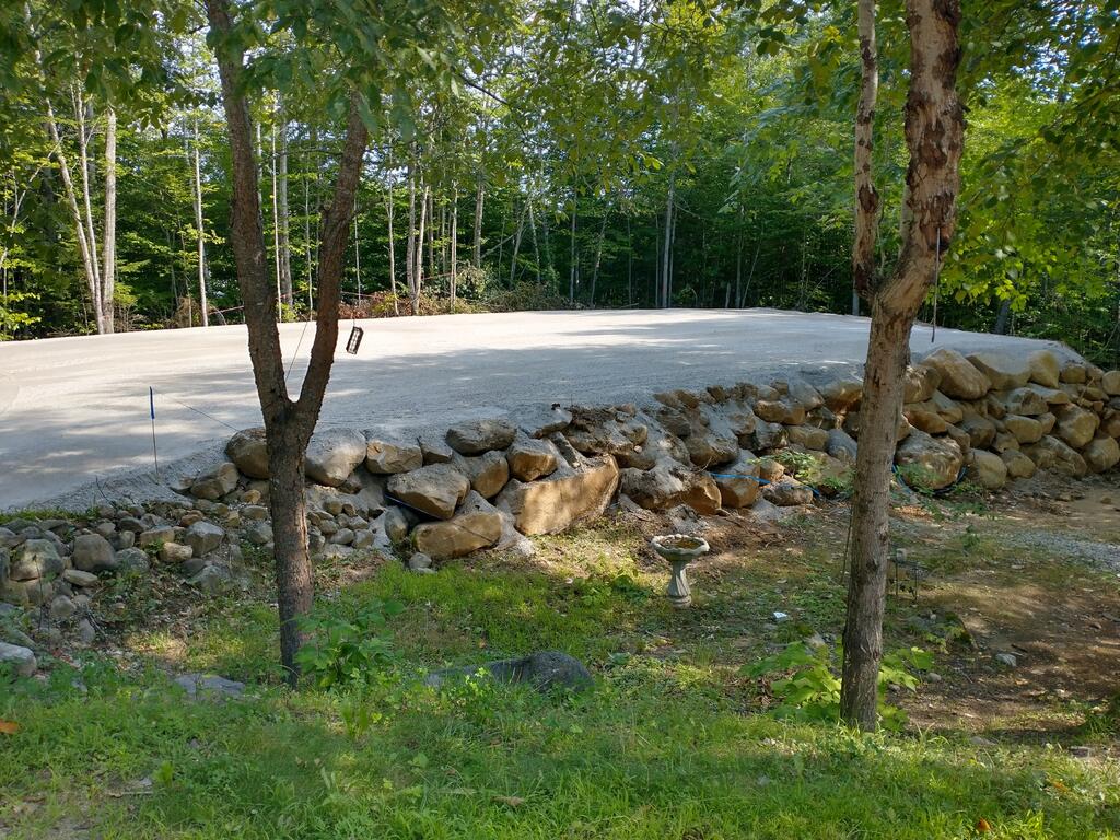

ebinmaine
This is the wood pile left by the excavator. Plenty of firewood 🪵 for next year.
We've been working on cutting in to the pile to get it sorted out.
Here's our new driveway the excavator guy did without me even asking. THAT'S customer service.
Some views of the new area.
This wall. Is AWESOME.
ALL the rocks came out of the excavated area.
Video as viewed from the base of the rock wall.
