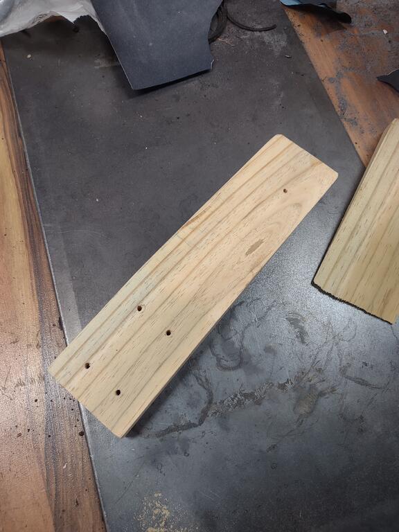

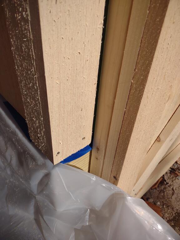

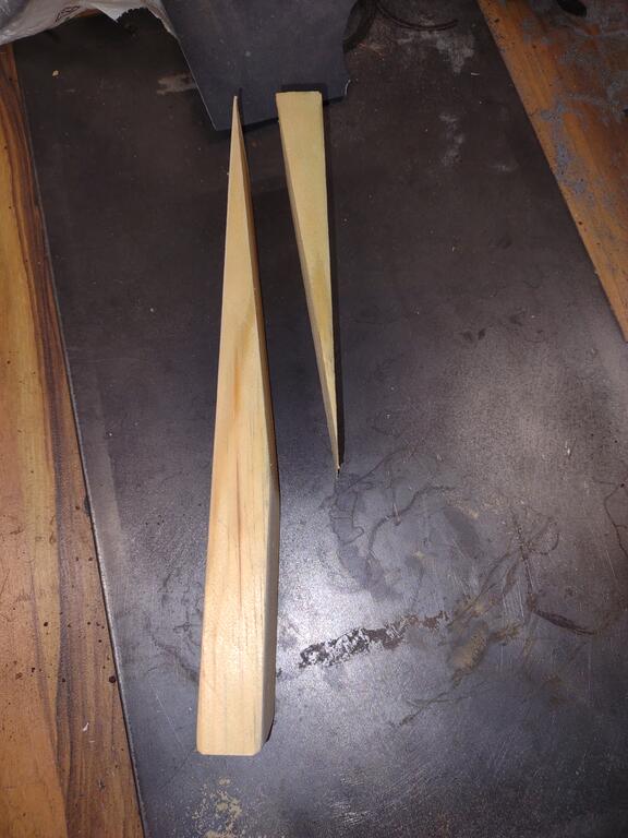

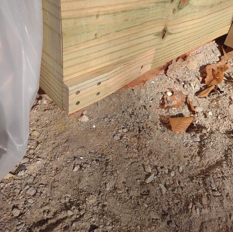

ebinmaine 81,183 #379 Posted October 29, 2022 (edited) I also fixed an inconvenience. When the back rolling door was opening it would contact this piece of exterior trim. I made a wedge from a piece of PT wood outta the scrap pile. Pre Drilled the holes and sanded it. Solved! Now the door rides up the ramp and clears the trim. Edited October 29, 2022 by ebinmaine 3 3 Share this post Link to post Share on other sites

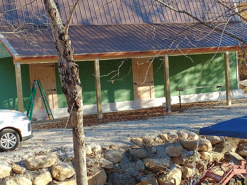

ebinmaine 81,183 #388 Posted October 30, 2022 Here's a better picture of the right side we painted yesterday. And the left side we did today. The little bit left at the top will be finished up when The Paint Department gets a free minute and after the 5 doors are all painted. 2 4 Share this post Link to post Share on other sites

Stormin 9,988 #391 Posted October 30, 2022 Why two service doors on the right side and non on the left side? You going to put a dividing wall in to make two separate workshops? Share this post Link to post Share on other sites
ebinmaine 81,183 #392 Posted October 30, 2022 1 hour ago, Handy Don said: Make sure to record the inaugural whatever is the first thing stored inside! Interesting you'd mention that!! We put our 6 ft fiberglass stepladder in there tonight. 42 minutes ago, Stormin said: Why two service doors on the right side and non on the left side? You going to put a dividing wall in to make two separate workshops? You're close. Back is metal workshop. Front of the first floor will be vehicle storage. Garage. Our insurance company is mandating that IIFF we decide to use any solid fuel or open flame heat source we must not have it in the vehicle storage area. At some point when we get a heater in there we'll have to install a solid wall with no opening to the garage from the area the heat source is in. 2 Share this post Link to post Share on other sites

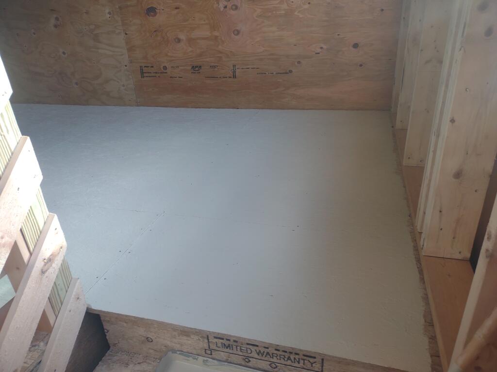

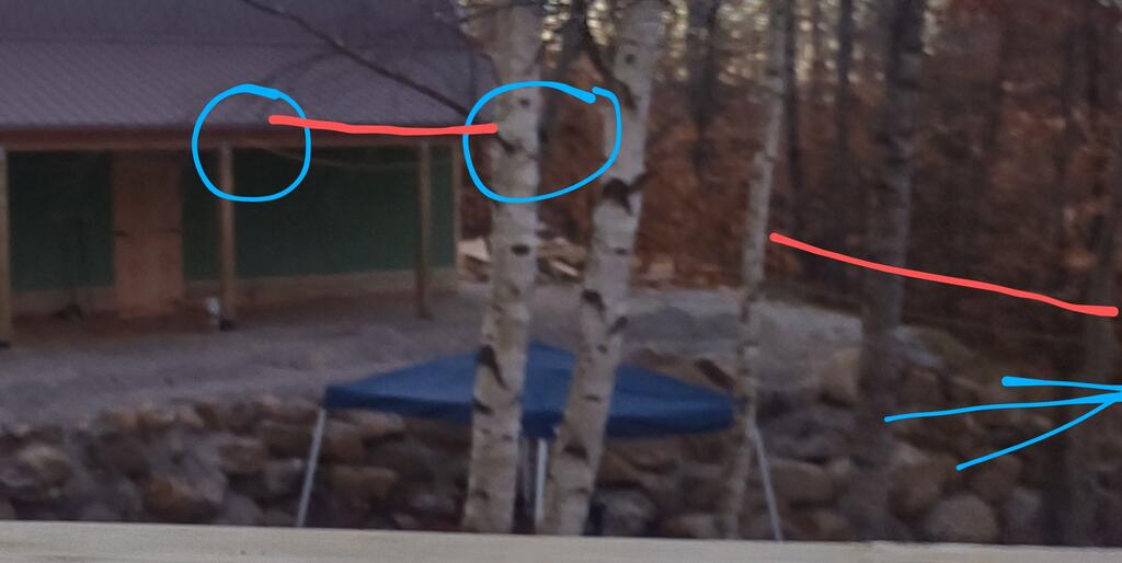

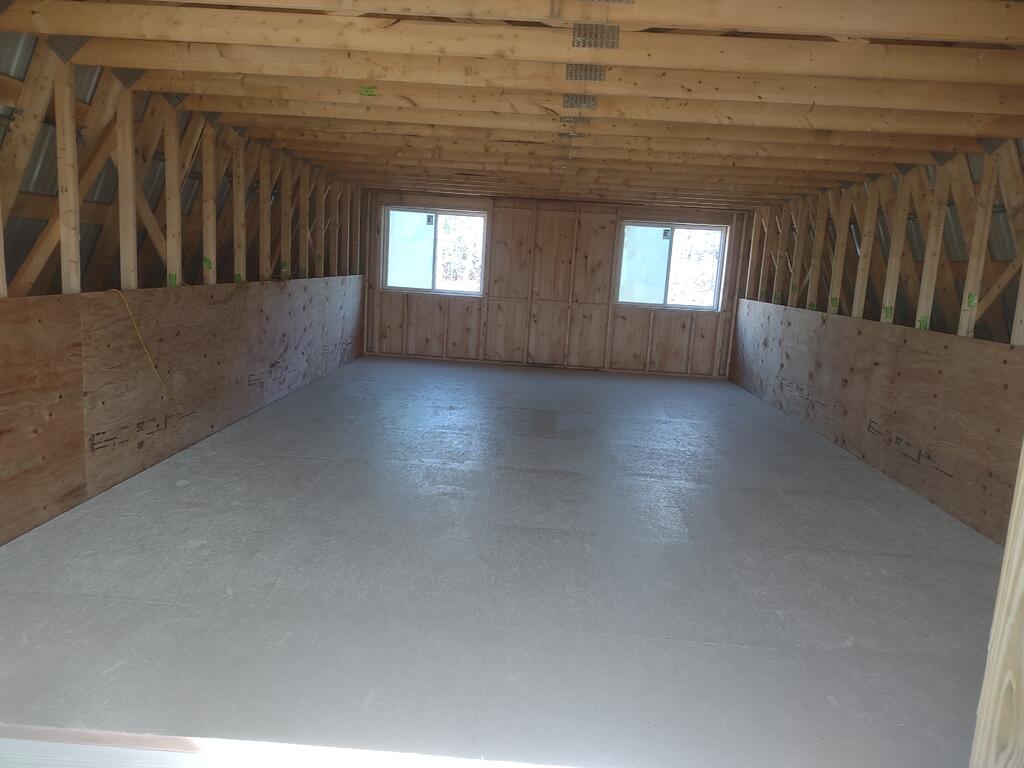

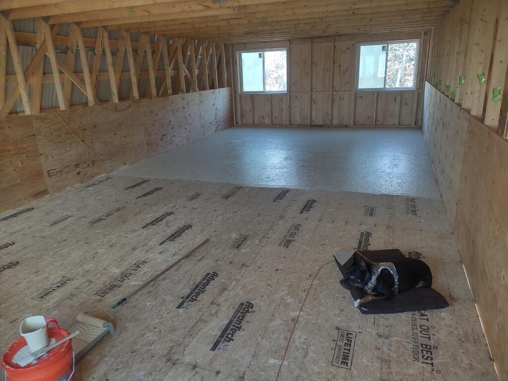

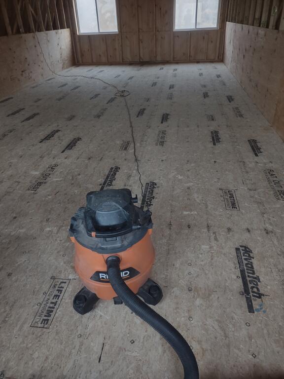

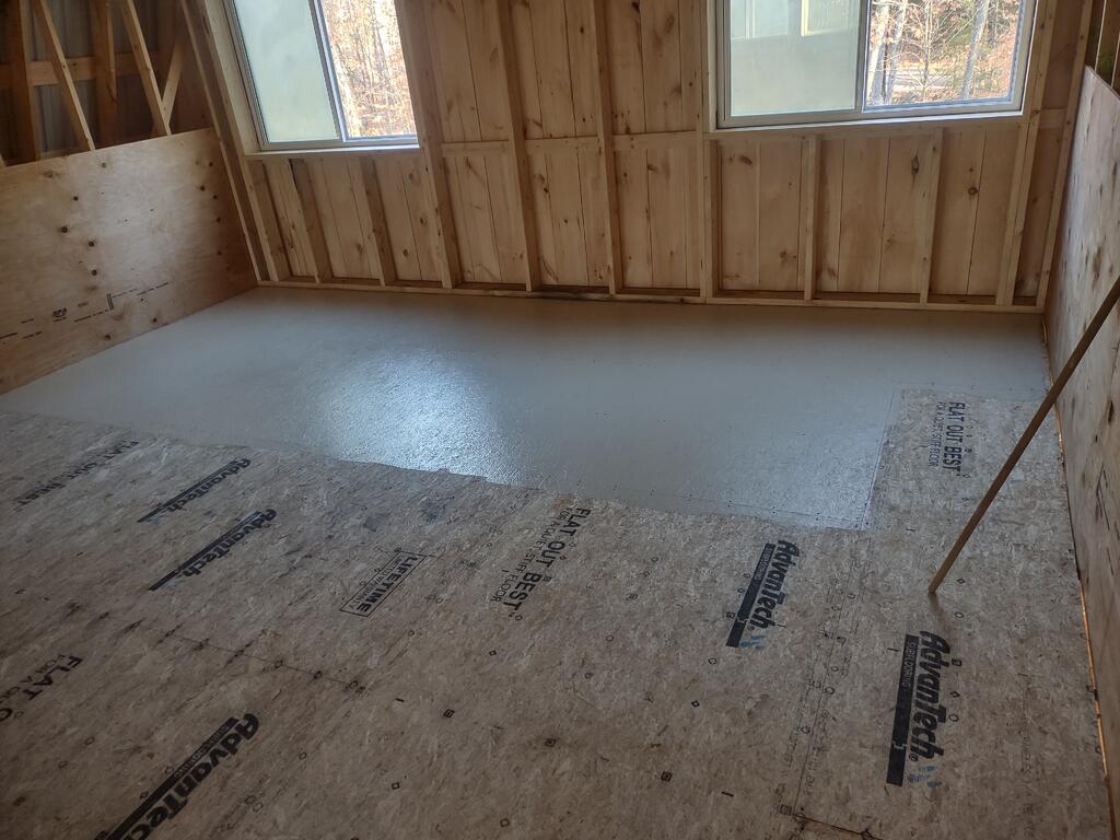

ebinmaine 81,183 #395 Posted November 5, 2022 We decided a few days ago that the upstairs shop floor should be painted. Somewhat for looks. Somewhat for keeping slivers to a minimum given consideration that this'll be at least half Dojo. ALL bare feet. Yesterday I spent a few minutes setting up the extension cord that'll be left in place for a few months going from the old shop out to the new one. I kept it off the ground well enough distance to drive under. Cord follows just below the red line and hangs where the blue circles are. Got up this morning and commenced to vacuumification and painterizing.... AFTER appropriate 🐻🤠☕ in a cup produced by none other than the excellent @19richie66. Here's the highly sought after Before shot. ⅕ done. Halfway mark with Meeha Mirror "helping" DONE!! 2 8 1 Share this post Link to post Share on other sites
Racinbob 13,286 #396 Posted November 5, 2022 I don't know your building layout and existing power locations but given your soil conditions have you considered running a 'permanent' overhead line with a messenger wire? 3 Share this post Link to post Share on other sites
ebinmaine 81,183 #397 Posted November 5, 2022 5 minutes ago, Racinbob said: I don't know your building layout and existing power locations but given your soil conditions have you considered running a 'permanent' overhead line with a messenger wire? Interesting idea. Hadn't heard the term. I learned something new again!! We'll be getting permanent power sometime next year from a standard utility pole set-up. There's a pole at the end of the driveway that goes out to the right from the front of the building. Separate meter from the house. 100 amp service. 3 Share this post Link to post Share on other sites
Racinbob 13,286 #398 Posted November 5, 2022 If you're having the power company run it they will have it as part of the conductors they run. But a messenger wire can be run with various types of conductor support. It sounds like you already have a plan. I should have known you would. You haven't missed a beat on this building. 1 1 1 Share this post Link to post Share on other sites
