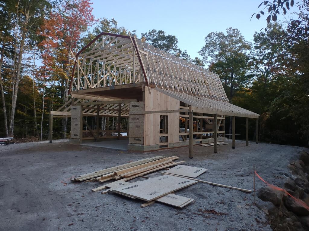

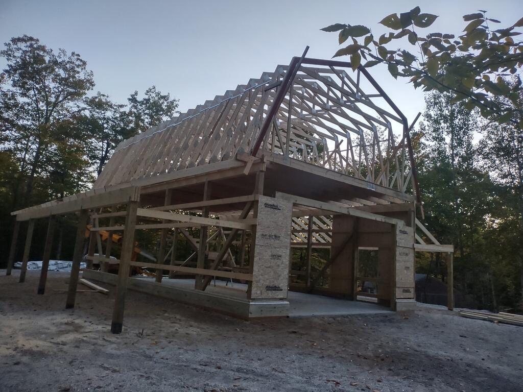

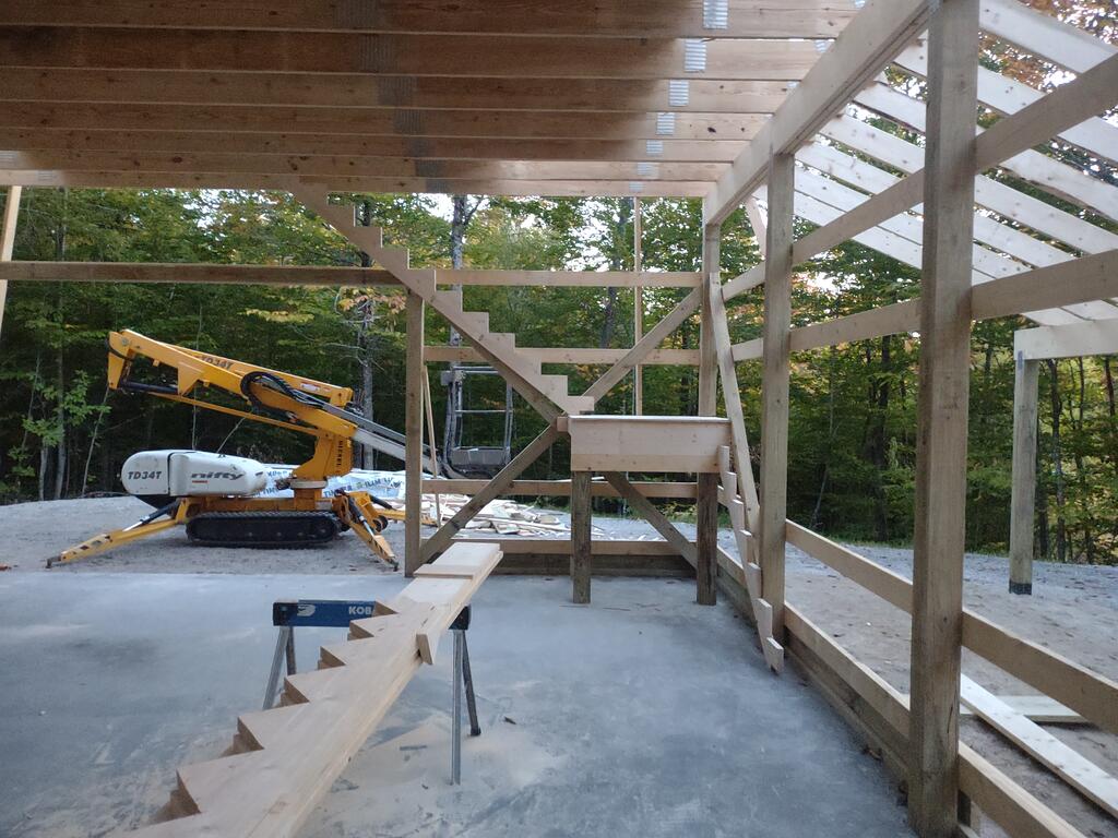

ebinmaine 80,445 #253 Posted October 7, 2022 Shed roof rafters installed. The stairway was started too. 5 6 3 Share this post Link to post Share on other sites
Moparfanforever 936 #254 Posted October 7, 2022 That sure is one fine building to be proud of !! I bet your property value will surely go up with that sittin' on it. You can throw a shindig or two in it !! 2 1 Share this post Link to post Share on other sites

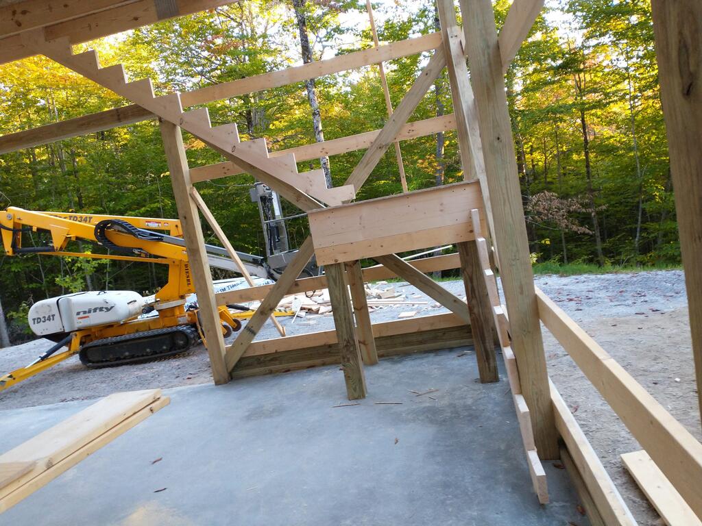

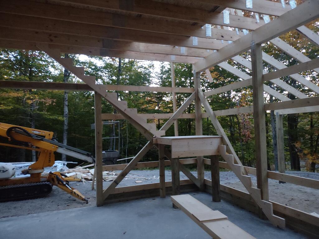

Mows4three 833 #255 Posted October 7, 2022 There are seven risers on the bottom string of your stairs. Do you know if the carpenter put the odd one at the top or bottom? Dave 1 1 Share this post Link to post Share on other sites
ebinmaine 80,445 #256 Posted October 7, 2022 10 minutes ago, Mows4three said: There are seven risers on the bottom string of your stairs. Do you know if the carpenter put the odd one at the top or bottom? Dave It's legitimately possible there is no odd riser. The top and bottom can be anywhere they want em. There's no specific horizontal measurement. Only vertical. 1 Share this post Link to post Share on other sites
Jeff-C175 7,211 #257 Posted October 7, 2022 Looks like it could almost fly! Was the architect Howard Hughes? 2 Share this post Link to post Share on other sites

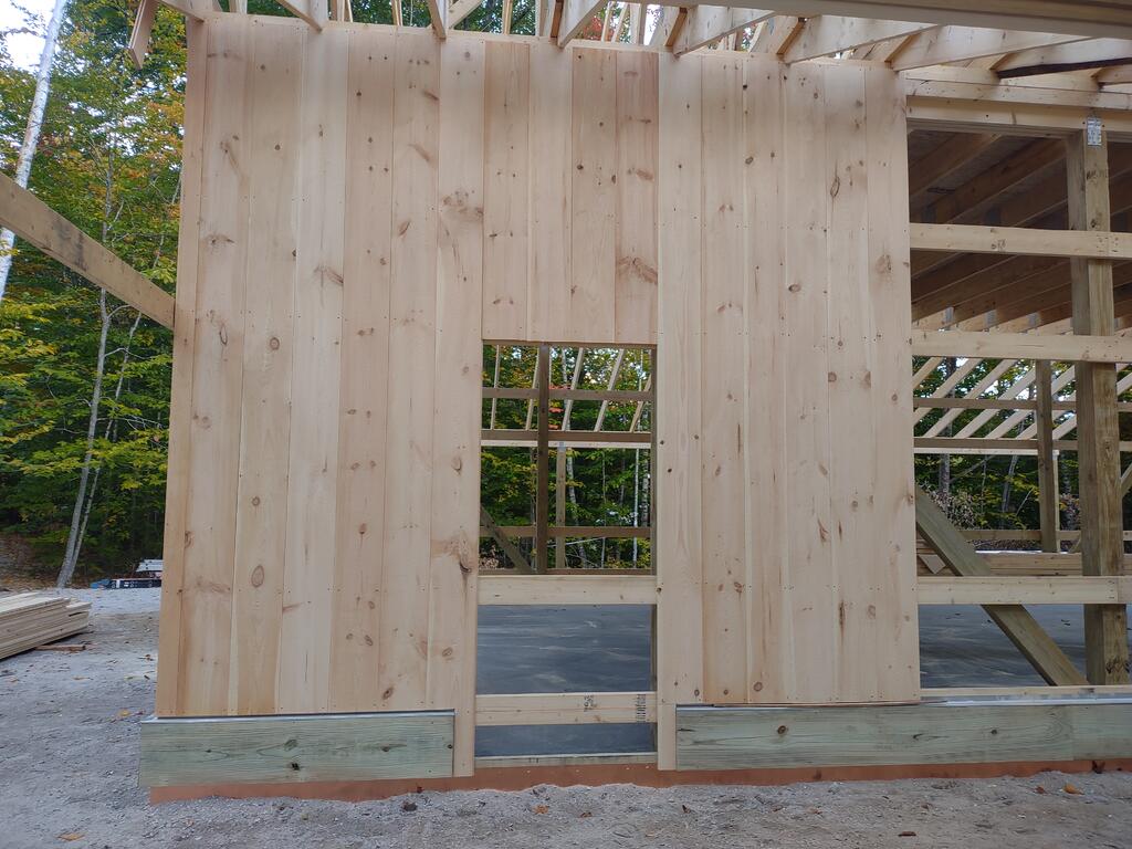

953 nut 68,722 #259 Posted October 7, 2022 Hope the contractor can get everything dried in before the snow flies. Is the whole building going to be wrapped in rough cut planks? 1 Share this post Link to post Share on other sites
ebinmaine 80,445 #260 Posted October 7, 2022 1 minute ago, 953 nut said: Is the whole building going to be wrapped in rough cut planks? Yessuh!! The top floor is already painted and waiting to be installed. The bottom half will be painted within the next two, three weeks max. Trina already has plans on that... 2 1 Share this post Link to post Share on other sites

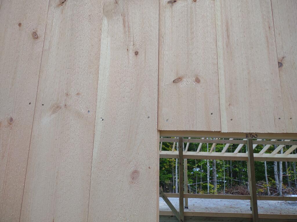

953 nut 68,722 #261 Posted October 7, 2022 Hope the contractor is going to wrap the frame with a couple layers of house wrap. As those boards dry they will have some big old gaps between them. If you plan to use rigid foam insulation panels I guess that wouldn't be too much of a problem. Share this post Link to post Share on other sites
ebinmaine 80,445 #262 Posted October 7, 2022 18 minutes ago, 953 nut said: Hope the contractor is going to wrap the frame with a couple layers of house wrap. As those boards dry they will have some big old gaps between them. If you plan to use rigid foam insulation panels I guess that wouldn't be too much of a problem. The boards are tongue and groove and very carefully selected, cut, and installed. The lumber is from a local mill. Kiln dried of course at the start and it's been sitting for several weeks or months by the time it gets to a job site. It should season and shrink for another year or so. Following that, we're going to go back and put another coat of paint on the entire outside of the structure. We chose specifically not to use any house wrap or plastics around the exterior of the building timber frame between that and the siding. Neither of us likes the look in any way. Decisions on insulation type and quantity will be made later on and dependent on volume of siding shrink. We're not looking to keep this building warm any more than a few hours at a time. 2 Share this post Link to post Share on other sites

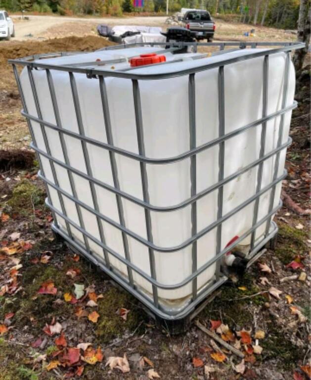

Oldskool 6,678 #267 Posted October 7, 2022 (edited) We just snagged a couple of these to capture some rain water. Stoned drip edges pitched running to some pipe to fill them would make for good irrigation from a large roof like that. You probably have been mulling over something for this I'm sure. Edited October 7, 2022 by Oldskool 1 1 Share this post Link to post Share on other sites
ebinmaine 80,445 #268 Posted October 7, 2022 2 hours ago, Oldskool said: mulling over something We been thinkerizing about whether we should hang gutters and catch the runoff. Likely we'd pipe it right to the frog pond if nothing else. 1 Share this post Link to post Share on other sites

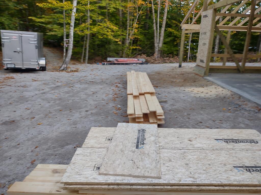

ebinmaine 80,445 #270 Posted October 7, 2022 Figured you folks would get a kick outta the stair size calculator. @953 nut Here's the siding at a close-up. Largest gap yet. Started laying down the roof purlins today. Here's the rest waiting til Monday. 1 1 1 Share this post Link to post Share on other sites

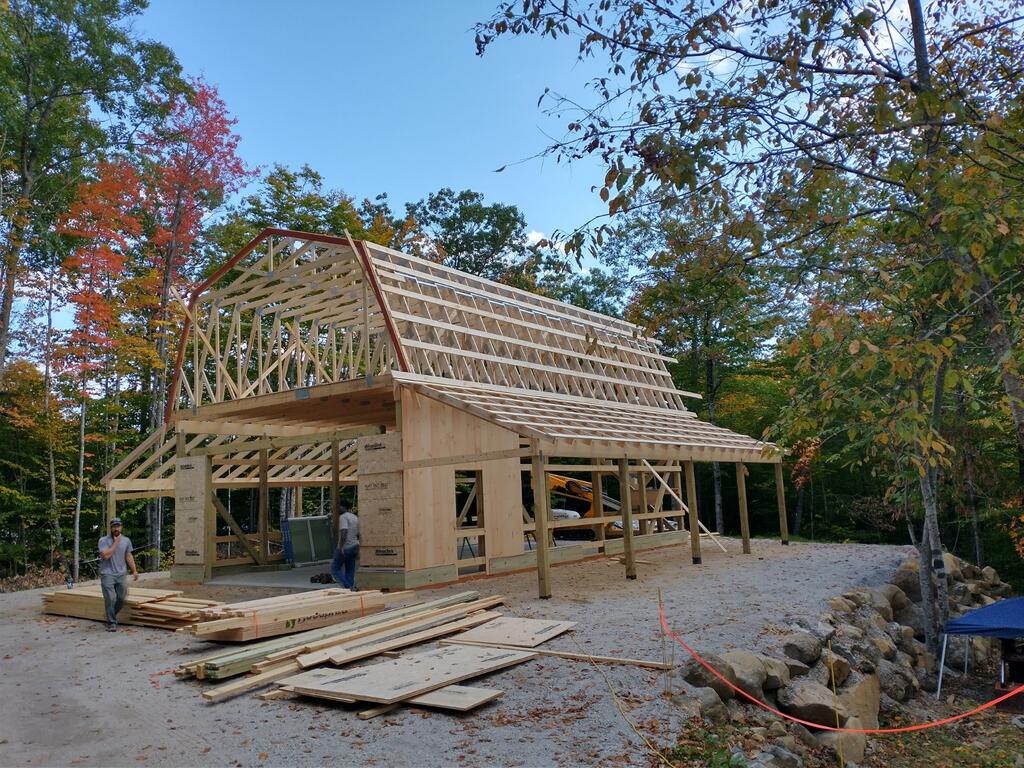

ebinmaine 80,445 #271 Posted October 7, 2022 Some o' you folks have asked me about the truss dimensions. 2 Share this post Link to post Share on other sites

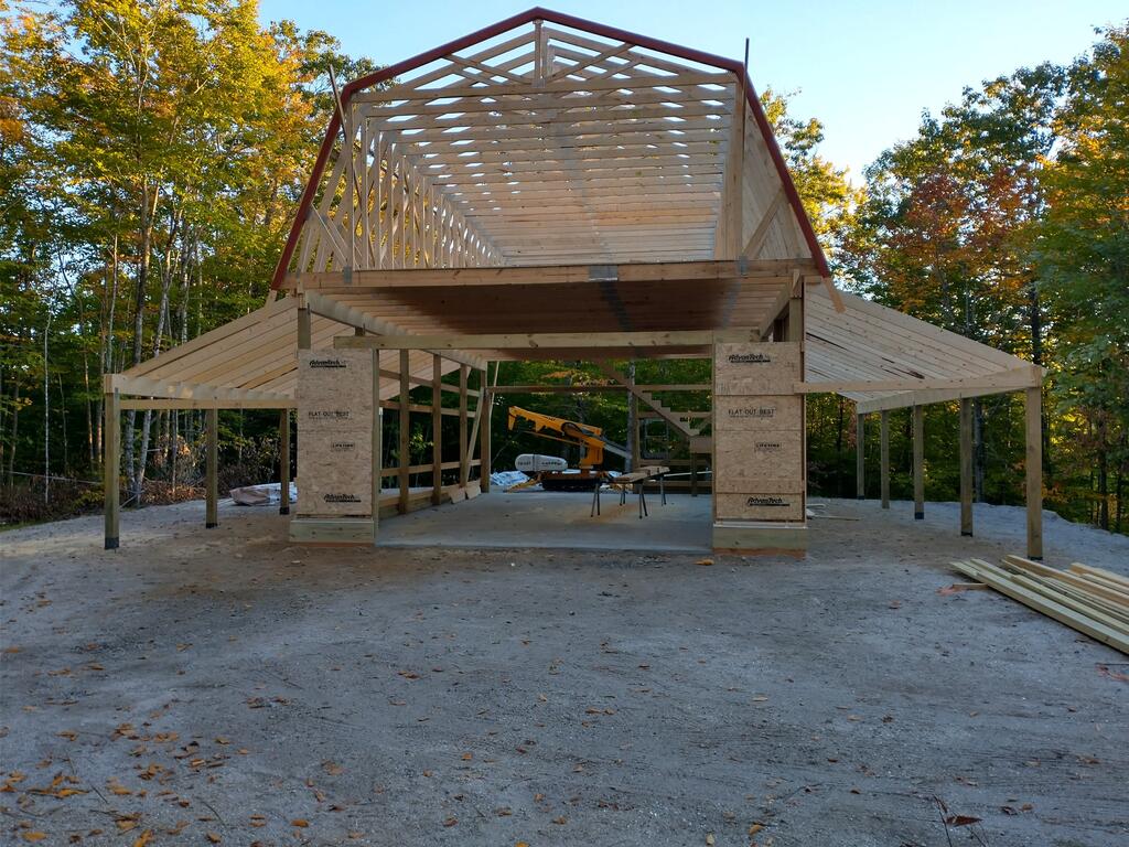

ebinmaine 80,445 #272 Posted October 11, 2022 Today the roof purlins were finished up and the upstairs got 4' walls. The first 7 steps were built and the upper 12 stringers installed. More siding showed up as well. 4 3 Share this post Link to post Share on other sites
