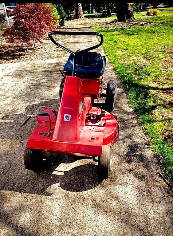

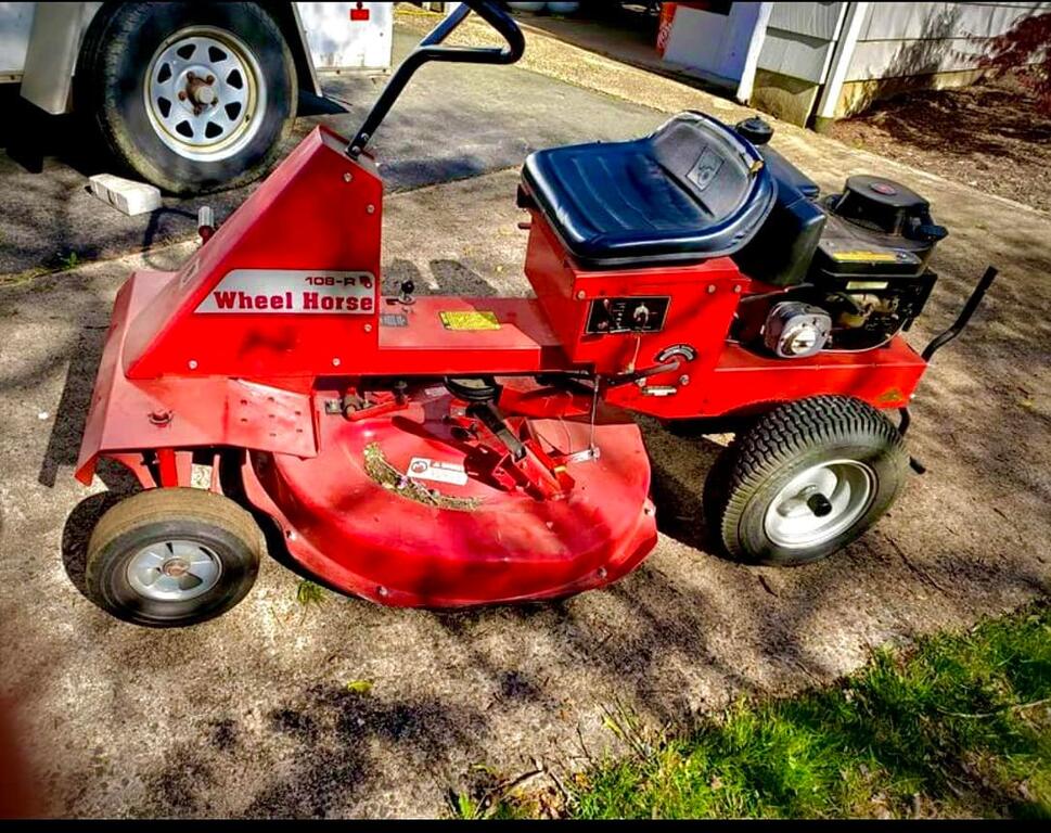

josephvigg 88 #1 Posted June 16, 2022 Grabbed this great little rider to save some mowing hours on my 312. Anyone have any experience or opinions that could be helpful? Ordered new filters, new plug, new spring, new muffler, new recoiler, and fresh oil couple hours of wrench time and she should be good for another 35 years! Also would love to track down a bagger for this or is any one has and retrofit ideas! 2 Share this post Link to post Share on other sites
peter lena 10,090 #2 Posted June 16, 2022 @josephvigg worked for a guy on weekends , that had the snapper version of that , your upcoming basic maintenance baseline service will serve you well . would suggest that you regularly clean out the bottom of the deck , for grass build up / rust corrosion . regularly counter that with an aerosol lubricant, that will soak into the metal , lightly fine file the blade , grease everything regularly . was pretty solid and reliable , no major problems. realize that bagger will cause deck build up , due to reduced discharge flow / rate . would not use one , lubricate throttle and choke cables / linkage , SUPER LUBE OIL . small bottle . make a good around the edges trimmer . pete Share this post Link to post Share on other sites
peter lena 10,090 #3 Posted June 16, 2022 @@josephvigg https://www.amazon.com/Super-Lube-51004-Synthetic-Viscosity/dp/B000UKUHXK use this on all my choke and throttle cables and related linkage points , usually available at local h/w store . make the lube come out each end to verify lube soak , really works , pete Share this post Link to post Share on other sites

wh500special 2,465 #8 Posted June 16, 2022 I love those little riders. And recoil start is awesome. Those things were meant to be stood up on those rear bars for storage or access to the deck. That way they take up minimal floor space. The electric start models had a hanging battery tray that kept the battery upright and the gas cap should have a sealing vent on it. I assume the oil will stay in the engine and the gas won't leak out, but use your own judgement if you try it. If you were in Illinois, I'd offer you up a trade for that cute little sucker. i had one with a bagger years ago and still regret letting it go. Steve 2 Share this post Link to post Share on other sites

josephvigg 88 #11 Posted June 30, 2022 On 6/16/2022 at 1:31 PM, wh500special said: I love those little riders. And recoil start is awesome. Those things were meant to be stood up on those rear bars for storage or access to the deck. That way they take up minimal floor space. The electric start models had a hanging battery tray that kept the battery upright and the gas cap should have a sealing vent on it. I assume the oil will stay in the engine and the gas won't leak out, but use your own judgement if you try it. If you were in Illinois, I'd offer you up a trade for that cute little sucker. i had one with a bagger years ago and still regret letting it go. Steve Ya know thats what i thought they were for!! what a cool feature. Itll be great for winter storage and cleaning the deck Share this post Link to post Share on other sites

Handy Don 17,562 #14 Posted July 1, 2022 7 hours ago, josephvigg said: Ya know thats what i thought they were for!! what a cool feature. Itll be great for winter storage and cleaning the deck Not all of these were meant to be STORED upright. My Snapper specifies two hours of "up time" max. I would read the manual carefully! Plus, be aware that you may need to leave it "down" for an while before trying to start it to let all the oil go back where it belongs. Mine (12.5 hp B&S IC Commercial) needs about 20 minutes. Share this post Link to post Share on other sites
