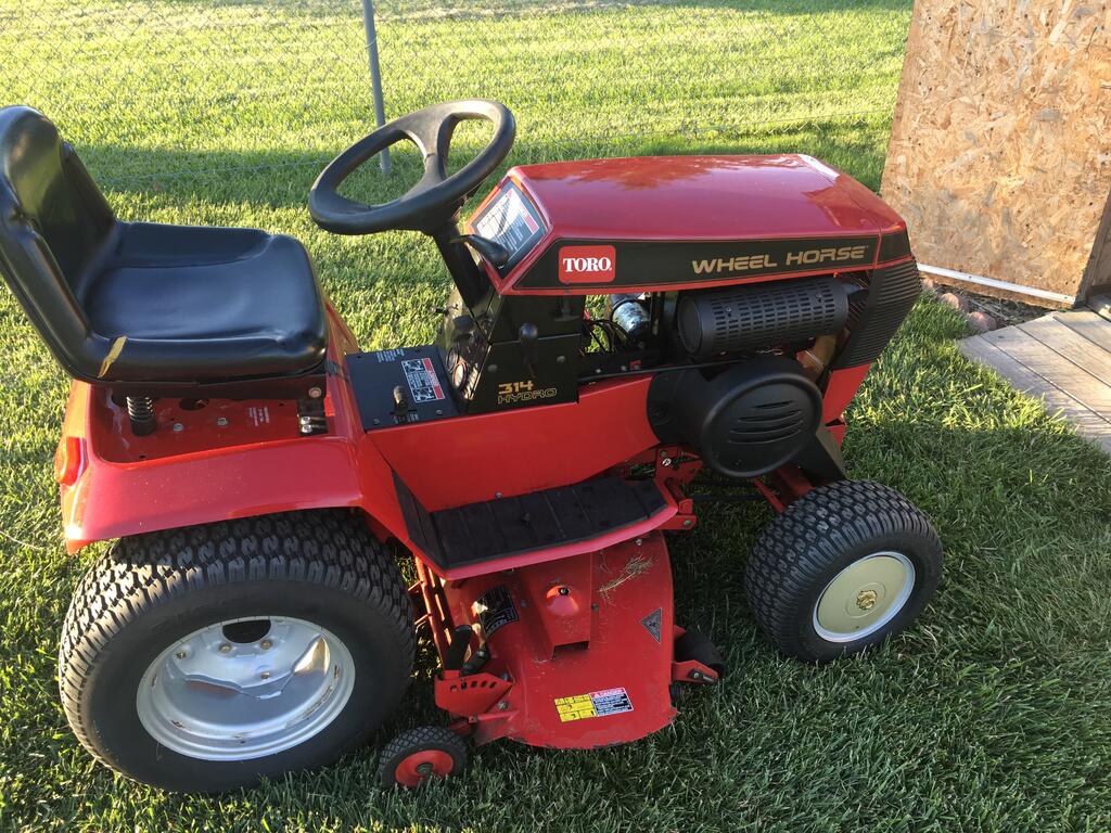

Shu 5 #1 Posted June 15, 2022 I have a 1996 Wheel Horse 314H with the Kohler M14. It has had an issue for a few years now where after it gets hot it starts to misfire, stall and eventually die. If I cool it down; leaf blower, it will start up and run again until hot. I have replaced the ignition module/coil, spark plug, carburetor, fuel line, fuel pump, ignition switch, battery and it still does it. It has to be hot outside too. Will not do it on a cooler day. Seems to be worse on rougher terrain. Is there a temperature sensor on the M14? Any other thoughts on the cause. It runs GREAT, burns no oil, starts right up, and it is in remarkable condition; just this one issue. 2 Share this post Link to post Share on other sites
