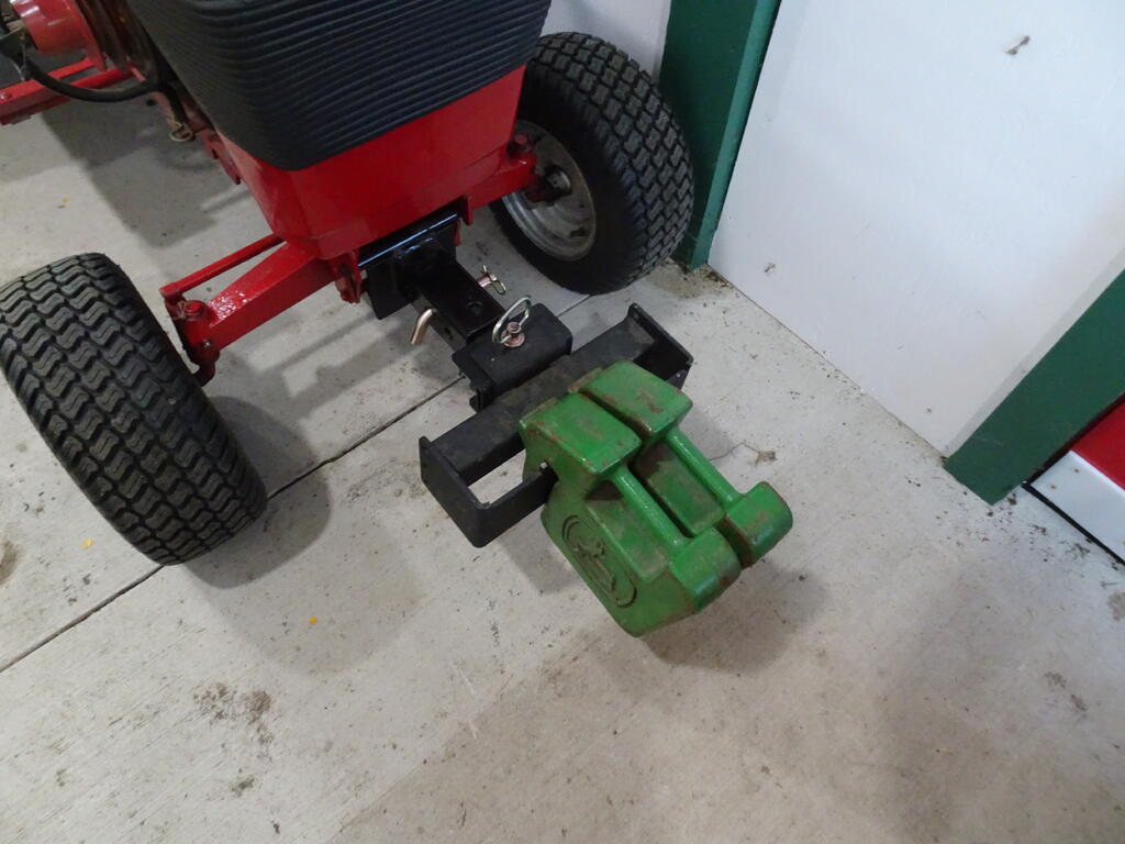

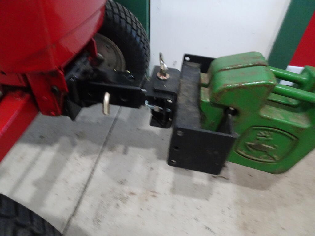

gwest_ca-(File Mod) 12,289 #4 Posted June 13, 2022 Here is what was available 5 Share this post Link to post Share on other sites

sergeant 350 #11 Posted June 20, 2022 (edited) On 6/12/2022 at 4:10 PM, 857lover said: hey guys i was wondering if anyone makes a front suitcase weight bracket for the front of a 400 series tractor i am always seeing rear wheel weights everywhere but i don’t ever see stuff for front weight and i wanna see if anyone can make or sells theese because i don’t have any way to make one thanks ! Not a Cheap way to do it On My Part at $303.99 Not Including suitcase weights But Many of the components I Bought when Things were a heck of a Lot cheaper Bought This https://www.ebay.com/itm/131944396619?hash=item1eb87fb74b:g:ux4AAOxyYANTYX55 also Had this already https://heavyhitch.com/product/sleeve-hitch-adapter-2-inch-receiver/ also Had this https://www.johnnyproducts.com/SleeveHitchAccessories.htm Called a 4X Multi Suitcase weight Pinned weight receiver, so I can put up to (4) 42lb suitcase weight On the front Only used Up to 2 so far But I can use most of the set-Up with Lowell’s Hitch https://wheelhorsepartsandmore.com/product/heavy-duty-removable-receive-hitch-if-you-have-a-104659-bracket/ and Have 4 suitcase for the winter when ever I get a front blade for my 416H. Probably will eventually just have a 2inch Insert with weight Bracket Made so I can skip On the sleeve Hitch Insert and keep the weights a bit closer to the Tractor Edited June 20, 2022 by sergeant 3 Share this post Link to post Share on other sites

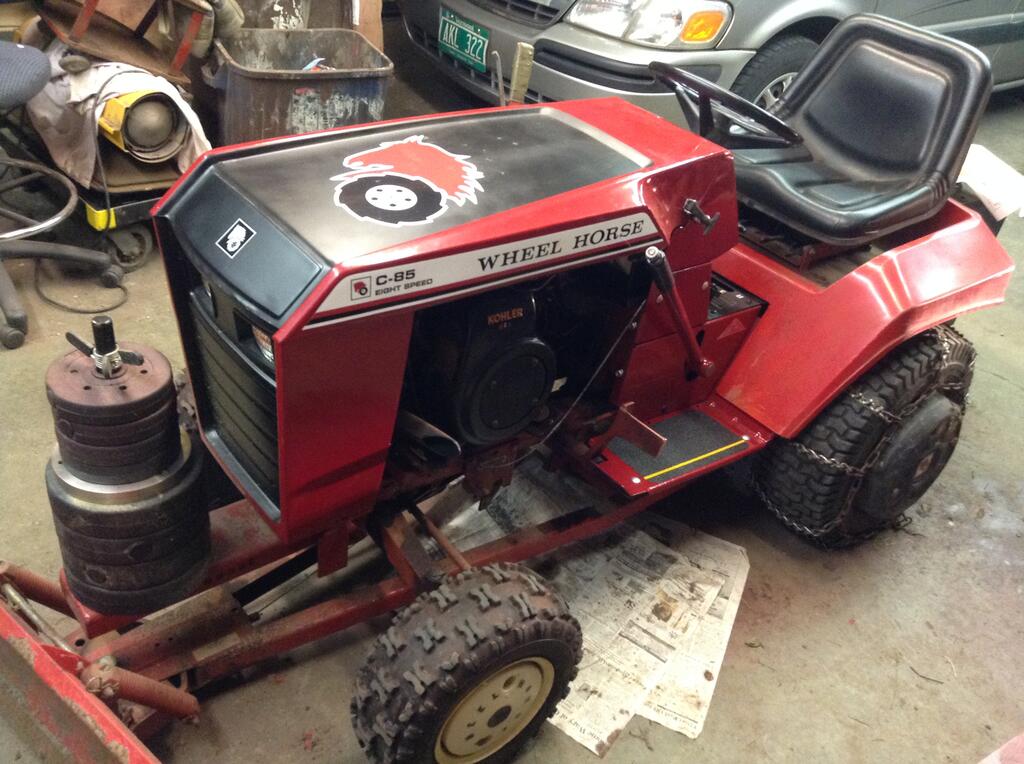

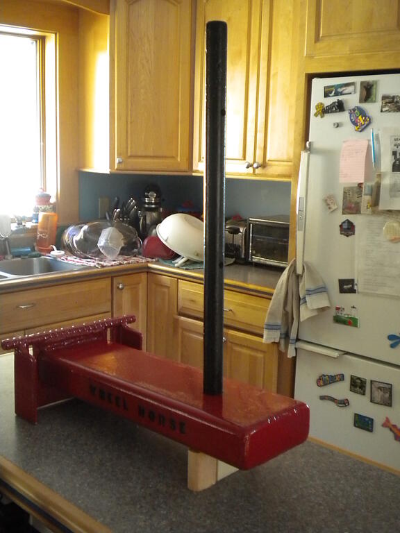

C-85 805 #13 Posted July 8, 2022 Here's my version, this is independent of the plow and hitches to the Tach a Matic front mount, I made this myself - C-85 This is what it looks like off the tractor - 2 3 Share this post Link to post Share on other sites
peter lena 9,910 #14 Posted July 28, 2022 @C-85 thats not fair ! working in the kitchen , does not count , you get no points for that ! I also have a c-85 , bought it new in 82 , recently celebrated over 40 years with it , did a 12 horse magnum swap a few years ago , still my favorite of my 3 horses , has all my experimentation ideas on ending chronic problems on it . dr frankenhorse , AKA , greasy pete 1 Share this post Link to post Share on other sites

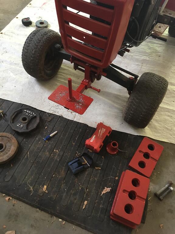

Lee1977 7,648 #17 Posted March 25, 2023 These will fit any Wheel Horse with the front hitch. I used a 5/8" bolt because I had it, 5/8' rod will work just as well. I used a 2x2x1/4 angle a flat plate will work also. Your a couple years late can't see to weld anymore 3 Share this post Link to post Share on other sites
