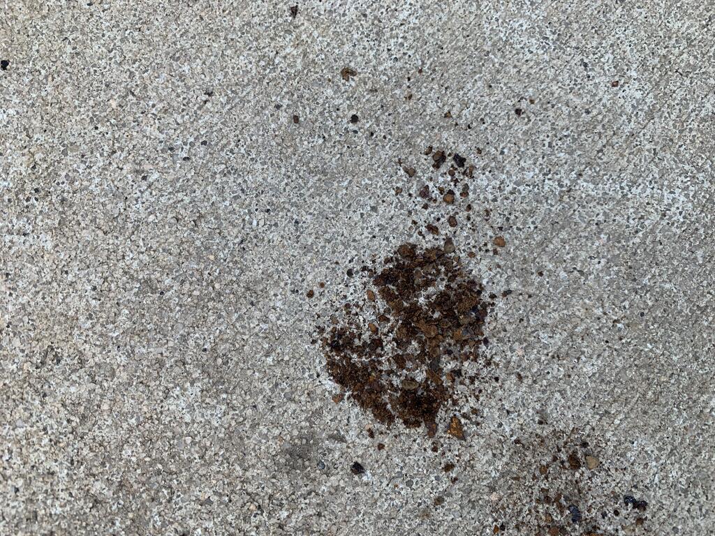

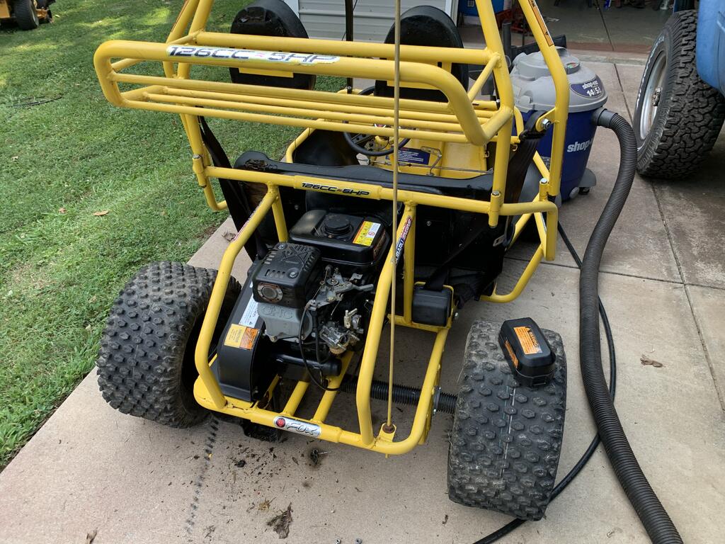

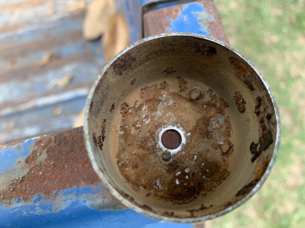

Horse Newbie 7,404 #1 Posted June 12, 2022 (edited) So my neighbor has been wanting me to try and get a go cart running… been sitting outside for years… not good… Gas tank had major rust… took it off to clean it, and the tank has a big rust hole. You just can’t let equipment sit outside… I guess he’ll be buying a tank. Got her running though. Carb bowl was full of rust too … Air filter had turned to dust… I had to vacuum the air cleaner out to keep it from crumbling and falling down into the carb… Edited June 12, 2022 by Horse Newbie 2 1 1 Share this post Link to post Share on other sites

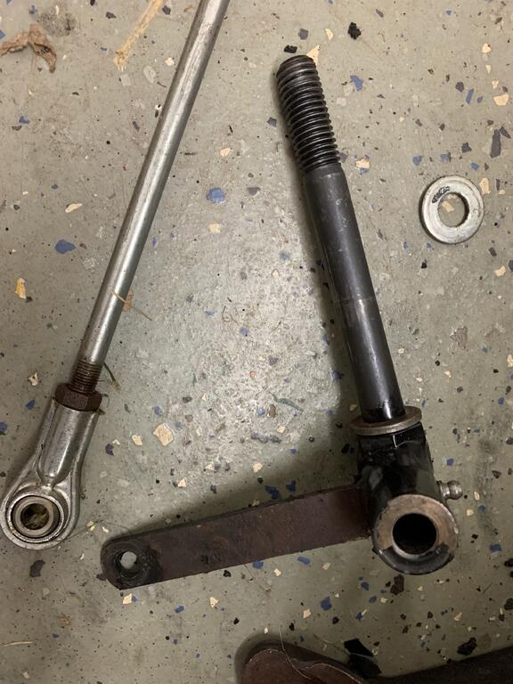

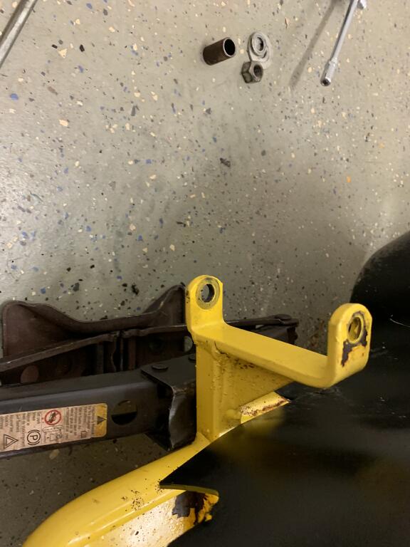

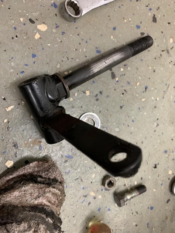

Horse Newbie 7,404 #7 Posted June 12, 2022 So the more I look at the go cart, the more knackered up things I find… gonna take a little work before my first ride ! The right side steering arm was bent, tie rods were way out of adjustment causing the front tires to point outward. The jam nuts on the tie rod ends were not snug. So I straightened out the steering arm best I could in a vise, using an adjustable wrench and a 2 lb BAH. The heim joint ends were about rusted in place so I worked them with WD-40 to loosen them up and greased them with bearing grease. Used Valvoline , not the Lucas good stuff- saving that for the Horses… although I will probably grease the wheel spindles and front wheel bearings with the Lucas since it’s already in the grease gun. 2 Share this post Link to post Share on other sites
