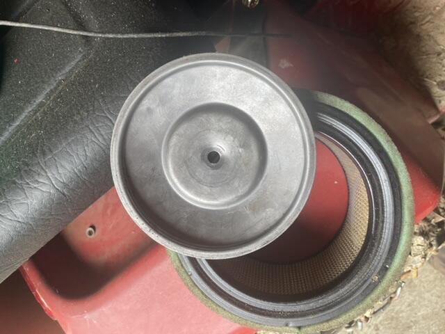

AHS 1,698 #1 Posted June 11, 2022 Is this ‘Air cleaner element cover’ KH10412? I need it and can’t find it on eBay. Amazon wouldn’t have it…where else? Share this post Link to post Share on other sites

tunahead72 2,645 #3 Posted June 12, 2022 @AHS Did you get that number from a parts list? Is there any chance it's been superseded to something else? @chev0545 had a wanted ad here looking for the same part about a month ago, maybe he has some ideas. A-Z Tractor might have one, he's worth a call. 1 Share this post Link to post Share on other sites
tunahead72 2,645 #4 Posted June 12, 2022 I checked the parts manual for that engine (Magnum M14, spec 601524 or 601540, right?)... That cover seems to be Kohler part number 52 082 04. OPE Engines and SEPW have them new for about $20, A-Z Tractor has some used ones in stock for $10. 1 1 Share this post Link to post Share on other sites
AHS 1,698 #5 Posted June 12, 2022 No, I checked the 414-8 parts on here. Ok, I will try that part number! OPE Engines and SEPW? Thank you! 1 Share this post Link to post Share on other sites
gwest_ca-(File Mod) 12,454 #6 Posted June 12, 2022 414-8 could be a K-series engine or M-series 1 Share this post Link to post Share on other sites
tunahead72 2,645 #7 Posted June 12, 2022 10 hours ago, gwest_ca said: 414-8 could be a K-series engine or M-series Good point, Garry. I was going by the photo in the first post, which looks more like a Magnum setup to me. @AHS Can you confirm that your engine is a Magnum? 12 hours ago, AHS said: No, I checked the 414-8 parts on here. Ok, I will try that part number! OPE Engines and SEPW? Thank you! I haven't seen any other references to the part number you gave us earlier, except for the one want ad here I mentioned earlier. I don't know what that KH10412 would be. Share this post Link to post Share on other sites
AHS 1,698 #8 Posted June 18, 2022 Magnum. 52-082-04 works. 1 Share this post Link to post Share on other sites
