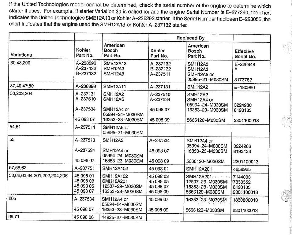

Ed Kennell 47,813 #1 Posted June 9, 2022 Do the K Kohlers 10 thru 16 HP use the same starter? I need a starter for a K321-S Spec # 604410 ser # 1610811383 The starters that look correct (10 tooth) show they fit the K241, K301 , and K341. But the fit list does not include a K321 Share this post Link to post Share on other sites

pfrederi 21,301 #3 Posted June 9, 2022 You sure about that spec number?? Share this post Link to post Share on other sites
pfrederi 21,301 #4 Posted June 9, 2022 If it is 60414 (made for WH) it would be variation 205 see bottom of picture for part number Share this post Link to post Share on other sites

Ed Kennell 47,813 #7 Posted June 9, 2022 5 hours ago, gwest_ca said: Original number help? https://www.partstree.com/models/k321-60440-kohler-k-series-engine-made-for-wheel-horse-14hp-10-4kw/electric-start-cont-11-10-37-tp-691-b-rev-10-17-2006-10/ Thanks Garry, that helps. So I need a # 236396 starter. 5 hours ago, pfrederi said: You sure about that spec number?? Yes the spec is 604410. Garrys link shows this number as correct. How do I determine the variation of my K321 6044 to be able to use the chart? The 236396 starter is shown on the second line of the chart. @Maxwell-8 and @pacer, this is for a customer. His starter came loose and broke one of the mounting bolts off in the block resulting in jamming the bendix in the flywheel. He got the broken bolt out and remounted the starter and it is working OK, but he wants a spare starter on the shelf in case the starter shaft was stressed and may fail. I have seen these starter shafts break. 2 Share this post Link to post Share on other sites

pfrederi 21,301 #12 Posted June 10, 2022 14 hours ago, Ed Kennell said: Thanks Garry, that helps. So I need a # 236396 starter. Yes the spec is 604410. Garrys link shows this number as correct. How do I determine the variation of my K321 6044 to be able to use the chart? The 236396 starter is shown on the second line of the chart. @Maxwell-8 and @pacer, this is for a customer. His starter came loose and broke one of the mounting bolts off in the block resulting in jamming the bendix in the flywheel. He got the broken bolt out and remounted the starter and it is working OK, but he wants a spare starter on the shelf in case the starter shaft was stressed and may fail. I have seen these starter shafts break. Per the Kohler engine web site spec numbers are 4 or 5 digits never 6... WH spec #s for K321 all start with 60 last 3 digits are these...124,125,137,279,322,362,373,414,424,440 1 Share this post Link to post Share on other sites
Ed Kennell 47,813 #13 Posted June 10, 2022 4 hours ago, pfrederi said: Per the Kohler engine web site spec numbers are 4 or 5 digits never 6... WH spec #s for K321 all start with 60 last 3 digits are these...124,125,137,279,322,362,373,414,424,440 Thanks Paul, the info the owner gave me vie phone was 604410. It could very well be 60440. Share this post Link to post Share on other sites
pfrederi 21,301 #14 Posted June 10, 2022 47 minutes ago, Ed Kennell said: Thanks Paul, the info the owner gave me vie phone was 604410. It could very well be 60440. 60424 was on 1985 314-8 and 314-A 60440 1986 414-8 Even though Kohler shows 60414 as a WH spec I can't find for a specific WH tractor.... Share this post Link to post Share on other sites
Ed Kennell 47,813 #15 Posted June 10, 2022 3 hours ago, pfrederi said: 60440 1986 414-8 The owner said it was a 1987 414-8. He may have bought it in 1987, but it is probably an'86 model. Share this post Link to post Share on other sites
