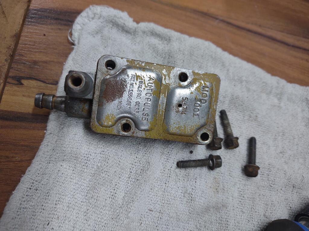

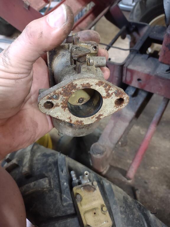

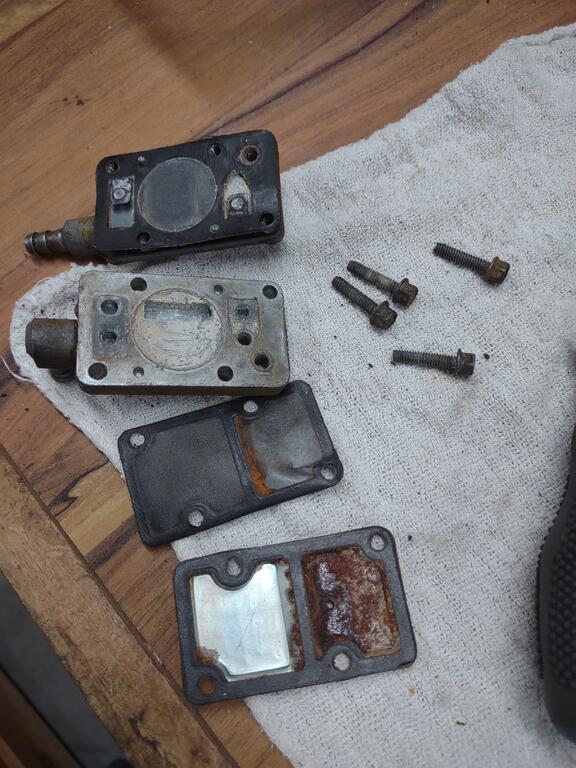

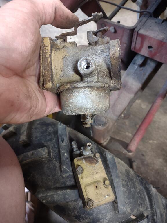

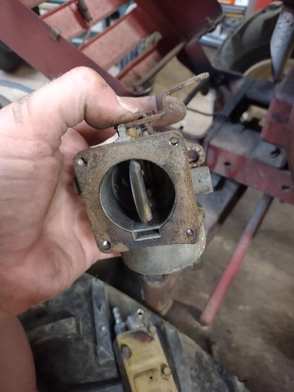

ebinmaine 80,684 #34 Posted July 1, 2022 I've spent some time checking over the wiring and general condition. This afternoon I put a battery on the fender, a new spark plug, and turned the key. This engine will fire with a spray in the carb but the fuel pump wouldn't pull anything. I removed the fuel pump and carburetor to clean and inspect. 4 Share this post Link to post Share on other sites
Handy Don 17,473 #35 Posted July 1, 2022 1 hour ago, ebinmaine said: removed the fuel pump and carburetor to clean and inspect The carb looks recoverable but the fuel pump may be more trouble than it's worth. Those one-way valves look iffy and that screen with the gasket edge are, I suspect, irreplaceable and I can't imagine it being worth your time to try to fabricate one. 1 Share this post Link to post Share on other sites

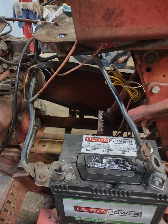

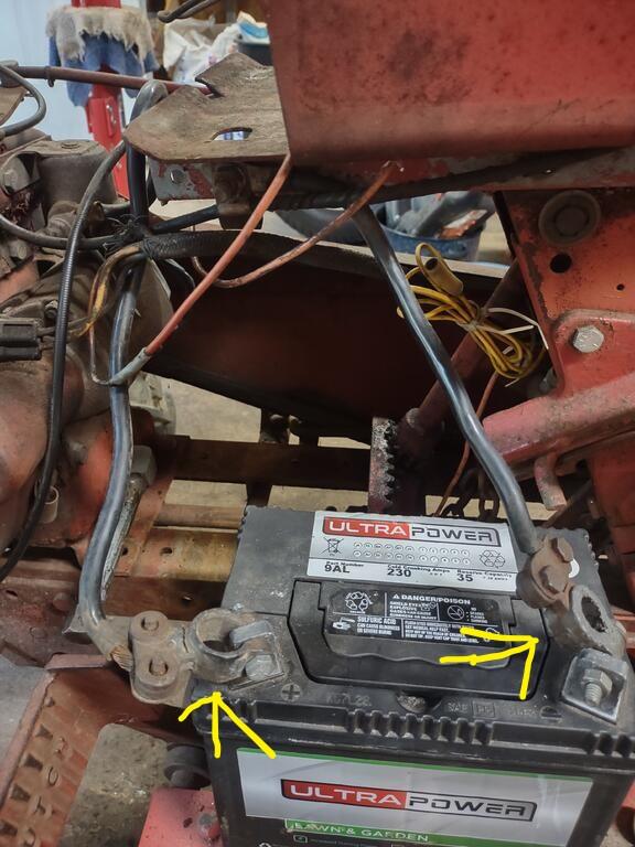

Snoopy11 5,731 #36 Posted July 1, 2022 Eric... pal... Okay... no... just.... no... THAT is... simply not the correct terminals for 'dat battery... Me thinks you could use some of these or... something... Don Share this post Link to post Share on other sites
ebinmaine 80,684 #37 Posted July 1, 2022 6 hours ago, Snoopy11 said: THAT is... simply not the correct terminals for 'dat battery Whassamattawiddeez?? Other than a slight (total) interference with the clutch pedal it's ... Well maybe I'll change it. That's not the battery that'll end up in there anyway. This tractor can and will use a group 51 51r. 6 hours ago, Handy Don said: The carb looks recoverable but the fuel pump may be more trouble than it's worth. Those one-way valves look iffy and that screen with the gasket edge are, I suspect, irreplaceable and I can't imagine it being worth your time to try to fabricate one. Agreed on both counts. The fuel pump is interesting to look at but beyond practical rebuild. Carb ... I think... Is usable. 1 Share this post Link to post Share on other sites

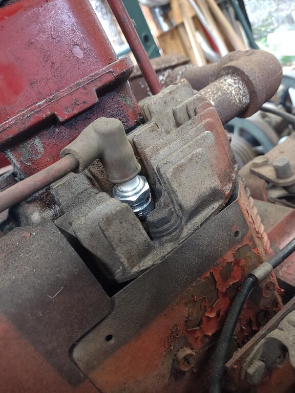

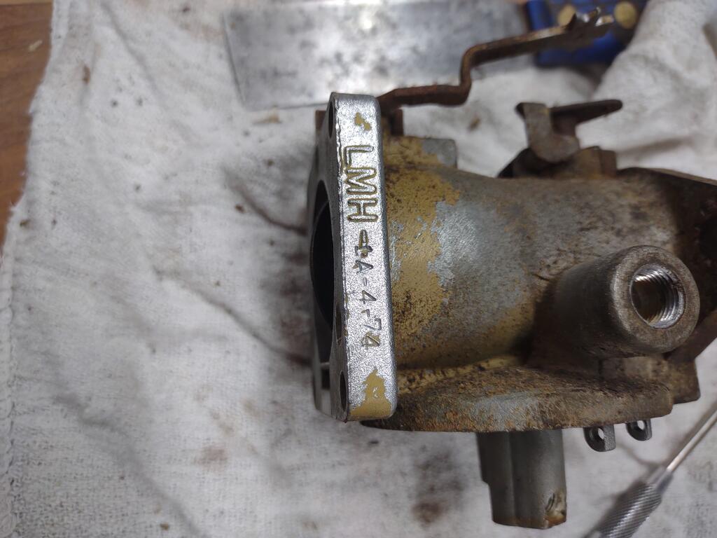

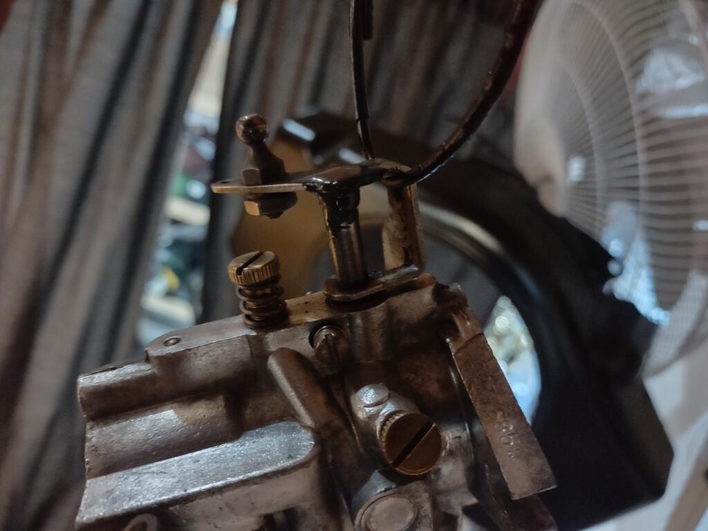

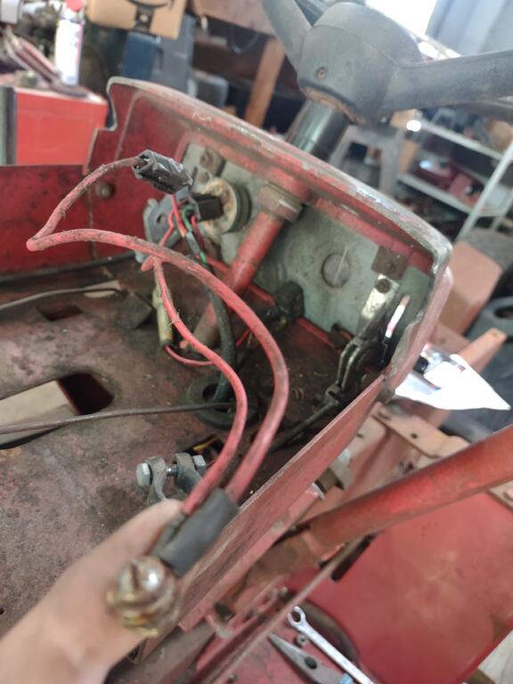

ebinmaine 80,684 #43 Posted July 10, 2022 I've been thinking it would be neat to have this rig going up to Owl's Head show which is next weekend. I'd need to clean up the wiring a little and install an electric fuel pump amongst the other known issues. Here we can see the PO repair for bypassing the PTO switch. It was wrapped in electrical tape... Today I modified and installed a battery hold down. Also changed the solenoid which I discovered had a loose small terminal when I tried to remove the wire from the ignition switch. I didn't have a carb kit in stock for the LMH (big) carburetor. Because of that I wasn't able to remove the side welch plug and clean behind it. I did clean it out what I could. Installed the carb. Fired it up.. It'll run for a bit... Make some fun popping sounds... And die out. I believe the carb is still gunkified internally. While messing with that the starter began acting up. The Bendix has of course been setting for (decades?) And isn't overly willing to move right. Not disengaging when I let off the key. So I pulled the side cover off the engine to see what's happening there... We had a talk involving brake clean and dry lube. Now it'll disengage if I make the engine turn completely several times. "Bump" the key and it sticks. Good enough for now. While in there I cleaned a few insect nests off the flywheel. Today I'll check the pin to ignition coil gap. Finding that the longer pin should be around .010. Then get the side cover put back and see about putting a Kohler Carter #30 carb on it. This is the carb that was on the original C160 Kohler engine that eventually became Cinnamon Horse. It was very loose and the top linkage was broken. At one point I had tried to hold it in place with solder but couldn't get it hot enough. It needed to be brazed. This time I used J. B. Weld Quick set. If it runs better I'll likely just set the RPM to something at a very high idle. I probably won't have time to create a linkage to the governor but that'll do for show purposes. 3 1 Share this post Link to post Share on other sites

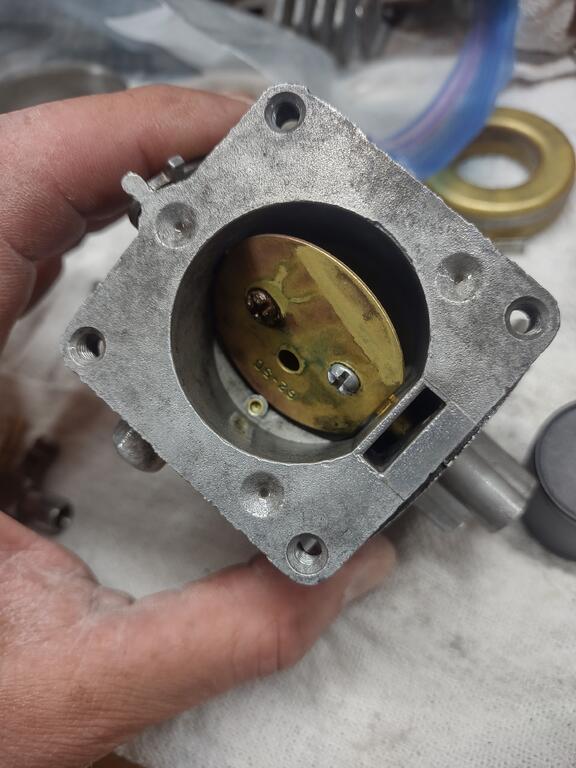

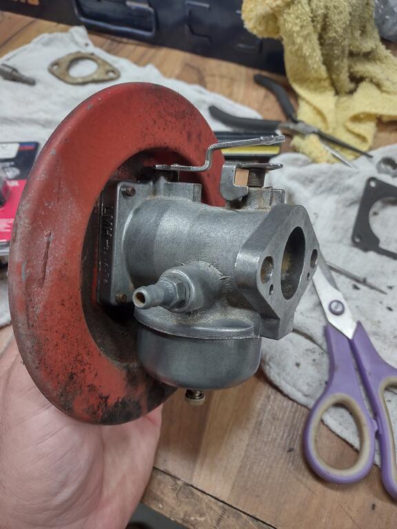

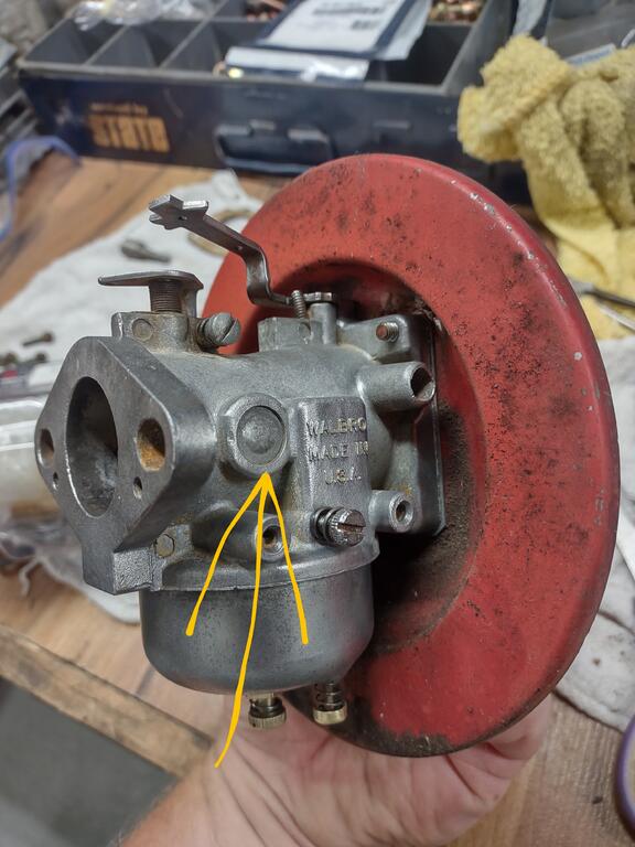

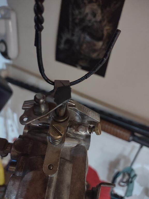

ebinmaine 80,684 #50 Posted September 9, 2022 Well ladies and gentlemen I've had a second or two to get back on this carb for a second or two. I popped the Welch plug out. Soaked it for 2 days sprayed 2 full cans of brake clean all around. It's definitely cleaner in a noticeable way. Next week I'll order a carb kit and see about getting the Tecumseh back to running. I did find something rather disconcerting... Notice in the pic below the choke flapper is contacting the little nubule inside the carb. WTH??? It won't allow the choke to close because of that. 2 Share this post Link to post Share on other sites
