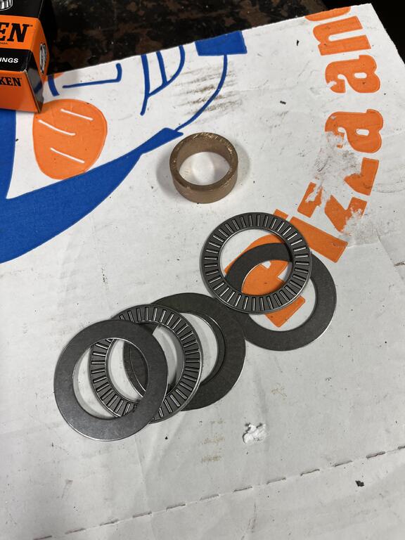

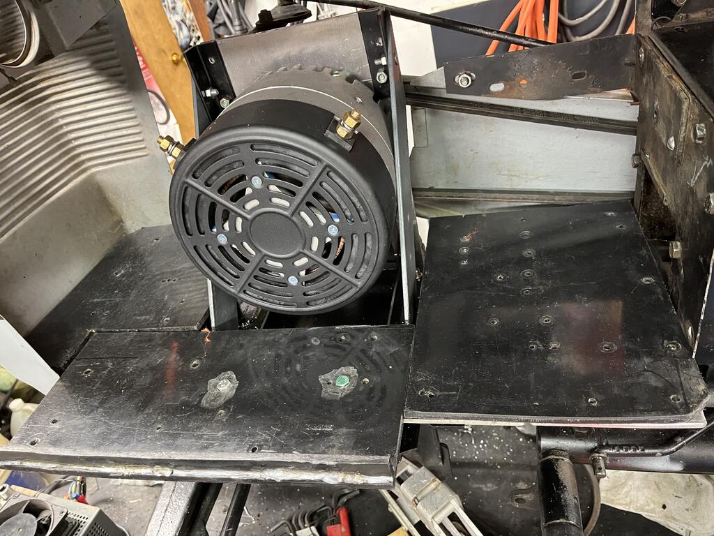

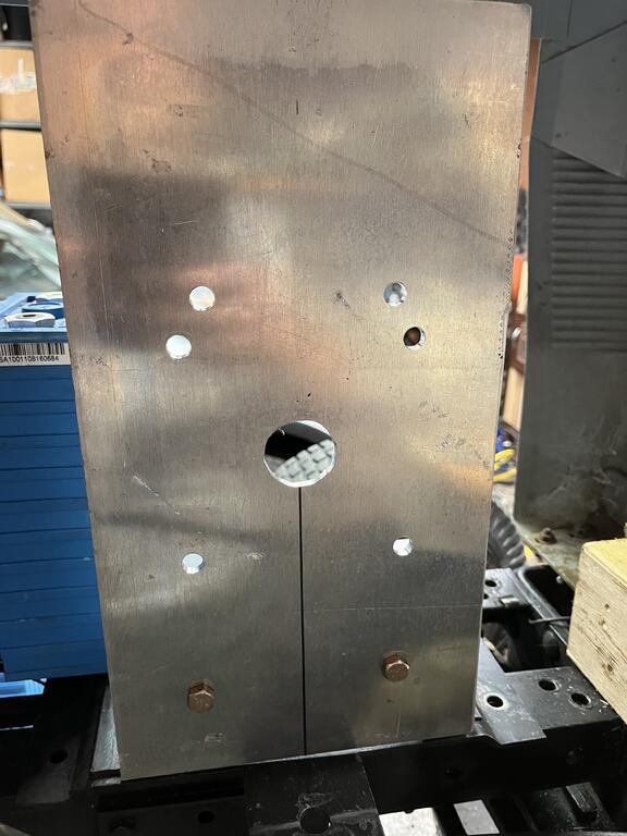

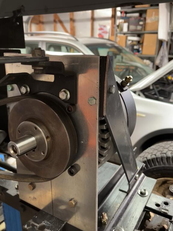

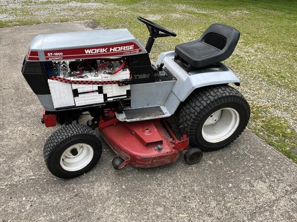

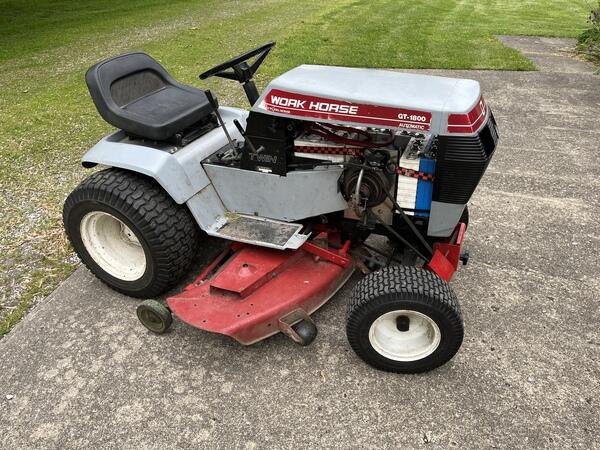

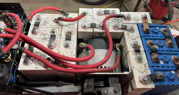

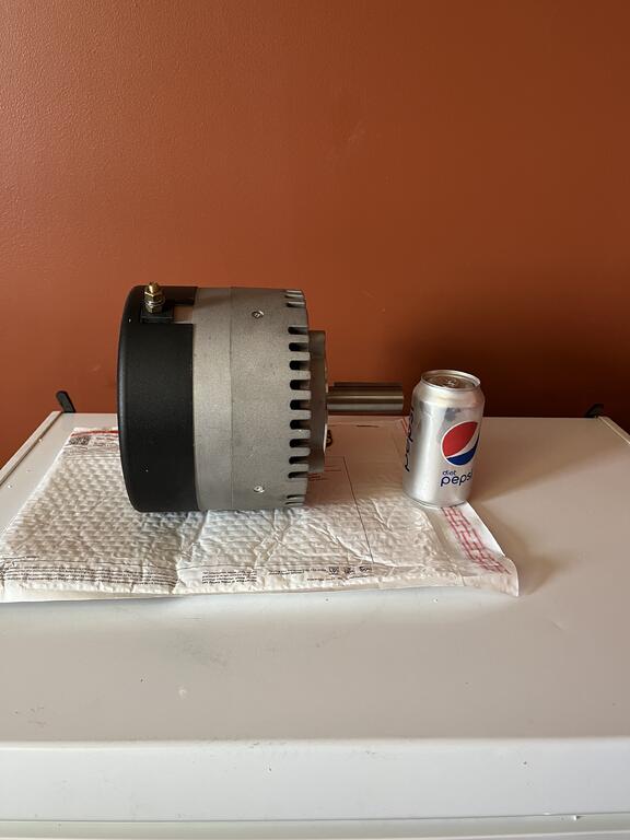

Evguy 567 #131 Posted September 1, 2022 Gt1800 workhorse to Electric power No horses were harmed in this conversation, original mounting holes were used, no cutting. While not for everyone, this is a conversion to battery electric power, using recycled batteries and electric parts. I used a permanent magnet motor sourced online, 11.5 continuous 14 peak. 3900rpm I took measurements and positioned the motor to match the broken engine I removed. I found a thrust bearing for PTO for using the original PTO. Control of motor is a contactor that provides power with no speed control. 1 8 1 Share this post Link to post Share on other sites

kpinnc 19,033 #134 Posted September 2, 2022 7 hours ago, Evguy said: 11.5 continuous 14 peak. 3900rpm That is sweet! Those extra RPMs should perk the mower deck up. Be sure to give us some details on the motor and batteries. I'm curious what kind of run time you get from that setup. 1 Share this post Link to post Share on other sites
Evguy 567 #135 Posted September 2, 2022 7 hours ago, kpinnc said: That is sweet! Those extra RPMs should perk the mower deck up. Be sure to give us some details on the motor and batteries. I'm curious what kind of run time you get from that setup. Here’s a link to the complete build. https://www.wheelhorseforum.com/index.php?app=core&module=system&controller=redirect&url=https://charginghorse.blogspot.com/?m=1&key=a87184f36942325c4806a2fe5c74852604fbe876ec1eb0703d17860ecd30d6d0&resource= 2 Share this post Link to post Share on other sites

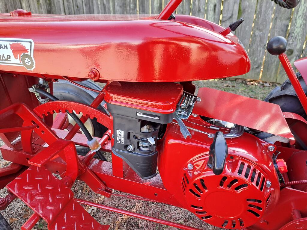

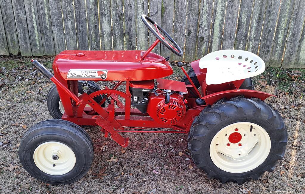

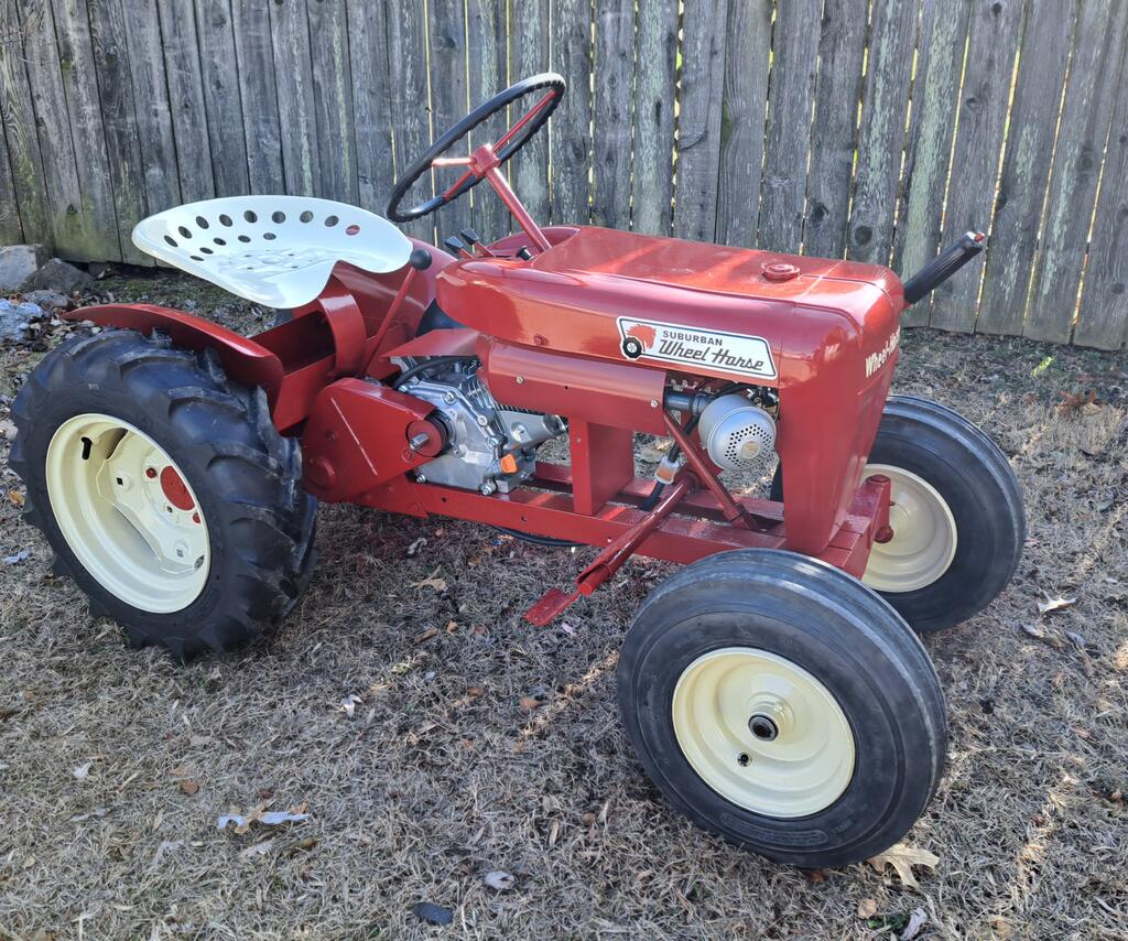

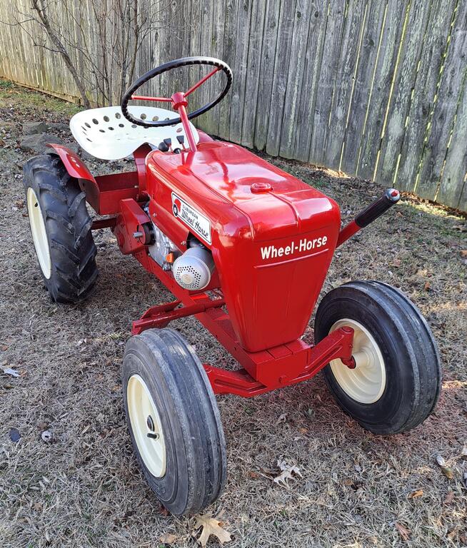

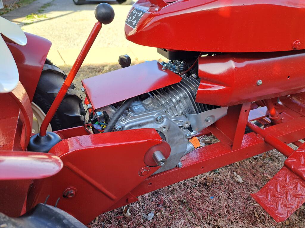

benjiboo 174 #140 Posted December 21, 2022 Here is my 1960 Suburban 400 repowered with a Predator 212 non-hemi version. After removing the factory tank and exhaust from the engine and modifying the stock air filter lid, the engine went right in without issue. The mounting bolt holes are spot on. The hole spacing for the stock belt guard was perfect. For the exhaust I used a stainless steel flange to 3/4" NPT adapter purchased from eBay to convert the exhaust from the stock two bolt flange type to NPT, the adapter also came with the muffler I used...was around $45. From there I just used standard black steel 3/4" NPT fittings and I believe a 12" section of pipe to get the exhaust to the front. I did have to use a 1" spacer between the exhaust pipe and clamping surface because the was a larger gap than with the original K91 engine exhaust. The exhaust shield I used is actually a reproduction unit purchased again from eBay for roughly $40. The stock airbox was modified by cutting off the top leaving the section that actually holds the filter in, and the using sheet metal sealed with black RTV then pop riveted to the stock filter top. This particular air filter draws its air from the bottom. I wanted a more factory looking filter box than using an exposed pod filter that would be affected by the elements. In place of the stock fuel tank I used sheet metal to cover the governor of the engine and to give a more factory appearance. Other than that I hooked up the fuel system and throttle cable. Nothing special or specific needed other than longer fuel line. This engine setup is smoother, more powerful and easier to start. 3 4 1 Share this post Link to post Share on other sites
benjiboo 174 #141 Posted December 21, 2022 More pictures.... 2 5 2 Share this post Link to post Share on other sites
