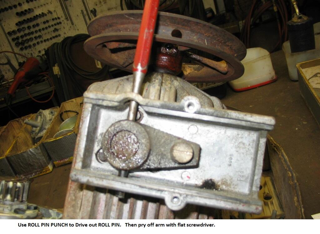

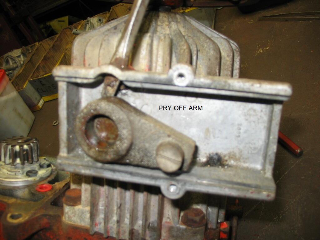

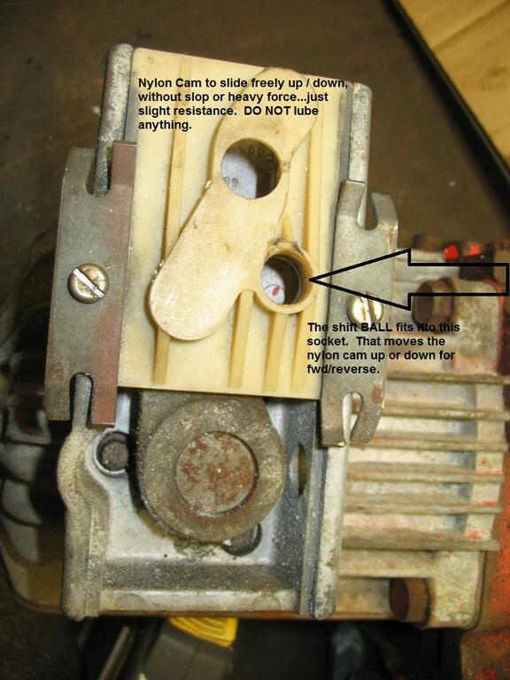

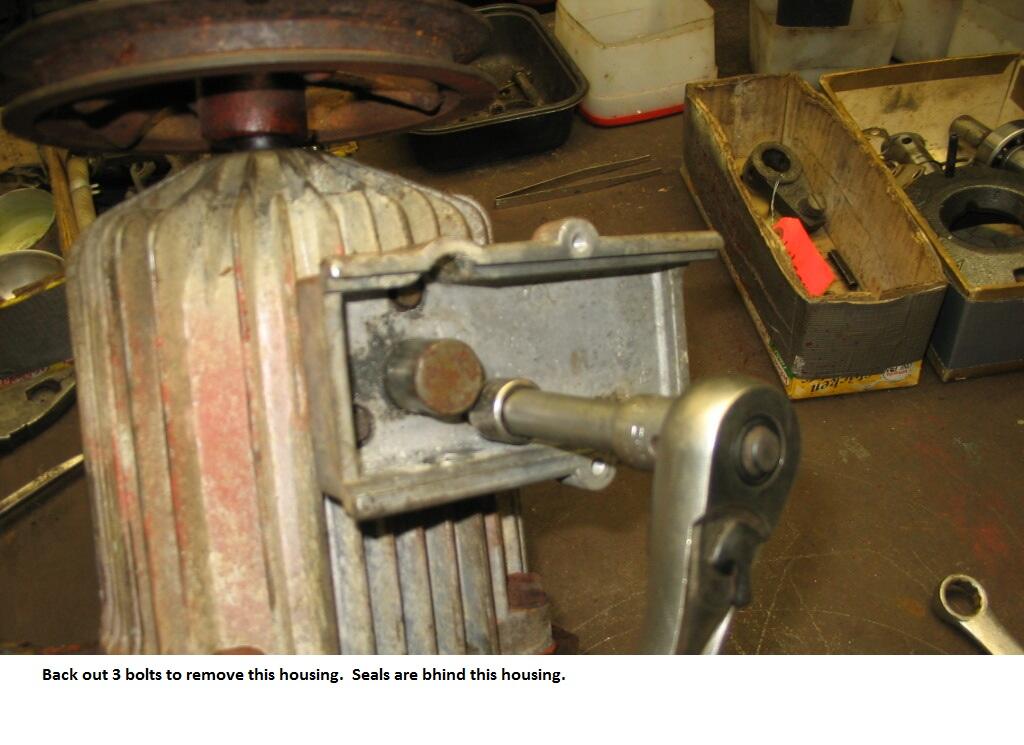

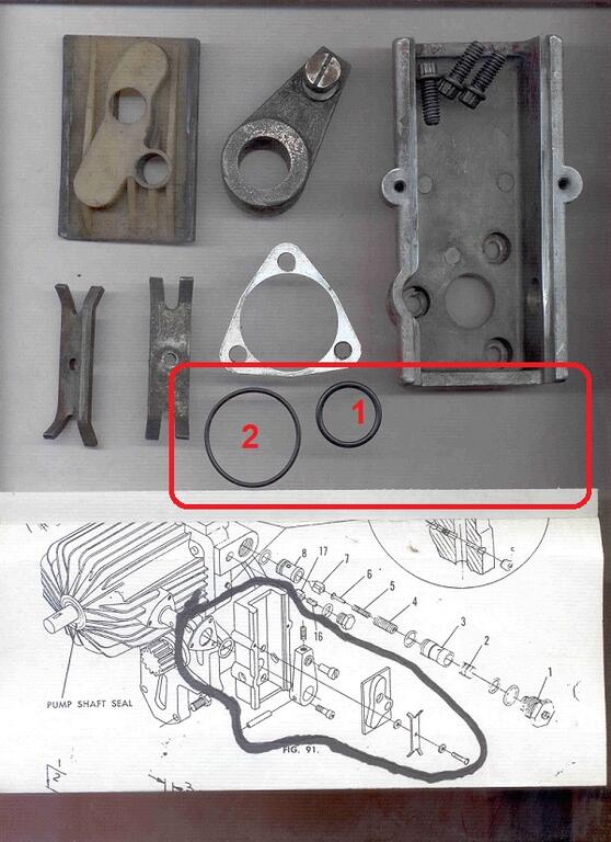

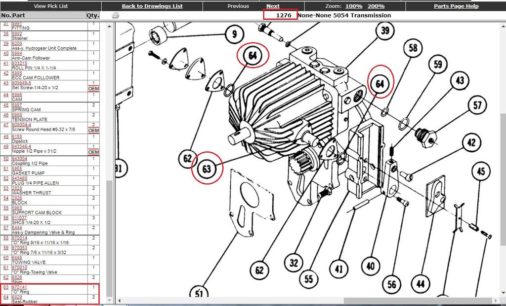

daveoman1966 3,884 #3 Posted June 4, 2022 (edited) I presume you mean the leak is frm behind the Nylon cam... If so, there are 2 O-rings behind that may be bad. Circled here as items 63 & 64 (2) The part#s are listed in the lower left corner. You MAY be able top do the O-ring/seal replacement withthout separating the pump from the tractor, but the latter makes it so much easier. Here is a pic or two to access to the O-ring & Seal Edited June 4, 2022 by daveoman1966 1 2 Share this post Link to post Share on other sites
pfrederi 20,831 #5 Posted June 4, 2022 The O rings are #116 and 026 (I use 026S the square profile is easier to keep in place) PM your address i will mail you 2. 2 Share this post Link to post Share on other sites
