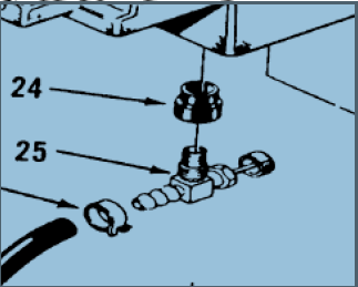

Craig-906 28 #1 Posted June 3, 2022 (edited) How does the fuel valve/strainer assemble together, and into the tank? I had to replace the fuel supply line and inline filter, while seating the line on the valve nipple it started to weep gas. It quickly stopped once the new line was seated. Is the valve supposed to swivel, or is it in fact loose from the tank? I have the exact valve as seen in the picture. Thanks! Edited June 3, 2022 by Craig-906 Share this post Link to post Share on other sites
JCM 11,164 #2 Posted June 3, 2022 It's okay if it swivels. 1 Share this post Link to post Share on other sites
8ntruck 8,938 #3 Posted June 3, 2022 I've never pulled one of these things apart, but I'll guess that the fuel valve is pressed into the grommet in the tank, it compresses the grommet enough to seal everything up. It probably remains loose enough to swivel, too. 4 Share this post Link to post Share on other sites
953 nut 66,541 #4 Posted June 3, 2022 If the valve was weeping gas it probably should be replaced. The gas tank grommet is probably not as pliable as it was a few decades ago. I would replace it and the valve just to be on the safe side. 5 1 Share this post Link to post Share on other sites
lynnmor 8,839 #5 Posted June 3, 2022 44 minutes ago, 953 nut said: If the valve was weeping gas it probably should be replaced. The gas tank grommet is probably not as pliable as it was a few decades ago. I would replace it and the valve just to be on the safe side. Yes, it is time to replace it. There may be a screen on the petcock as well and it could be clogged. If it has no screen, you might want to buy that type. It would be a good time to flush the tank, often there is plenty of debris in there. 2 1 Share this post Link to post Share on other sites

peter lena 9,898 #7 Posted June 3, 2022 @Craig-906 that valve replacement and grommet seating is easily helped using dielectric grease , also just a touch on the male end of the hose connection makes hose replacement easy . that grommet is easily replaced into the tank , after cleaning it out , the grease is made to assist fitting dissimilar parts , like rubber to plastic , and fuel fitting barbs into rubber and vinyl hose . I added a large fuel filter in the rear under seat frame area , an another small filter closer to carb . install spring clamps on hose away from finish area . once hose is installed . lineman's plyers , makes the finish slide easy . @lynnmor is correct on tank clean up time , did my 3 tanks , no issues or leaks , pete 1 Share this post Link to post Share on other sites
