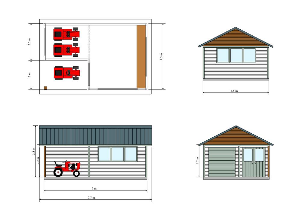

Dan.gerous 2,696 #15 Posted June 5, 2022 Here is my first idea. It isn't just a simple box as I wanted a bit of style and a covered in outdoor work area which would be handy on a wet day if you needed to be doing lots of dusty or smoky work. Forgot to add a wood stove, but I will be sourcing one free from somewhere! 3 Share this post Link to post Share on other sites
ebinmaine 81,289 #16 Posted June 5, 2022 5 hours ago, Dan.gerous said: Forgot to add a wood stove, but I will be sourcing one free from somewhere Something you'd build? Or rather get a factory done unit? 1 Share this post Link to post Share on other sites
ebinmaine 81,289 #17 Posted June 5, 2022 5 hours ago, Dan.gerous said: covered in outdoor work area Nice idea 1 Share this post Link to post Share on other sites
Dan.gerous 2,696 #18 Posted June 5, 2022 2 hours ago, ebinmaine said: Something you'd build? Or rather get a factory done unit? Just build it myself, probably knock down some woiden garages in the city and use the components. They are usually free and by the time I'm done nobody would guess. 1 1 Share this post Link to post Share on other sites
Dan.gerous 2,696 #19 Posted June 5, 2022 2 hours ago, ebinmaine said: Nice idea I think it would work well, and oversize material wouldn't get wet while you were cutting to size. Needs enough room to build the FEL etc probably dedicate it to metalwork and do any woodwork outside on nice days. 2 Share this post Link to post Share on other sites
ebinmaine 81,289 #20 Posted June 5, 2022 7 minutes ago, Dan.gerous said: Needs enough room ******* dedicate ***** metalwork ****** woodwork We're intending to separate our two workshop areas here as well. Keeps the grease outta the wood products and Sawdust outta the greasy stuff. IMHO adds a safety factor by keeping more flammables combustibles burnables away from the welding/metal work section. 1 2 Share this post Link to post Share on other sites
Dan.gerous 2,696 #21 Posted June 5, 2022 2 hours ago, ebinmaine said: We're intending to separate our two workshop areas here as well. Keeps the grease outta the wood products and Sawdust outta the greasy stuff. IMHO adds a safety factor by keeping more flammables combustibles burnables away from the welding/metal work section. I highly recommend it, that's what we did at our current place. It makes everything so much easier, sawdust no longer inside everything and grease no longer getting on freshly sanded wood. The safety aspect alone, it's amazing how far sparks fly while cutting metal! 1 Share this post Link to post Share on other sites
