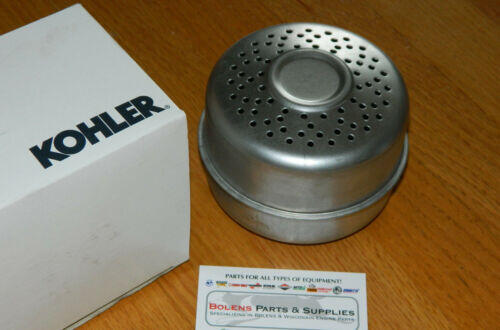

ri702bill 13,084 #81 Posted August 9, 2022 13 hours ago, dmoore said: So do you know of an an NOS piece??? Not at this time - P/N 234015 is NLA, discontinued a long way back ... Picture below for reference. 1 Share this post Link to post Share on other sites

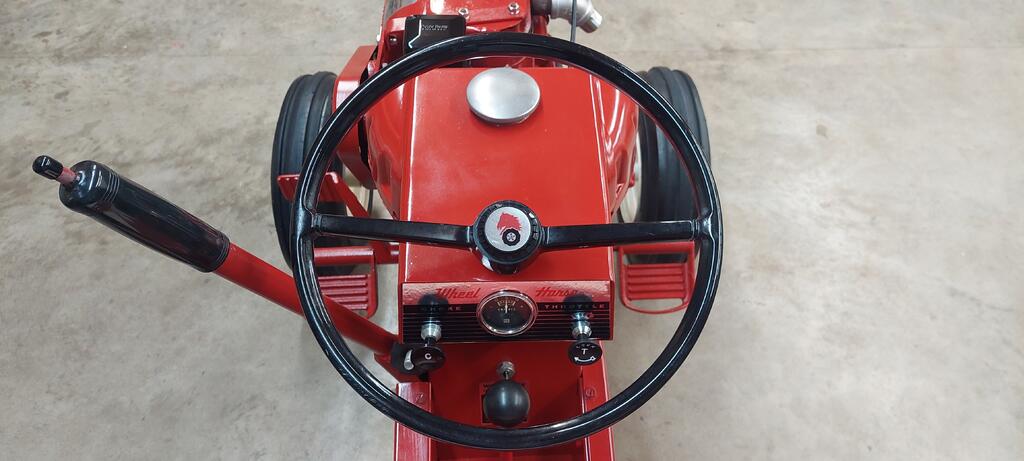

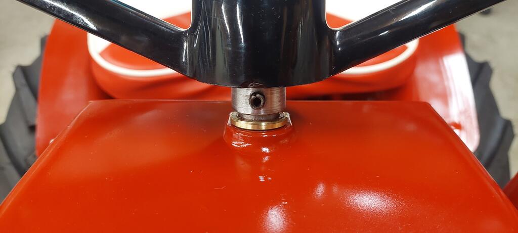

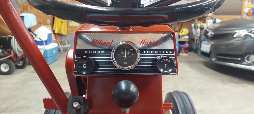

dmoore 1,042 #86 Posted August 16, 2022 I haven't had much time lately to finish up this 854 so tonight I snuck out to the garage and installed the key switch and all associated wiring. Then moved on to the steering shaft, bushing & wheel followed by choke & throttle cables. 5 Share this post Link to post Share on other sites

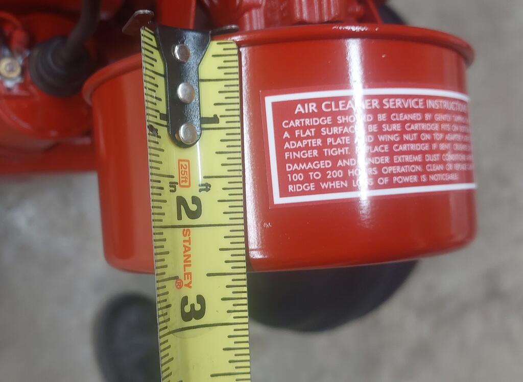

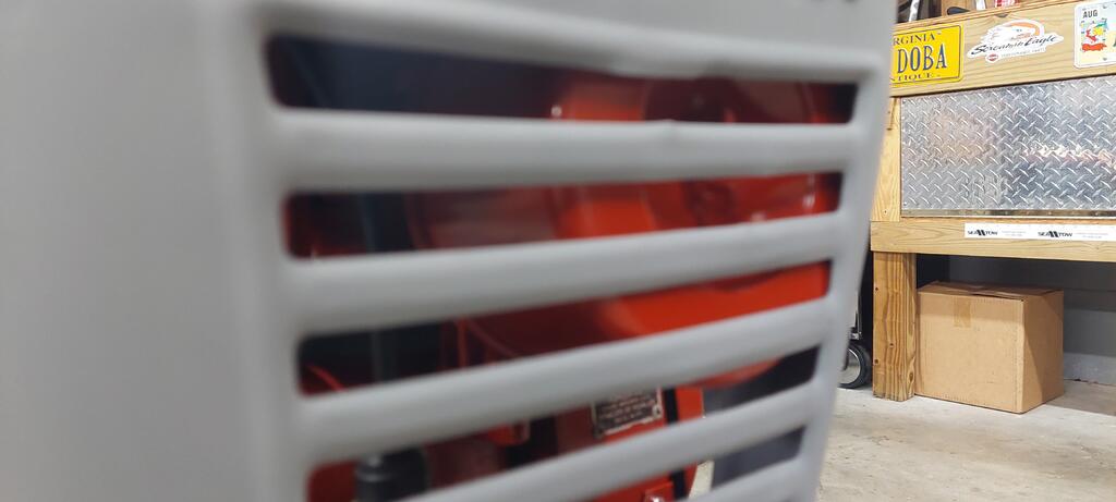

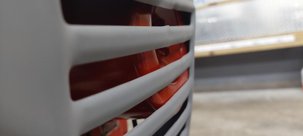

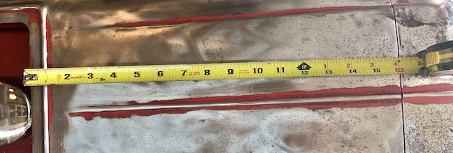

dmoore 1,042 #87 Posted August 16, 2022 (edited) I had bead blasted the hood over the weekend and started on smoothing it out some. Test fit it tonight. Little more work to do. Question, should the grill be in contact with the air cleaner housing? Edited August 16, 2022 by dmoore 1 Share this post Link to post Share on other sites
ineedanother 2,871 #88 Posted August 16, 2022 I've been watching your resto and it looks great. Motivational in fact. To answer your question...no. Others will likely chime in with NOE recommendations but air cleaner housings from what I have here are either 2" or 3" in depth. Yours looks to be 3" and a 2" should be stock with that hood and power plant. 1 Share this post Link to post Share on other sites
dmoore 1,042 #89 Posted August 16, 2022 And since I have convinced myself I will not find an original shower head muffler I ordered this genuine Kohler muffler off Ebay. At least it's made here. 2 Share this post Link to post Share on other sites
dmoore 1,042 #90 Posted August 16, 2022 2 minutes ago, ineedanother said: I've been watching your resto and it looks great. Motivational in fact. To answer your question...no. Others will likely chime in with NOE recommendations but air cleaner housings from what I have here are either 2" or 3" in depth. Yours looks to be 3" and a 2" should be stock with that hood and power plant. That's what I need to know. I thought as much. Thank you. 1 Share this post Link to post Share on other sites

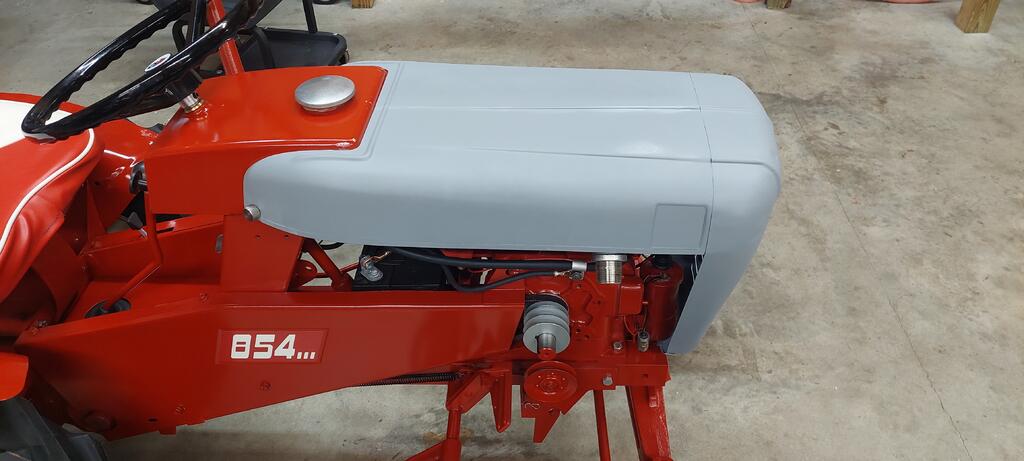

Handy Don 17,484 #91 Posted August 16, 2022 (edited) 12 hours ago, ineedanother said: Tanswer your question...no. Others will likely chime in with NOE recommendations but air cleaner housings from what I have here are either 2" or 3" in depth. Yours looks to be 3" and a 2" should be stock with that hood and power plant. @dmoore Correct that the air cleaner housing should not contact the hood--but it will be mighty close! However, the 3" is correct for the 854 (the 2" can be fitted but will noticeably restrict airflow to the engine). To accommodate the extra length, 854's had a unique hood that is 1" longer than its sibling 500's and 700's. It measures 16" from the edge of the cut in front of the fuel tank to the seam. If yours is less than that, you don't have a 854 hood. You needn't ask how I (frustratingly) learned this. Edited August 16, 2022 by Handy Don 1 Share this post Link to post Share on other sites
dmoore 1,042 #92 Posted August 16, 2022 I thought that was the right air cleaner every other 854 I've seen has had the same one. Interesting tidbit on the 854 Hood only I will measure that. Share this post Link to post Share on other sites
dmoore 1,042 #93 Posted August 16, 2022 Mine is 2.5" Share this post Link to post Share on other sites
Handy Don 17,484 #94 Posted August 16, 2022 4 hours ago, dmoore said: Mine is 2.5" Yours is correct. 3" is when measured from the face of the carburetor. This is an 854 hood in prep for painting. 1 Share this post Link to post Share on other sites
dmoore 1,042 #95 Posted August 17, 2022 I thought so. Thanks. I will take that measurement on mine. Share this post Link to post Share on other sites
