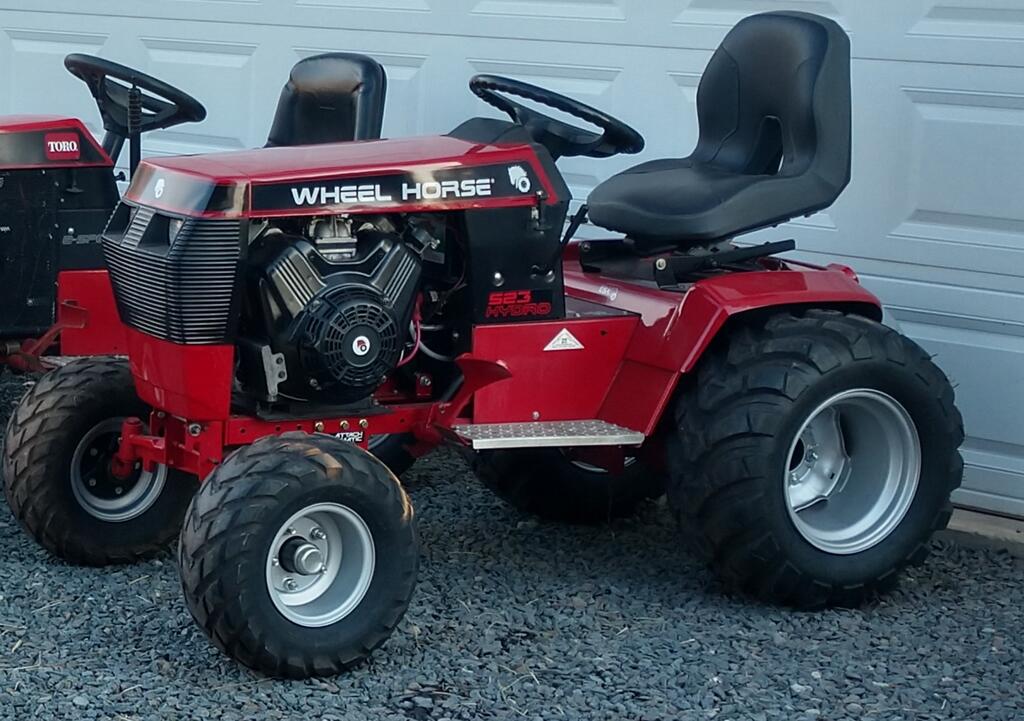

kpinnc 19,033 #4 Posted June 1, 2022 I love Vanguards. One of the few engines (horizontal shaft only) that still use ball bearings on the PTO side of the crank. I have several v-twins from 14 to 23 hp. Good solid performers. You will have to make a 3/4 mounting plate to get the PTO shaft to the correct height. They have a different bolt pattern too, but the mounting plate can correct it. 4 6 Share this post Link to post Share on other sites

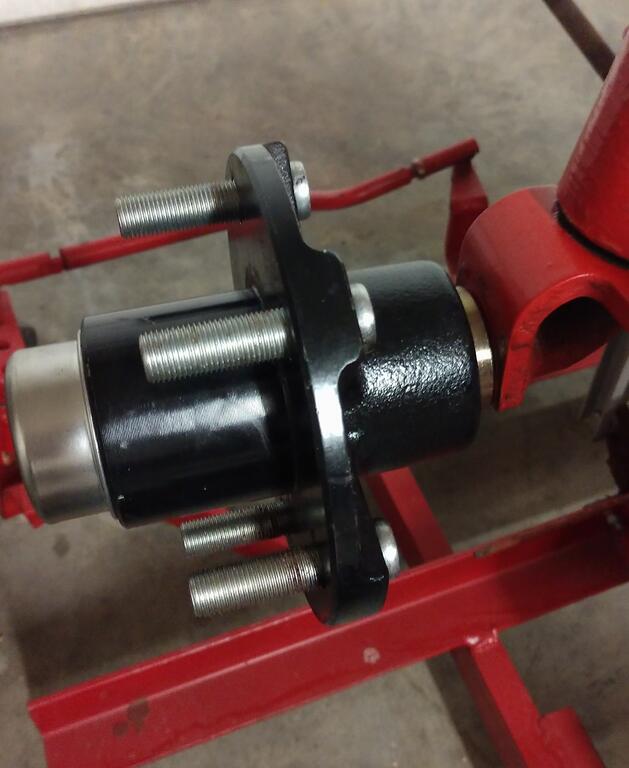

Horse Newbie 7,405 #5 Posted June 1, 2022 @kpinnc so you did a trailer hub swap on the front wheels/ spindles ? Share this post Link to post Share on other sites

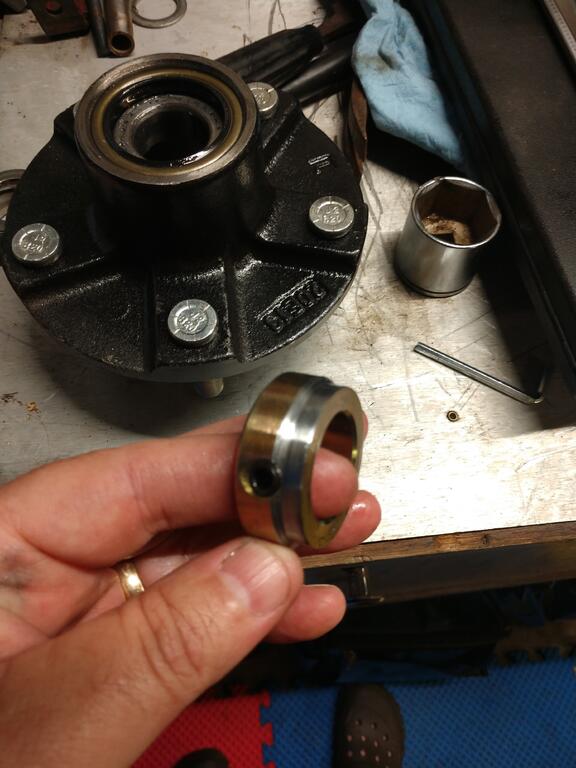

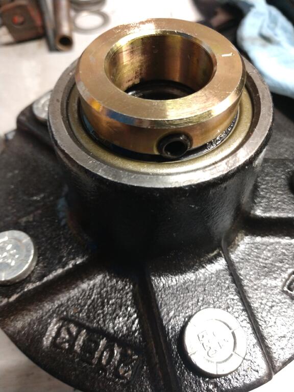

kpinnc 19,033 #6 Posted June 1, 2022 1 hour ago, Horse Newbie said: @kpinnc so you did a trailer hub swap on the front wheels/ spindles ? Yes sir. That was the only way to get those bigger front tires to look right, at least look right to me anyway. The wheels were over an inch wider than stock 520 wheels. I turned 1 inch locking collars down to the same size as the inner hub seals to make them work right. 1 2 Share this post Link to post Share on other sites
Horse Newbie 7,405 #7 Posted June 1, 2022 @kpinnc… where did you get the hubs ?… Northern Tool ? Share this post Link to post Share on other sites
kpinnc 19,033 #8 Posted June 2, 2022 1 hour ago, Horse Newbie said: Northern Tool ? Yes sir. 5 on 4.5. 1 Share this post Link to post Share on other sites

Horse Newbie 7,405 #10 Posted June 4, 2022 On 6/1/2022 at 8:38 PM, kpinnc said: Yes sir. 5 on 4.5. 5 inch on a 4.5 inch spindle ?… naw I’m kidding… 5 lugs on a 4.5 inch pattern… 1 Share this post Link to post Share on other sites

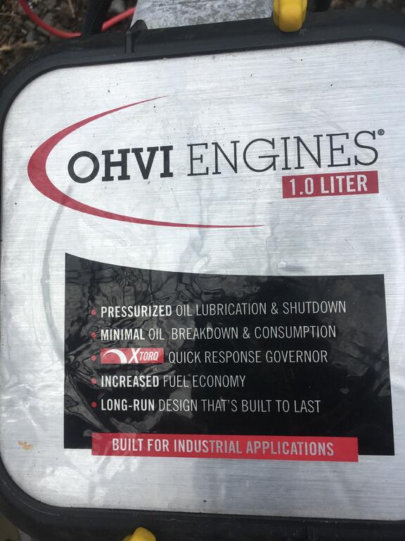

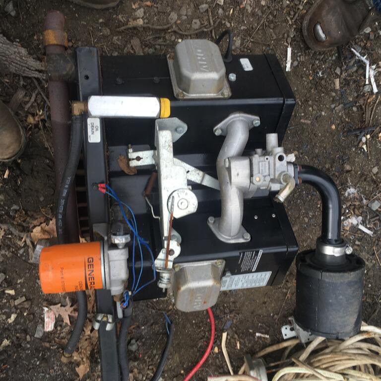

Jrain 276 #13 Posted June 10, 2022 I have 3 B&S V twins laying around pulled them from Generac generators ,all have very low hours on them also have 2 1.2 inline Nissan engines also pulled from Generac , keep pulling them but never use them. 1 1 Share this post Link to post Share on other sites

RED-Z06 2,720 #15 Posted June 15, 2022 On 6/9/2022 at 10:59 PM, Jrain said: I have 3 B&S V twins laying around pulled them from Generac generators ,all have very low hours on them also have 2 1.2 inline Nissan engines also pulled from Generac , keep pulling them but never use them. That ohvi 1liter twin has been the bane of my existence, after a hurricane im inundated with calls from people explaining their generator just blew up in epic fashion...always the same story, ran fine...blew up, or let go on start up. The electronic servo controlled governor is too laggy, ive seen them hit 4800 on cold start before the governor could react...i always push the choke in nice and slow...gives it time. Mechanically a fantastic engine, but seeing a line of Guardian 15,000/22,500 units with rods hanging out was miserable..all because they didnt want to use a tried and trued Mechanical governor Share this post Link to post Share on other sites
