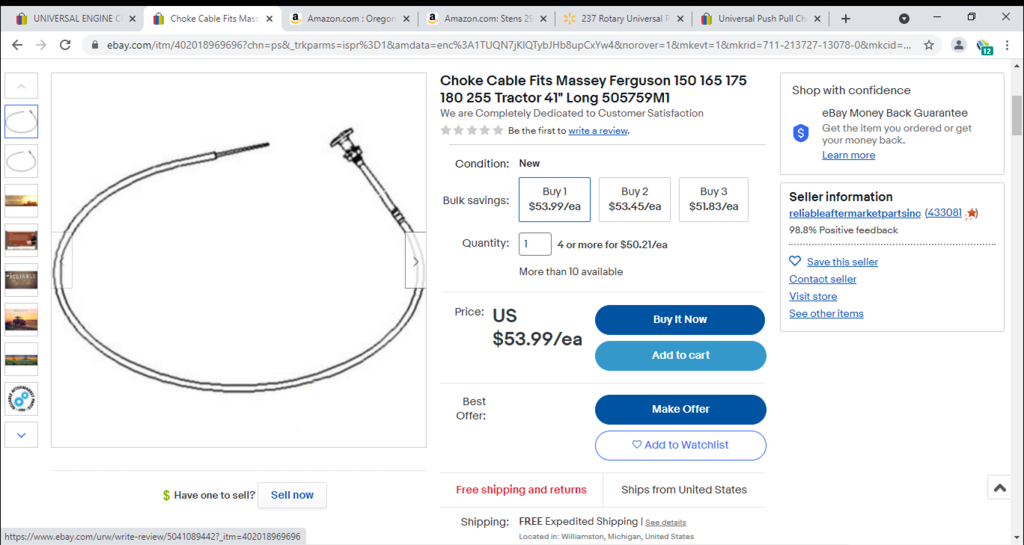

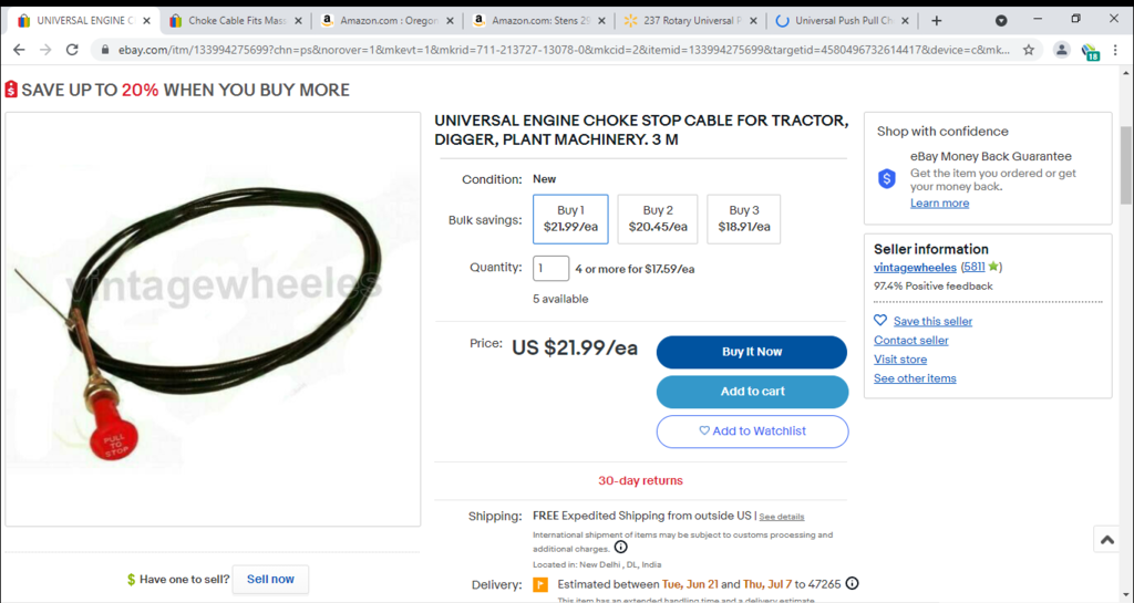

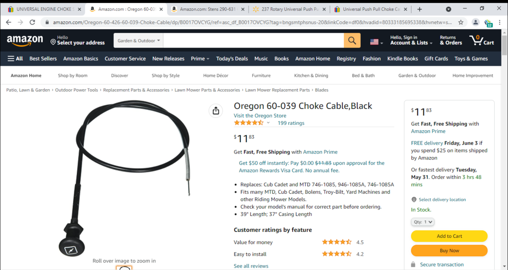

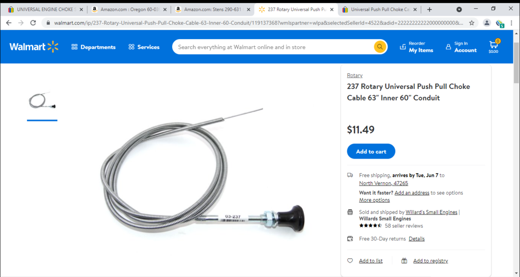

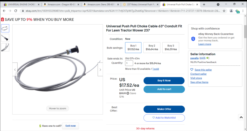

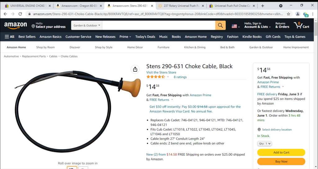

Snoopy11 5,720 #3 Posted May 29, 2022 I personally recommend either of these: Don Share this post Link to post Share on other sites

peter lena 9,457 #5 Posted May 29, 2022 @Snoopy11 , good pick on those cables , snoop, good back up , super lube , pete 1 Share this post Link to post Share on other sites
Snoopy11 5,720 #6 Posted May 29, 2022 1 minute ago, peter lena said: super lube Excellent advice. Those new cables may not come with any type of lubricant... and you definitely don't want any corrosion getting in there!!! @peter lena Don 1 Share this post Link to post Share on other sites

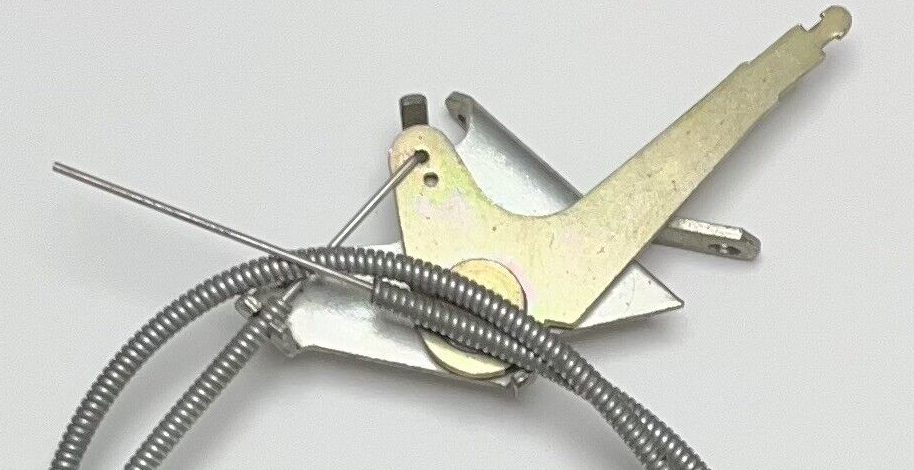

Mike C160 251 #7 Posted May 29, 2022 @Snoopy11 So just cut the ends off and pinch them back onto the factory lever? Seems easy enough. I dont wish to ditch the factory lever system. 1 1 Share this post Link to post Share on other sites
Snoopy11 5,720 #8 Posted May 29, 2022 3 minutes ago, Mike C160 said: So just cut the ends off and pinch them back onto the factory lever? Pretty much... yes. Again, I specifically recommend the last 2 cables that I mentioned, but buy what you wish... Don 1 Share this post Link to post Share on other sites
