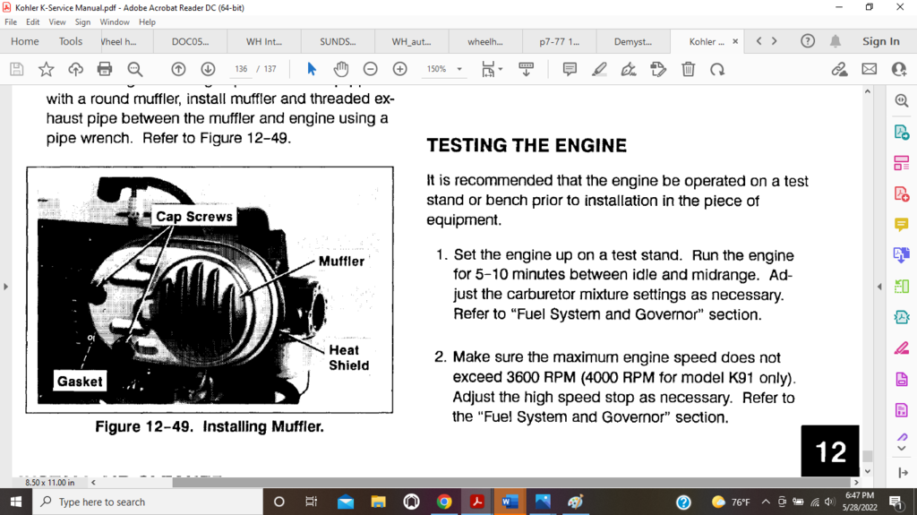

953 nut 67,477 #10 Posted May 28, 2022 9 hours ago, moe1965 said: Just wondering what is recommended for a break in run time if any at all. According to the Kohler Service manual 5 or 10 minutes is good. Share this post Link to post Share on other sites
