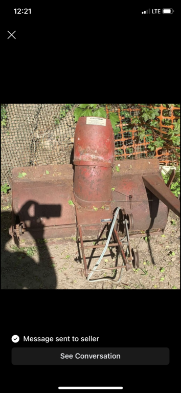

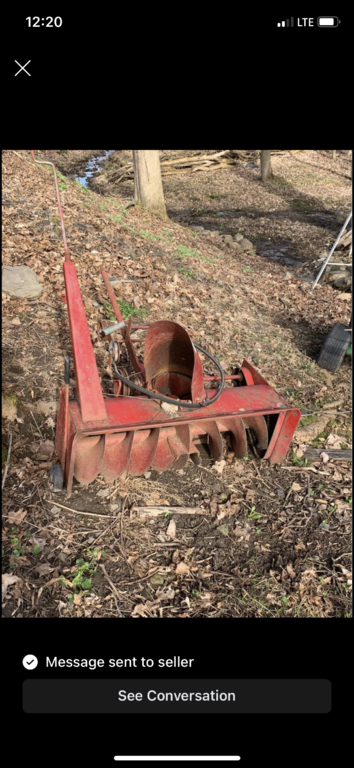

JerryLook 84 #1 Posted May 27, 2022 Obviously I have a bit of time until I’ll need it again, but I’m looking for a snowblower attachment for my 416-H. Ive noticed that most of the wheel horse snowblowers I see used are 36” wide. I measured the front end on my 416-H and C-105. The 416-H (with 6” rims) measures 34” wide, and the C-105 (with 8” rims, that might be going on the 416-H) measures 36” wide. So I would assume the ideal snowblower would be at least as wide as the front end. So will a 36” snowblower work well for my 416-H? Any models I should avoid? Single stage or 2 stage? These are some I’m looking at. Share this post Link to post Share on other sites

peter lena 9,870 #3 Posted May 27, 2022 @JerryLook jerry that picture is a single stage , 36 x 42 , with the SIDE CUTTERS attached . note you live in upstate ny , get a lot of snow ? what type of snow , light and fluffy or wet and crusty , wet snow favors a 42 " dozer blade , lighter snow is easily handled with that single stage , but a double stage with your 16 hp would be the deal in deep snow . your 16 will handle and mount either blower . look on site for reference . looking at blower , that auger looks pretty good , with no heavy bends or damage , usually neglected for , auger chain lubrication and neglect , also note how auger chute swivels , those side wheels can be change to sliders. actually its a good time to hunt down a blower . get one and get it all set up for use, pete Share this post Link to post Share on other sites

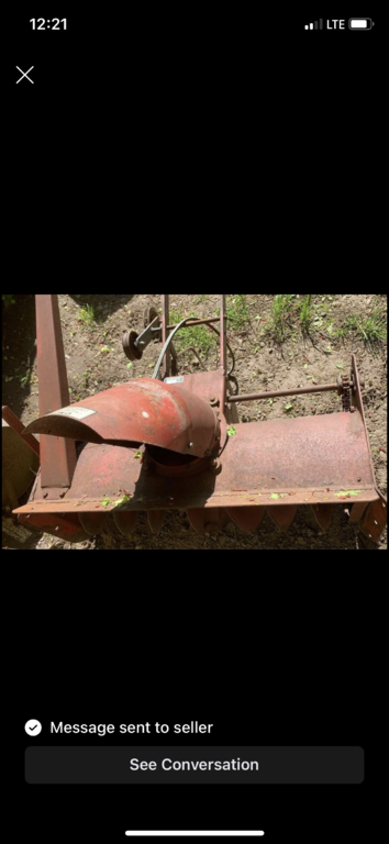

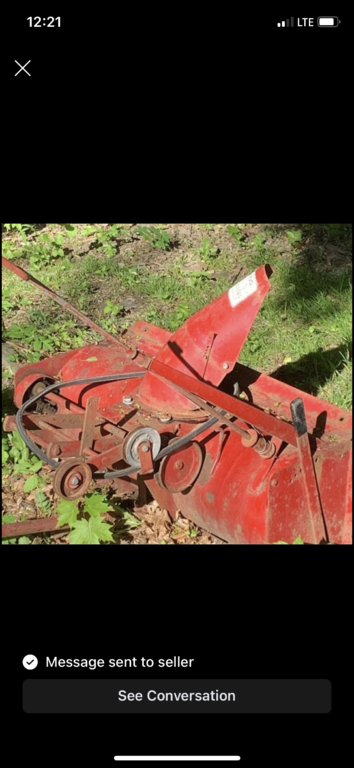

JerryLook 84 #4 Posted May 27, 2022 (edited) Thanks for the info Pete. The snowblowers pictured above are two different units. The seller wants 50$ for the older looking one and 100$ for the other. I’m supposed to go look at them in the morning. I’ll try to spin the auger, and see if the chute moves freely back and forth. I have no info on when they were last used, but I’ll find out tomorrow. We have all kinds of snow here. I’m on the edge of the tug hill plateau, which gets very heavy snowfall. Although it has been getting less and less in later years. I just wanted to make sure the 36” wide snowblower is what I need. I’m supposed to be getting one from the person I got the 416 from, but it’s at his ex wife’s house, and who know if and when that will work out. So I’m looking to pick up one when prices are cheap. Thanks for your help. Edited May 27, 2022 by JerryLook It censored a word for some reason. Interesting 2 Share this post Link to post Share on other sites
Handy Don 16,479 #5 Posted May 27, 2022 (edited) The blowers that work on the 416 will ALL have a solid, welded-in, ⅝" rod at the end of the mounting bracket that goes into the front attach-a-matic hitch. Older (and not compatible) models have a removable ½" rod held in with R-clips. Edited May 27, 2022 by Handy Don Share this post Link to post Share on other sites
JerryLook 84 #6 Posted May 27, 2022 Ok good to know. Is there a way to tell by the pics which one these blowers have? Share this post Link to post Share on other sites
JerryLook 84 #7 Posted May 27, 2022 If I’m looking at the right rod it looks like the one in the top pic is welded in and the bottom pic is removable. 1 Share this post Link to post Share on other sites

JerryLook 84 #13 Posted May 28, 2022 Looking at the two snowblowers I posted, I take it the brighter red one has a short chute and the faded one has the tall chute you mentioned? Yes we get tons of lake affect snow here. I’m about 12 miles from Lake Ontario Share this post Link to post Share on other sites
roadapples 6,987 #14 Posted May 28, 2022 Both pictures are short chute blowers. On your post number 19, the second picture is the older style... Share this post Link to post Share on other sites
JerryLook 84 #15 Posted May 28, 2022 1 hour ago, roadapples said: Both pictures are short chute blowers. On your post number 19, the second picture is the older style... The older style as far as the mounting system that won’t work with my 416? Share this post Link to post Share on other sites
roadapples 6,987 #16 Posted May 28, 2022 8 minutes ago, JerryLook said: The older style as far as the mounting system that won’t work with my 416? Not sure if the older style will bolt up to your tractor or not. The newer style hooks up directly to the front attach-amatic... 1 Share this post Link to post Share on other sites
Cee245 853 #17 Posted May 28, 2022 As @roadapplessays, they are both short chute blowers. And I don't know if the older style bolts up either. If each bolt up...(the newer style will)...They are fine, but I like 42" tall chute blowers. These look a little more narrow, but they are basically all the same, except the larger wings that make 36" into 42" cutting width. 1 Share this post Link to post Share on other sites
Handy Don 16,479 #18 Posted May 28, 2022 Second one will not fit neatly. Bracket is longer, rod is too thin, and lift rod is not the right length. Share this post Link to post Share on other sites
