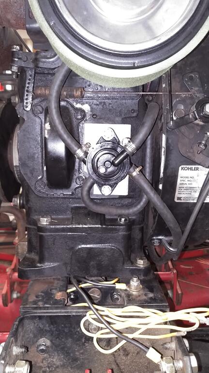

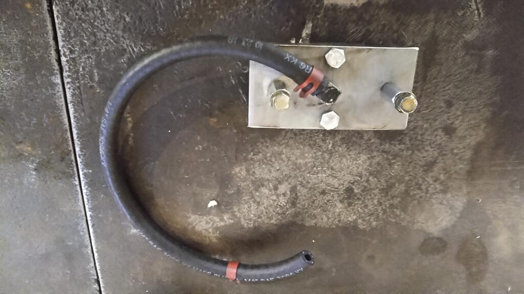

Bill D 3,101 #10 Posted May 27, 2022 I made a mounting plate and mounted an impulse pump. Works great. Use OEM Briggs or Kawasaki pumps, not cheap knock offs. Less risk of failure and gas in the crankcase. Pump in the pic is a Kawasaki. 2 Share this post Link to post Share on other sites
