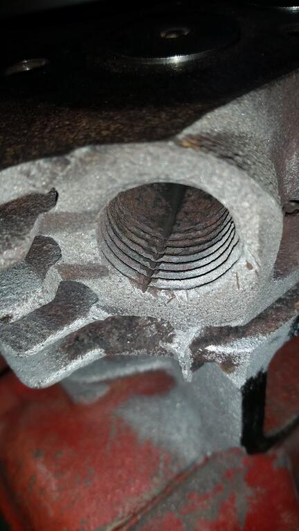

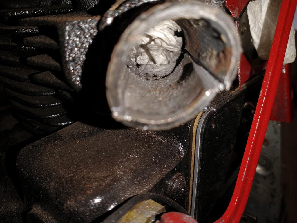

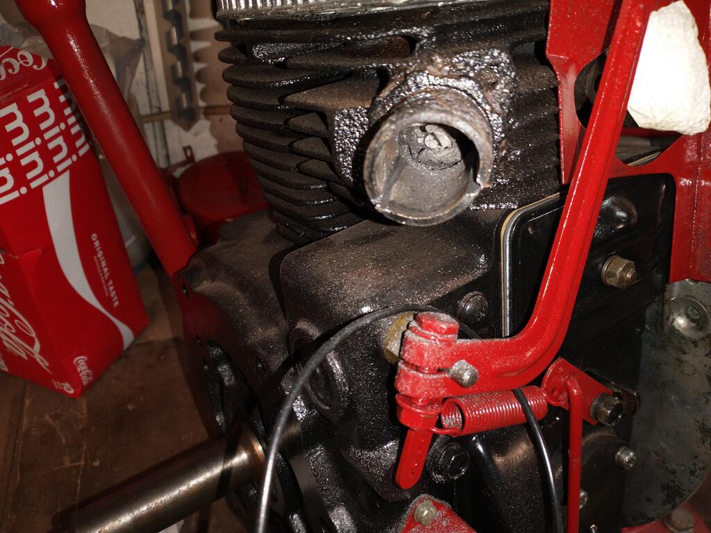

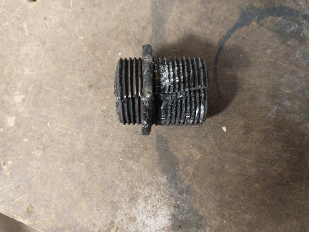

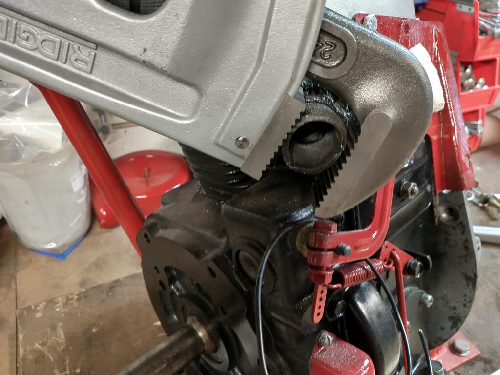

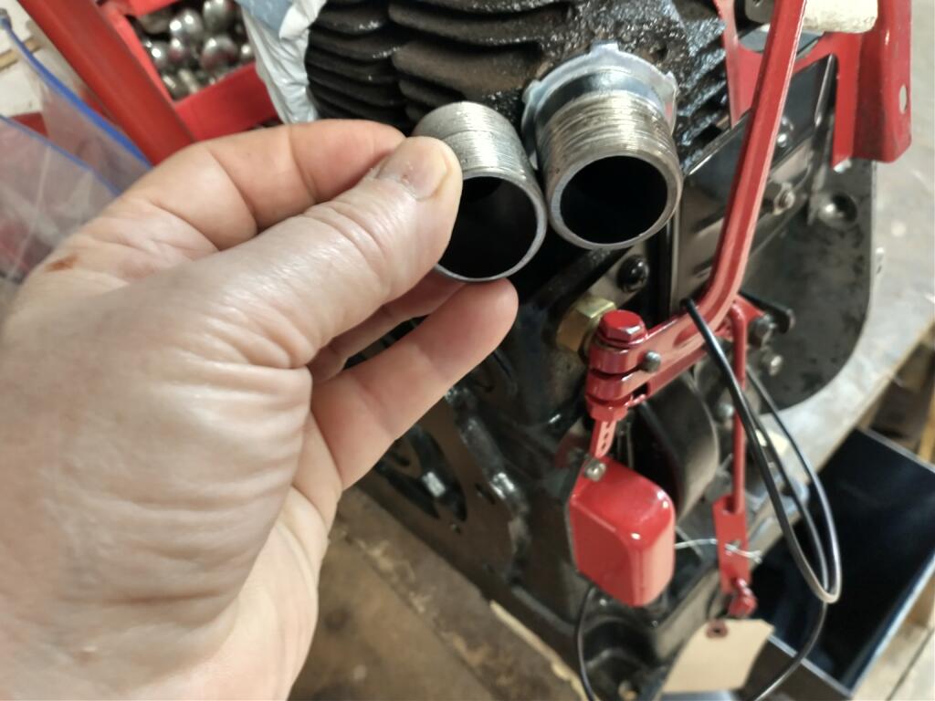

squonk 47,421 #8 Posted May 24, 2022 (edited) This nipple didn't look bad but a new elbow wouldn't start on it and it was marked up. Glad I changed it as it wasn't in very far and I found evidence a nipple had been cut out before. Just did this Saturday Stick a paper towel into the port. Leave the nipple long enough for a pipe wrench. Cut 2 slots just about through. Vacuum frequently. Pipe wrench will collapse nipple and it will either turn out or fall out. After removing paper towel. Vacuum out the hole. Then I used some large swabs with garb and brake cleaner to clean out the port. Edited May 24, 2022 by squonk 8 Share this post Link to post Share on other sites

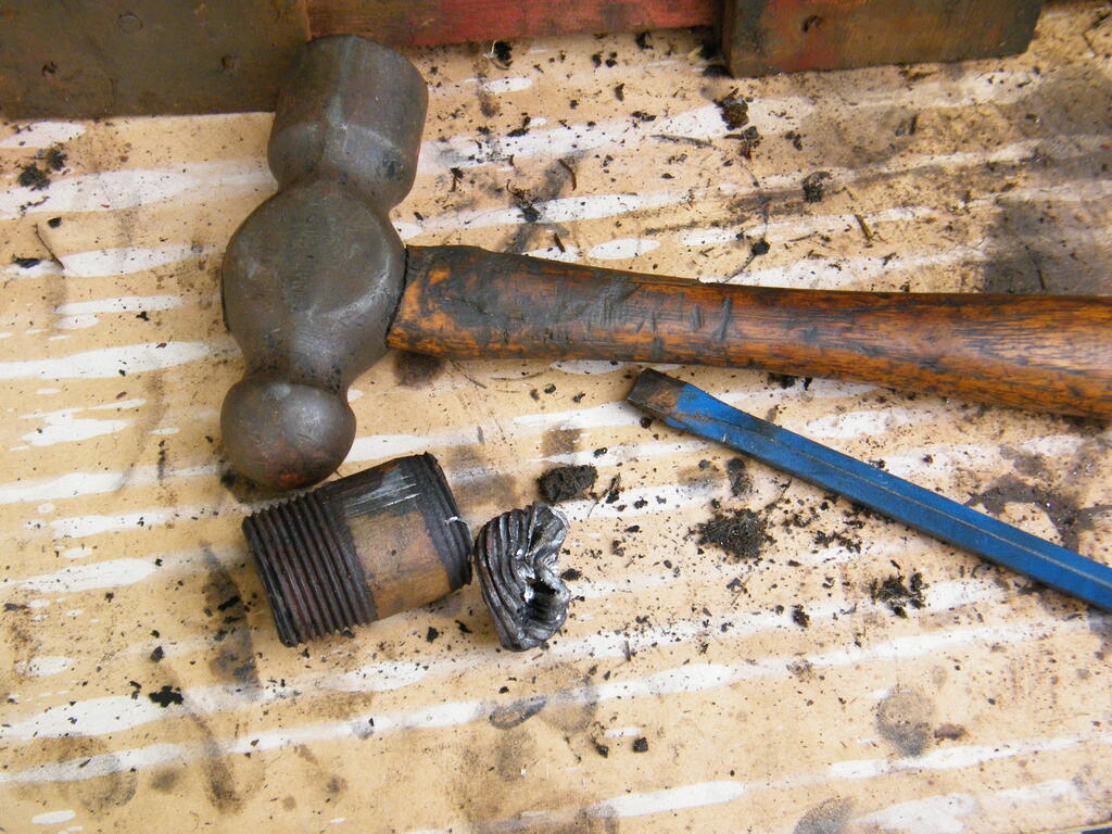

stevasaurus 23,746 #9 Posted May 24, 2022 If you are not comfortable hacksawing a groove in the nipple, you do not have to. You can just cut the nipple off short (leave 1/4") and use a cold chisel and ball peen hammer to collapse the threads. Once you get it started, it will loosen and you can turn it out. Here is the proof. 5 1 Share this post Link to post Share on other sites

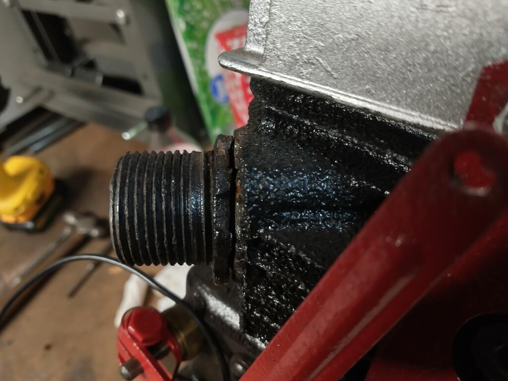

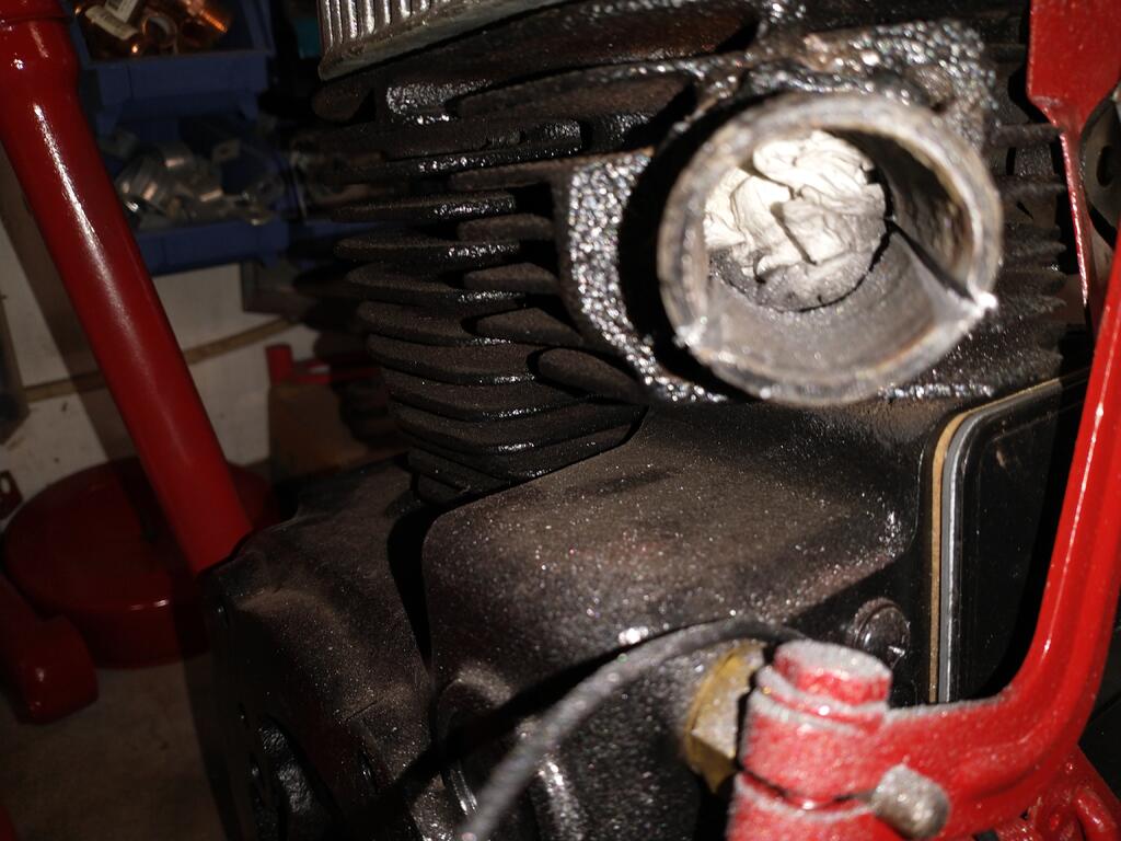

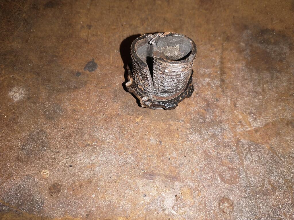

Mike C160 251 #19 Posted May 26, 2022 Well, I finally got up the steam to get this one done. It was one of those jobs you walk a circle around of about 20 feet for a while as it seems like it was going to be an "ordeal" I am happy to say the cut and cave method worked great. I cut it open up to the block adapter then only a small slice in the hole. I didnt get into the threads of the block adapter. However the nipple was so brittle from age and heat, it collapsed without a fight at all and it pretty much fell right outta there. Its done. Phew. Wasnt the "ordeal" I thought it would be. 5 4 Share this post Link to post Share on other sites
