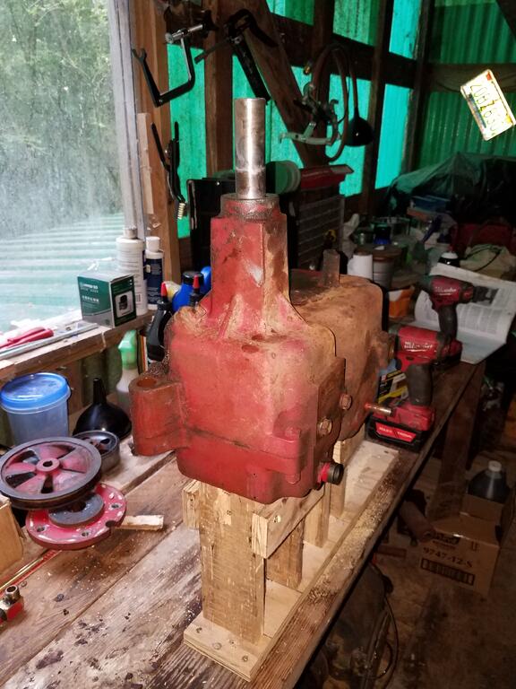

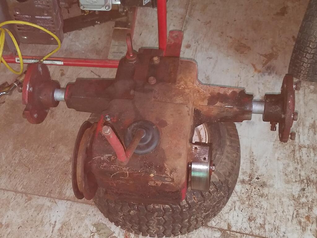

tntatro 181 #10 Posted May 22, 2022 I threw together a stand made from scrap wood. 3 Share this post Link to post Share on other sites
Handy Don 16,288 #11 Posted May 22, 2022 18 minutes ago, tntatro said: I threw together a stand made from scrap wood. Hubs are off so you are already over the hump! Share this post Link to post Share on other sites

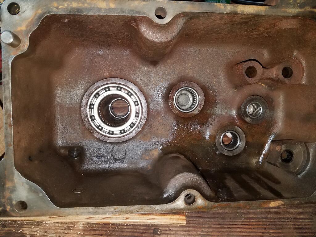

tntatro 181 #13 Posted May 22, 2022 I got it apart, it was really hard to get it into 2nd to get the gears out but I managed. The bearings don't look rusty but one 1533 bearing is pretty sloppy and the other is a little loose. I haven't cleaned it up yet but so far it looks like one needle bearing has a little rust on it. I don't know what was causing the noise though. I wish Wheel Horse had used a heavier and more common bearing for the differential. I have a couple used 1533's that are better than the ones in this but are a little loose also. 1 Share this post Link to post Share on other sites

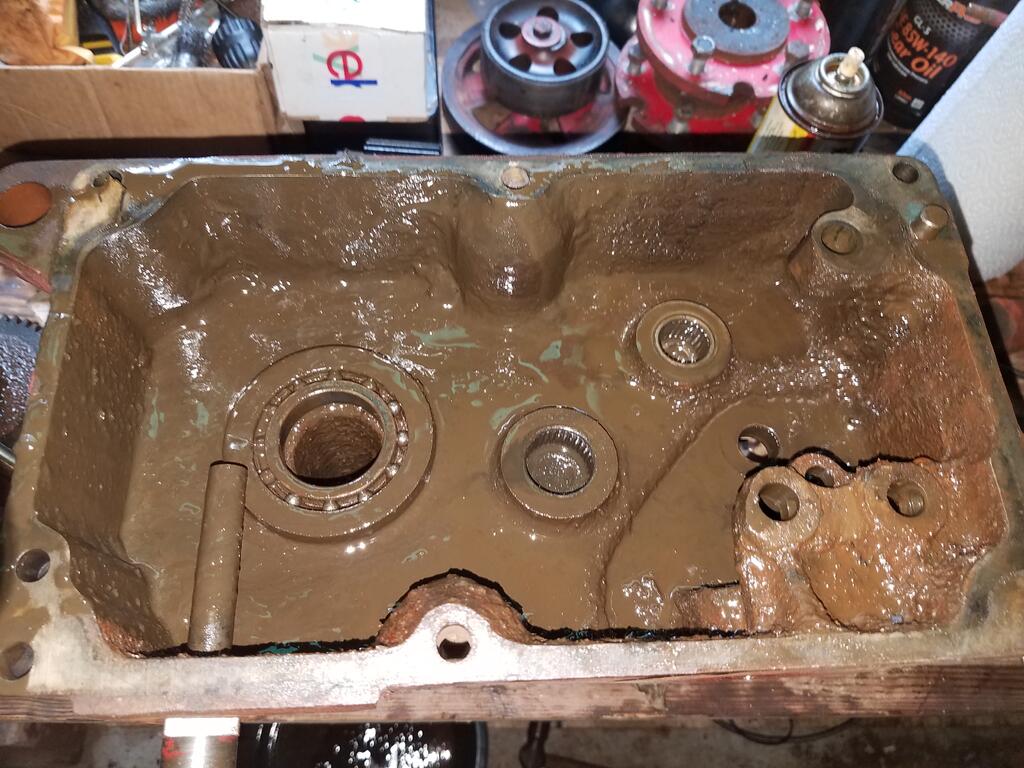

tntatro 181 #16 Posted May 24, 2022 I cleaned up the case halves a little. One of the bearings lost it's needles when I was cleaning but I have good used ones for replacement. There's a lot of rust but I think the gears and case halves are fine to use. I think I'll use the pressure washer on them to get the grit out and see which bearings need to be replaced. I have enough used bearings from previous rebuilds to replace all the bearings if I needed to but I don't think they will all need it. I found another 1533 bearing so I have three extra. One is a little rusty and loose but the other two are a lot better than what is in the case halves. 1 Share this post Link to post Share on other sites

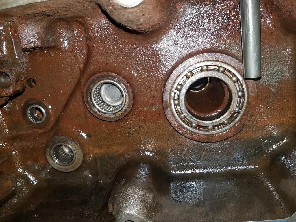

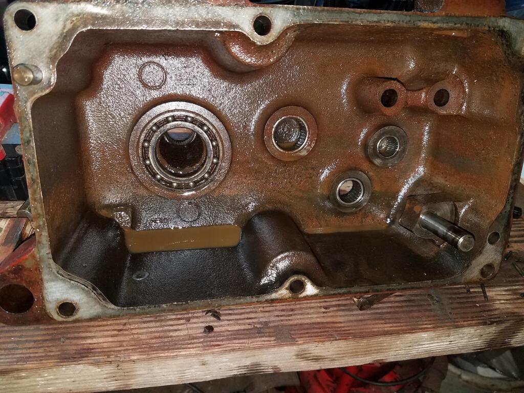

tntatro 181 #17 Posted May 24, 2022 Here's the other half. It's not as bad. 1 Share this post Link to post Share on other sites
tntatro 181 #18 Posted May 25, 2022 I cleaned them up a little more and replaced some bearings with better used ones. 1 Share this post Link to post Share on other sites

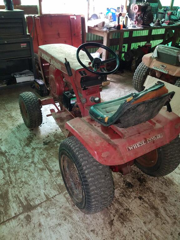

tntatro 181 #20 Posted May 25, 2022 I also got the B-80 running decent. It took a while to get the rpm right. If I set it around 3,400 rpm it seems to have to work hard to go uphill. If I set it around 3,800 rpm it seems a lot more powerful. I had a hard time getting it right around 3,600 rpm. Also, if I throttle it up fast then the speed will go way up at first then lower down to normal after a few seconds. My tachometer jumps around a bit and I don't know how accurate it is but I think I got it between 3,500 and 3,700. It also seems loud for a K181. Must be the muffler. The deck is also loud. Share this post Link to post Share on other sites
stevasaurus 23,662 #21 Posted May 25, 2022 Just looking at your pictures of the new/used bearings in the case halves...make sure your bearings are set flush with the top of their receptacles. or you will be pinching the shafts when you bolt it together. 1 Share this post Link to post Share on other sites
Snoopy11 5,731 #22 Posted May 25, 2022 On 5/21/2022 at 11:16 AM, stevasaurus said: All the flushing in the world will not fix a bad or rusted bearing. You will only ruin the shaft in that bearing. I second that... (different transmissions in mine)... but what Steve said is definitely CERTAINLY correct. I hear of a lot of "flushing" transmissions... but with these old restores... there is no substitute for opening up that transmission, cleaning, and replacing... Hell of a job @tntatro Don 1 Share this post Link to post Share on other sites
tntatro 181 #23 Posted May 25, 2022 2 hours ago, stevasaurus said: Just looking at your pictures of the new/used bearings in the case halves...make sure your bearings are set flush with the top of their receptacles. or you will be pinching the shafts when you bolt it together. Thanks, I just double checked and they were slightly high. 1 Share this post Link to post Share on other sites

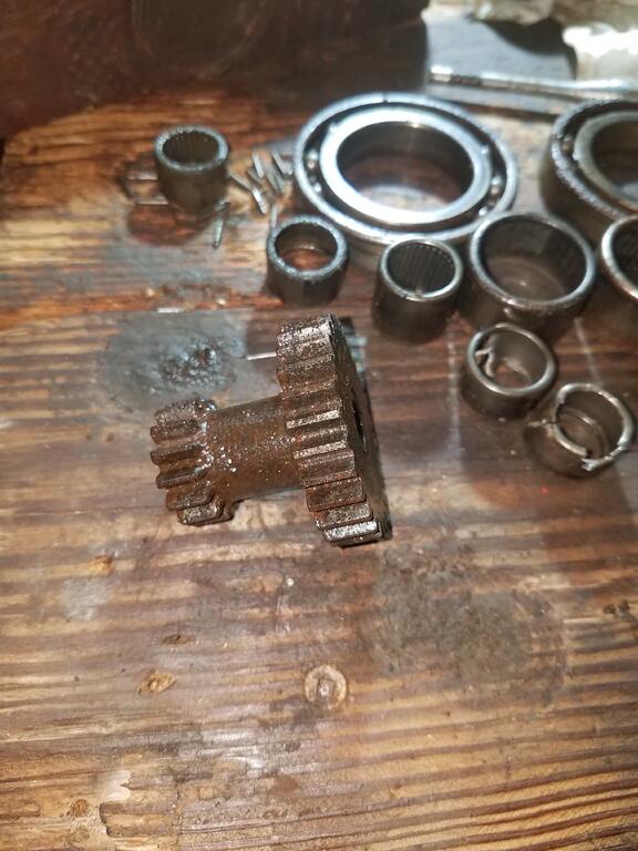

tntatro 181 #24 Posted May 25, 2022 The bearings in this gear were locked up. They didn't look that bad but wouldn't move. Share this post Link to post Share on other sites
stevasaurus 23,662 #25 Posted May 25, 2022 Those bearings are WH #7207 (2) 3/8" ID. I do not know the height, but if it is 1/2" height the bearing would be KOYO or Torrington B-0608. Measure the height and inside diameter and put it here...I can tell you the bearings to get. Here is how KOYO and Torrington size their bearings..."B" = through bearing. The inside diameter and the height are in 16" , with the ID 1st and the height 2nd. So we have "B" with 3/8" ID which is 6/16". If the height is 1/2" that = 08/16". So your bearing is B-0608. If the height is 5/8"...it would be B-0610. Understand?? 1 Share this post Link to post Share on other sites
