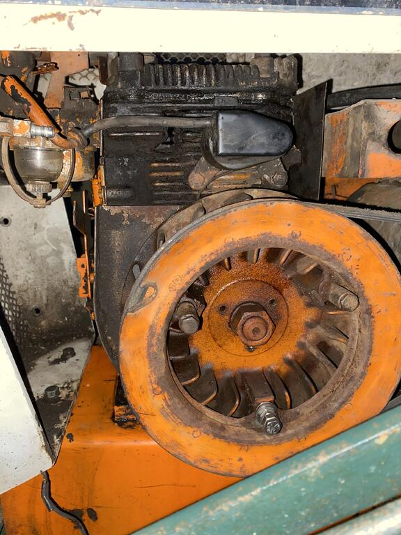

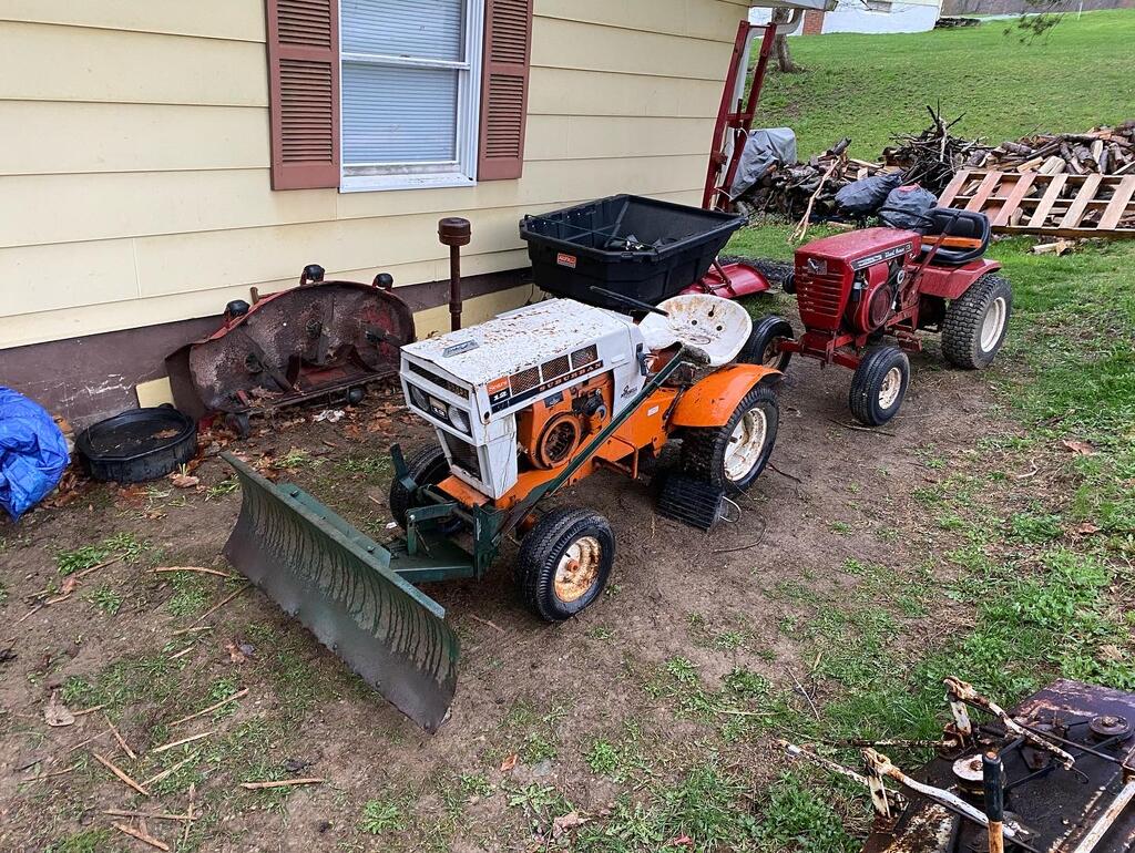

Thompson1276 257 #1 Posted May 14, 2022 I got a HH120 Tecumseh the ignition failed and for the parts is $700 in total if I want it out of box but I found a Kohler collector that has a K321 and k341 and the HH120 in it had a starter generator with a voltage regulator, and was wondering if these gear starter kohlers k series would work electrically i don’t care if I have to rewrite I can do that just need a little help maybe a diagram or a yes or no or yeah, for a 67’ Sears Suburban 12 1 Share this post Link to post Share on other sites

953 nut 59,716 #7 Posted May 14, 2022 If the Tecumseh has a battery ignition and the Kohler also has a battery ignition system then the only difference would be a solid state voltage regulator for the charging system. If the Tecumseh is a magneto or solid state ignition (which I suspect it is) then there will be a slight bit of wiring to be altered and a new 103-990 ignition switch. Give us a bit more information and we can come up with the drawings you'll need to pull this off. 1 Share this post Link to post Share on other sites
Thompson1276 257 #8 Posted May 15, 2022 On 5/14/2022 at 11:33 AM, 953 nut said: If the Tecumseh has a battery ignition and the Kohler also has a battery ignition system then the only difference would be a solid state voltage regulator for the charging system. If the Tecumseh is a magneto or solid state ignition (which I suspect it is) then there will be a slight bit of wiring to be altered and a new 103-990 ignition switch. Give us a bit more information and we can come up with the drawings you'll need to pull this off. The Tecumseh is a magneta and the Kohler is a points and condenser or solid state I don’t remember Share this post Link to post Share on other sites
Handy Don 13,948 #9 Posted May 16, 2022 So likely you'll need he wiring changes and new ignition switch that @953 nut mentions. Share this post Link to post Share on other sites
pfrederi 18,628 #10 Posted May 16, 2022 If the Techy was a magneto or electronic and the Kohler is a breakerless no switch change needed. 1 Share this post Link to post Share on other sites
