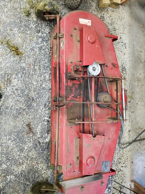

akoehler 13 #13 Posted May 11, 2022 Here's the deck that's giving me trouble. Have to post these images separately cause they're too large, sorry. 1 Share this post Link to post Share on other sites

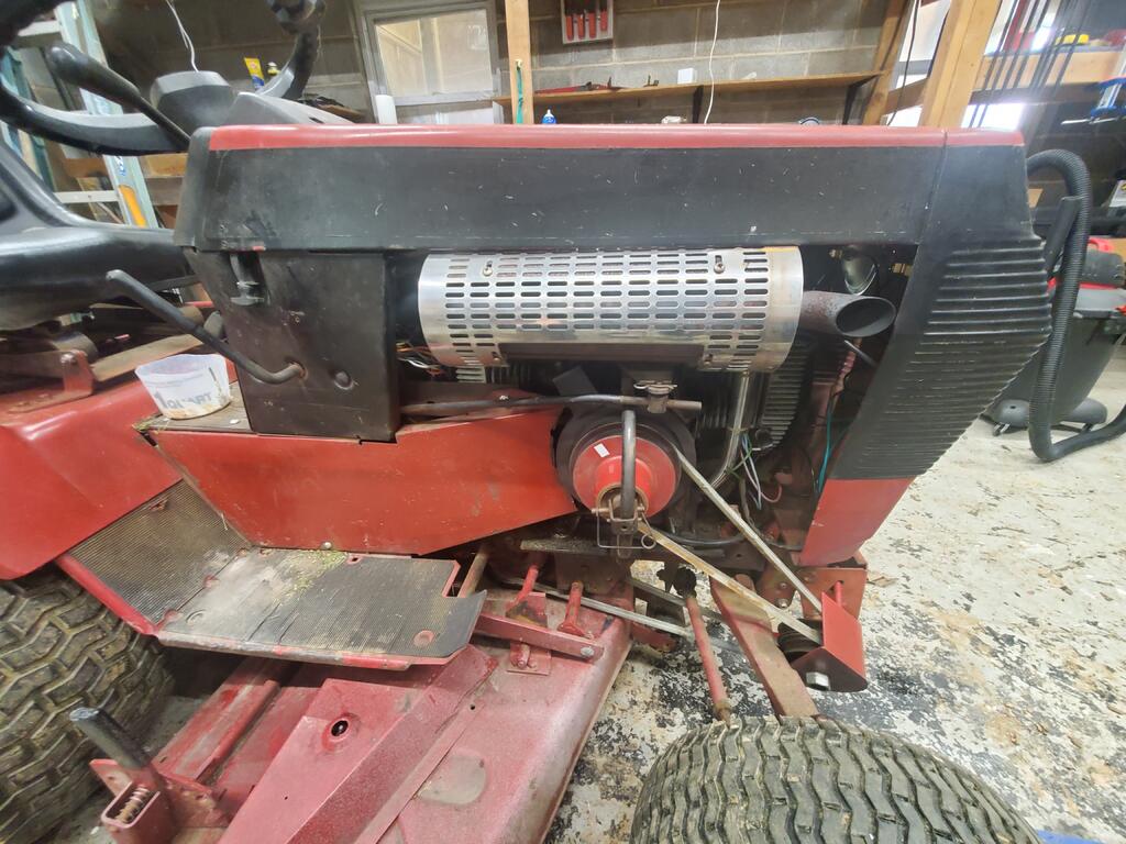

akoehler 13 #14 Posted May 11, 2022 (edited) Here's the position of the trunnion on the PTO linkage. Edit: this is the 42" deck mounted, not the 60", but the trunnion position hasn't changed. Edited May 11, 2022 by akoehler Clarification of image. 1 Share this post Link to post Share on other sites

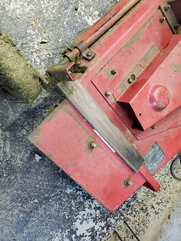

akoehler 13 #15 Posted May 11, 2022 Here you can see the PO's handiwork on the wheel height adjust. 1 Share this post Link to post Share on other sites
lynnmor 9,051 #16 Posted May 11, 2022 3 hours ago, akoehler said: Lastly, I have NOT sharpened the blades yet. It's that something I can do by hand (with a benchtop grinder) or do I need to setup a jig to hold the blade at the right angle? I always use a bench grinder, a file would take me all winter. I don't use a jig but it takes some finesse to get it right doing it freehand. I tried to find a video for you and saw all kinds of poor workmanship, it you need help, again I am right down the road. In your photo, it appears that you have the deck belts all wrong, refer to the manual. 2 Share this post Link to post Share on other sites
akoehler 13 #17 Posted May 11, 2022 26 minutes ago, lynnmor said: In your photo, it appears that you have the deck belts all wrong, refer to the manual. Just double checked the manual as well as the sticker on the deck, belts seem to be correct with one uncertainty: due to the quality of the images, I can't tell whether the deck belt goes on the top or bottom pulley. Right now the deck pulley is on the lower of the two and the PTO drive belt is on the upper. The rest of the belt routing matches the diagrams in both the sticker and the manual. 1 Share this post Link to post Share on other sites

lynnmor 9,051 #19 Posted May 11, 2022 1 hour ago, akoehler said: Just double checked the manual as well as the sticker on the deck, belts seem to be correct with one uncertainty: due to the quality of the images, I can't tell whether the deck belt goes on the top or bottom pulley. Right now the deck pulley is on the lower of the two and the PTO drive belt is on the upper. The rest of the belt routing matches the diagrams in both the sticker and the manual. That is what I saw, you need to swap positions. I couldn’t determine if the mule drive is correct, it should have the two pulley offset a bit and there should be a spring attached, also look for a grease fitting. 1 Share this post Link to post Share on other sites
Ed Kennell 47,597 #20 Posted May 11, 2022 3 hours ago, akoehler said: Just double checked the manual as well as the sticker on the deck, belts seem to be correct with one uncertainty: due to the quality of the images, I can't tell whether the deck belt goes on the top or bottom pulley. Right now the deck pulley is on the lower of the two and the PTO drive belt is on the upper. The rest of the belt routing matches the diagrams in both the sticker and the manual. The belts look correct to me. The deck belt gos on the bottom pulley and PTO belt on top. The PTO belt does look thin. Is it the correct width? What does look wrong is the attachment at the mid attach-o-matic. The fork on the deck rod has to hook on the att-o-mat rod. Yours looks like it is rotated back and not hooked. 1 Share this post Link to post Share on other sites
akoehler 13 #21 Posted May 11, 2022 1 hour ago, lynnmor said: That is what I saw, you need to swap positions. I couldn’t determine if the mule drive is correct, it should have the two pulley offset a bit and there should be a spring attached, also look for a grease fitting. In the picture is the mule drive for the 42" deck as that is what I have on there now. The mule is different for the 60" deck (the 60" mule has the offset pulley.) Tho I don't see a spring on the mule anywhere. I did swap the pulley positions on the 60" deck however and the whole thing feels better. If mowing takes too long with the 42" rear discharge that I just put on there, I might consider putting the 60" back on. 1 Share this post Link to post Share on other sites
