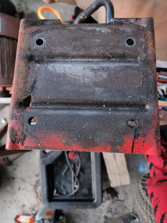

Monstrosity 1,153 #54 Posted May 26, 2022 So found out why it felt like it was flexing a I came up the grade at an angle the transaxle mounting plate on the frame has cracked around all four holes... a little set back but glad I found it now. Been busy cleaning up the yard for Memorial day been attacking this between 5am-6am. I picked up Majik IH Red oil based enamel paint and a spray gun from the China freight well see how it works. 1 1 Share this post Link to post Share on other sites
ebinmaine 81,289 #55 Posted May 26, 2022 Definitely a common issue on the Horses Monster. Plate replacement would obviously be preferred ... Fairly easy fix with even bolt-on Parts if you don't have Fab skills or a welder. I'll share a thread link in a minute. 1 Share this post Link to post Share on other sites

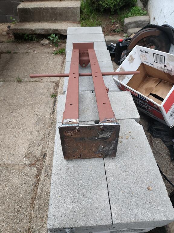

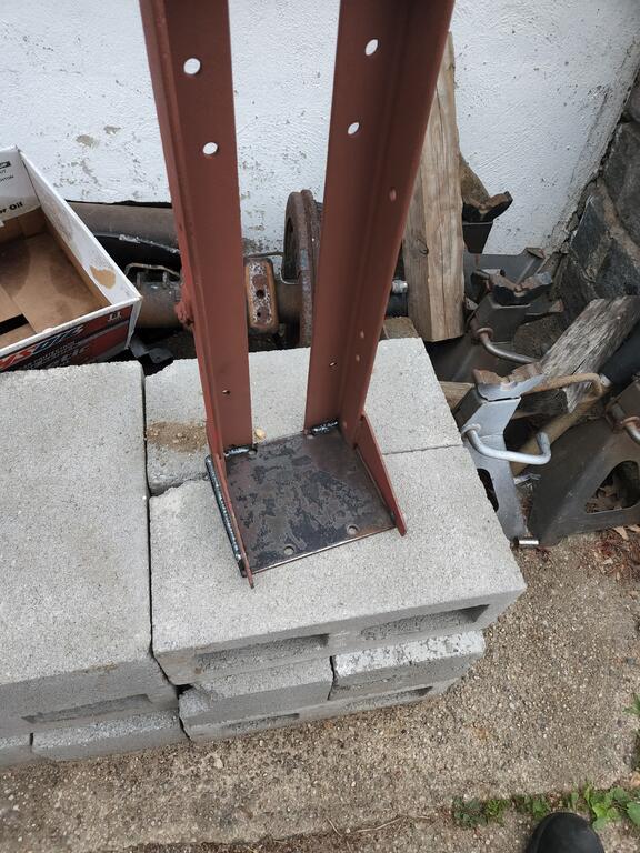

Monstrosity 1,153 #58 Posted June 2, 2022 (edited) So this is the fix I had laying around. A customer of mine did me a solid, welding it up I just wished he welded the inside edge instead of the outside but I cannot complain. Just need to drill mounting holes. Edited June 2, 2022 by Monstrosity 3 2 Share this post Link to post Share on other sites

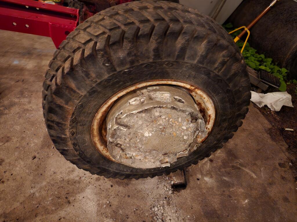

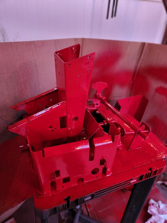

Monstrosity 1,153 #59 Posted June 8, 2022 Slowly getting back together! I just got my gallon of of IH red paint, just need hardener now and to get these damn cement wheel weights they won't come out... Now I'm making a mess.. I wanted to split the case while everything was getting paint but looks like that's happening later on now.. tractor is going to be 2 toned with a charcoal grey 4 Share this post Link to post Share on other sites
ebinmaine 81,289 #60 Posted June 8, 2022 5 hours ago, Monstrosity said: and to get these damn cement wheel weights they won't come out... Corroded into perma-position? If you can access the inside of the wheel with a long puncher poker pusher maybe beat them from inside out through the carriage bolt holes? Best bet might be an impact hammer/chisel from either side. Certainly would be a great idea to get them out while you're at this stage and get new seals in the transmission. 2 Share this post Link to post Share on other sites
lynnmor 9,081 #61 Posted June 8, 2022 10 hours ago, Monstrosity said: Slowly getting back together! I just got my gallon of of IH red paint, just need hardener now and to get these damn cement wheel weights they won't come out... Now I'm making a mess.. I wanted to split the case while everything was getting paint but looks like that's happening later on now.. tractor is going to be 2 toned with a charcoal grey We had a ugly seat contest, it now may be time for a ugly wheel weight contest. 1 1 Share this post Link to post Share on other sites
Monstrosity 1,153 #62 Posted June 8, 2022 5 minutes ago, lynnmor said: We had a ugly seat contest, it now may be time for a ugly wheel weight contest. Go for it 🤣🤣 that's after I've been trying to chip it away tried to get behind and hit studs but they are starting to mushroom and bend...... I can only attack this mid day and I'm never home mid day lol 2 1 Share this post Link to post Share on other sites

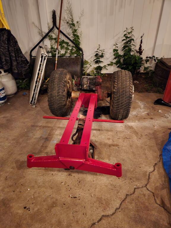

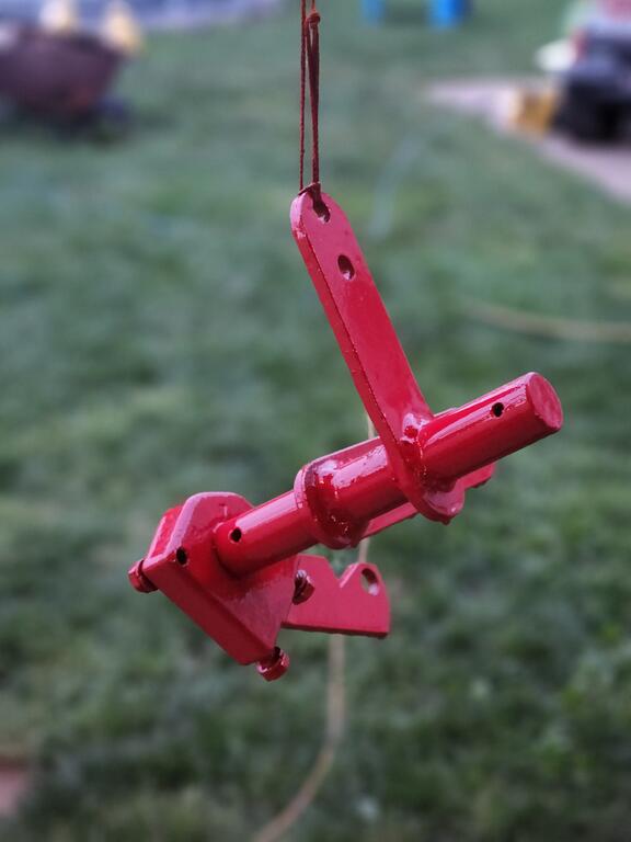

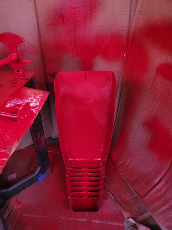

Monstrosity 1,153 #63 Posted June 12, 2022 Never used a spray gun before and I cheated out on an electric sprayer... RUN DMX definitely sprayed these pieces... And omg what a mess... I think next time I'll stick with my rattle cans but..... I like how thick the oil based enamel paint from majic is and yes I used reducer and hardener. All I have to say is praise the lord I had a can of mineral spirits.... 4 Share this post Link to post Share on other sites

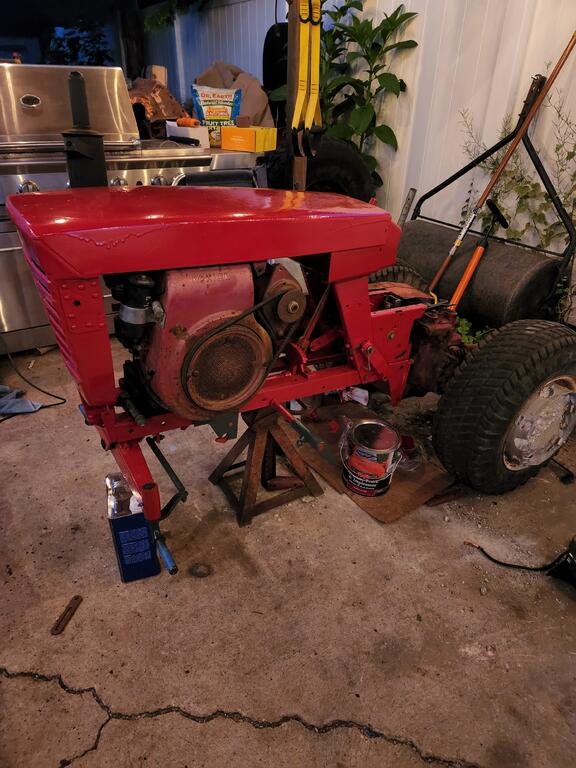

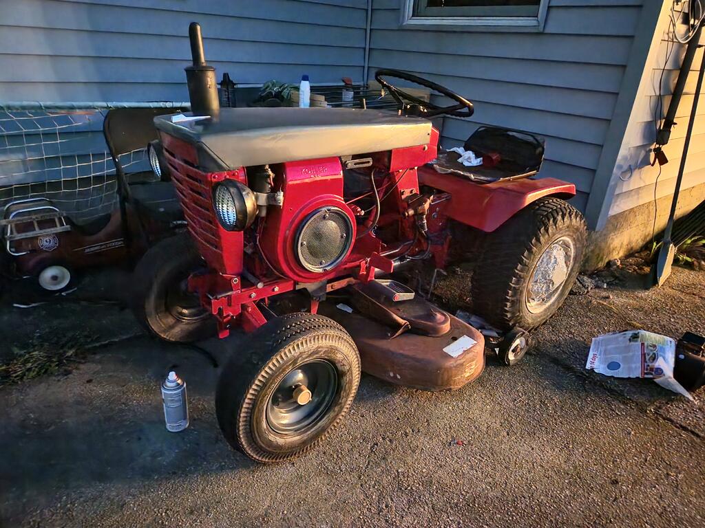

Monstrosity 1,153 #64 Posted June 20, 2022 Updates need help what color to paint the engine I'm 2 toning the hood charcoal grey.... should I paint the engine red or grey? Don't mind the HUGE RUNS the hood fell off the stand when wet into the grass...... and I put a generous amount back on the top so I can sand it flat when the grey gets sprayed. 1 Share this post Link to post Share on other sites
ebinmaine 81,289 #65 Posted June 20, 2022 7 hours ago, Monstrosity said: 2 toning the hood charcoal grey.... should I paint the engine red or grey? 'round these pahts we likes our engines to contrast. 1 Share this post Link to post Share on other sites

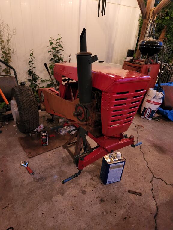

Monstrosity 1,153 #71 Posted July 18, 2022 So with the S/G down and out I figured I'd paint the engine. 2 1 Share this post Link to post Share on other sites

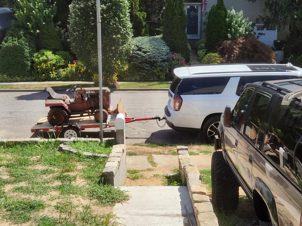

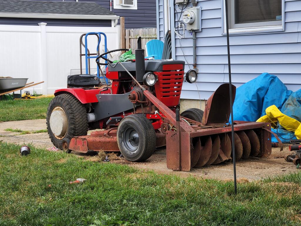

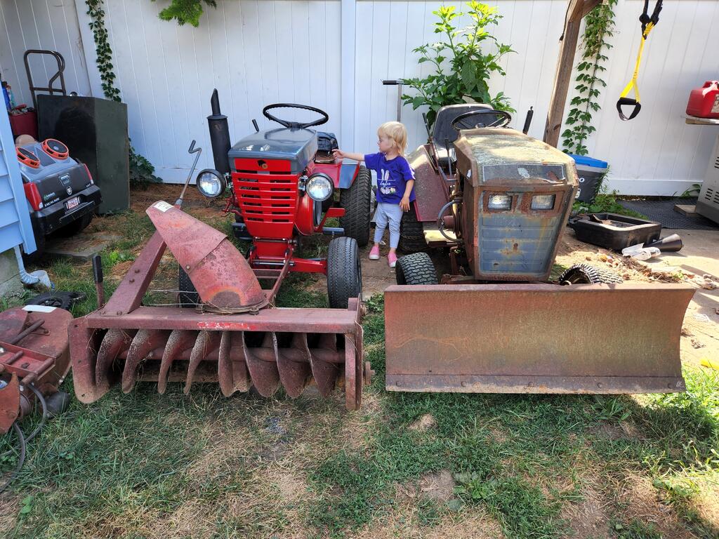

Monstrosity 1,153 #72 Posted July 31, 2022 (edited) Picked up the plow the other day it came with a C-125 it's rough has more safety features than I'd like... which maybe the route cause of no spark. Going to be looking through the manual at the wiring diagram soon to remove said safety features. If it runs nice I may fix it up but I may just end up parting out no a big fan of the plastic fenders, and i want to get a manual trans too. This c-125 has a BAD left side axle seal been leaking a loooong time. Who knows my wife might like it then she can clear the side walk of snow 😝😝 Edited July 31, 2022 by Monstrosity 1 1 Share this post Link to post Share on other sites
Monstrosity 1,153 #73 Posted July 31, 2022 On 5/8/2022 at 7:47 AM, rjg854 said: Sounds good, and I think you about hooked on our little red tractors I think you nailed that one on the head 1 Share this post Link to post Share on other sites
ebinmaine 81,289 #74 Posted July 31, 2022 Might very well be worth an hour or two to remove the junk wiring and temporarily wire it like a '67 or so sans all the safeties. Likely that Kohler 12 will be a runner. No worries on the axle seal. Replace all the transmission seals. That plastic fender... I think I've read that it can be retrofitted to a metal one?? 1 Share this post Link to post Share on other sites
