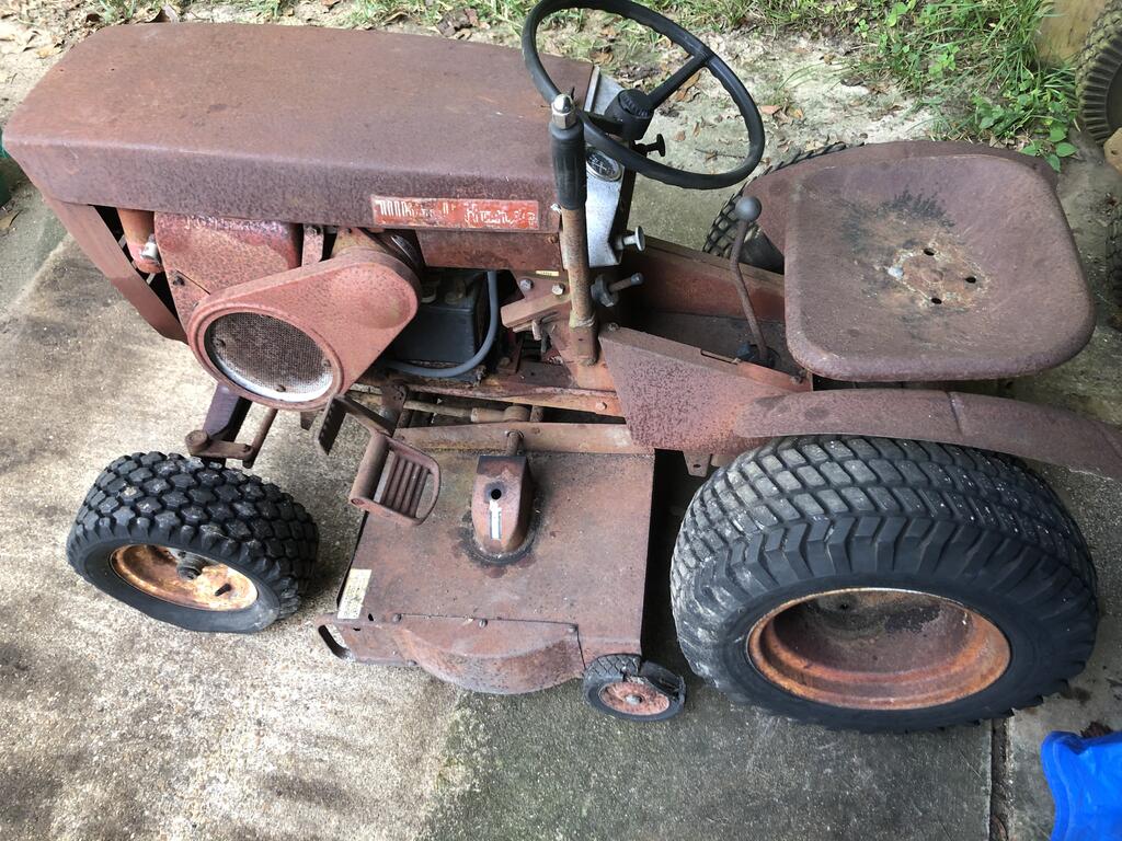

Michael Ragan 12 #1 Posted May 5, 2022 Help , I have all original Wheel Horse 1045 , I need to find out what size or brand of belt that fits the starter generator to the engine. It has the original Kohler 10 hp k241 engine I am pretty sure. Thank any help is appreciated Michael 1 2 Share this post Link to post Share on other sites

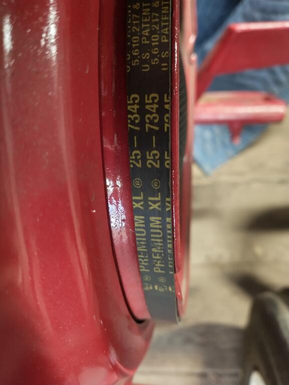

squonk 48,076 #4 Posted May 5, 2022 Mike, Napa / Gates 25-7345 Rubber edged cogged belt. Will get you right in the middle of the adjustment. Costs more than a 4L350 belt but it will grip better and run cooler. Notched design fits around smaller pullies easier. Belt Angle: 37 Deg Belt Construction: Notched Belt Material: Ethylene (EPDM) Brand: NAPA Cord Material: Polyester Cross Section Designation of Belt: HC41 Effective Length: 34.59 in Manufacturer: Gates Notched Belt: Yes Number of Strands: 1 Outside Circumference: 35.35 in SDS Required: No Top Width: .41 4 1 Share this post Link to post Share on other sites

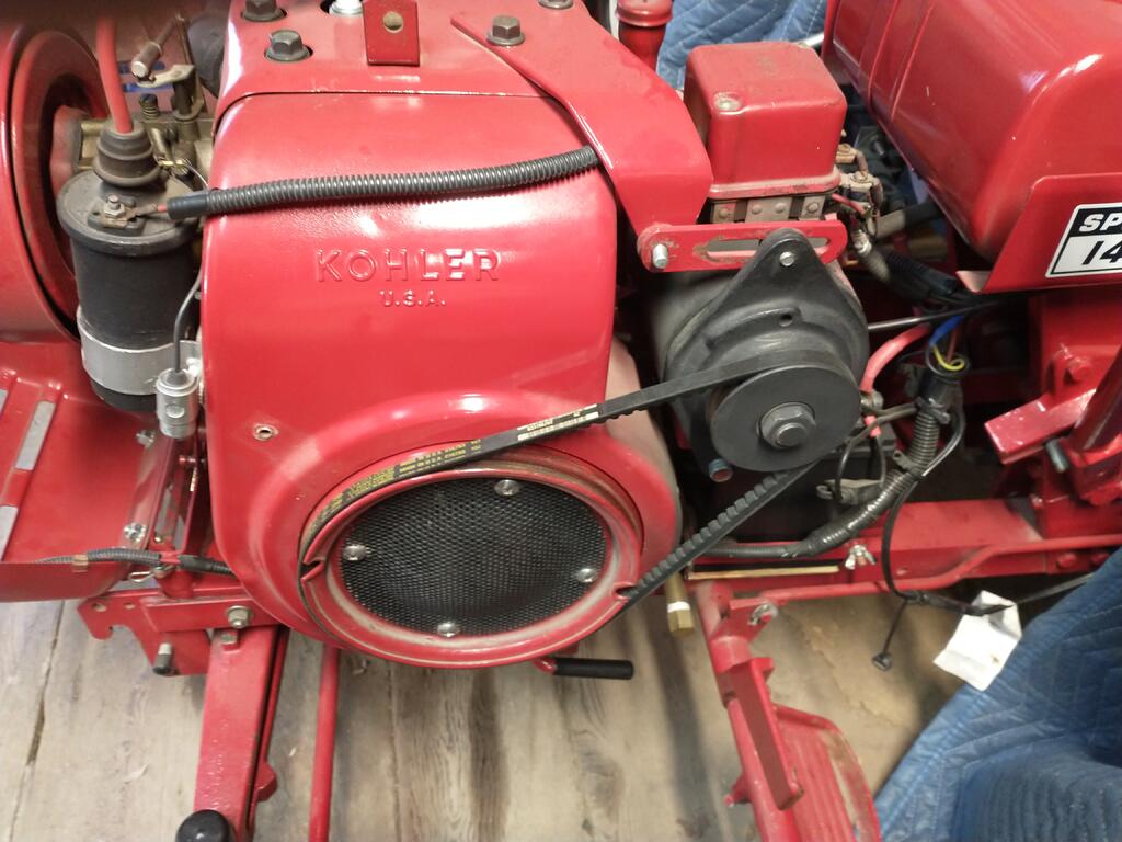

squonk 48,076 #8 Posted May 9, 2022 51 minutes ago, WHX?? said: Sure that's a good number Squonky? My NAPA gave me the deer in the headlights..... can't find good help! The 1045/1055 K motor doe's not have ACR so would like to try a notched one. Did you give him the right number or maybe he needs a hearing aid! https://www.napaonline.com/en/p/NBH257345?impressionRank=1 https://www.napaprolink.com/Detailmi.aspx?R=NBG257345 Share this post Link to post Share on other sites
squonk 48,076 #9 Posted May 9, 2022 @WHX?? In case they want more proof, show them this! 3 Share this post Link to post Share on other sites
