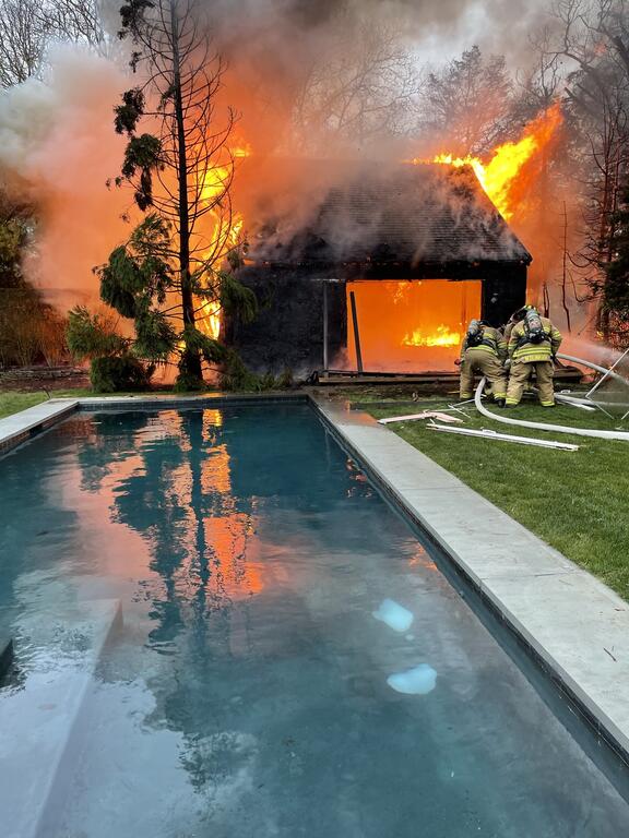

c-series don 11,853 #10 Posted May 5, 2022 All I know is that if you have a LP gas leak in your pool house and have an explosion this is what it will look like. I’m a volunteer firefighter and this is what we get called out for last evening. Mutual aid from three area departments. 3 Share this post Link to post Share on other sites
bc.gold 3,406 #11 Posted May 5, 2022 (edited) 35 minutes ago, c-series don said: All I know is that if you have a LP gas leak in your pool house and have an explosion this is what it will look like. I’m a volunteer firefighter and this is what we get called out for last evening. Mutual aid from three area departments. Your guys have a top notch investigative forensic team. Hope no lives were lost and that the homeowner is insured to cover this loss of property. Edited May 5, 2022 by bc.gold 1 Share this post Link to post Share on other sites
bc.gold 3,406 #12 Posted May 5, 2022 I would like to make it known, I do have a healthy respect for flammable gas's. The Milwaukee Fuel series use a brush less motor, no arcs or sparks and the steel socket is working against brass. The last of the valves. 5 Share this post Link to post Share on other sites
squonk 46,182 #13 Posted May 5, 2022 10 hours ago, c-series don said: All I know is that if you have a LP gas leak in your pool house and have an explosion this is what it will look like. I’m a volunteer firefighter and this is what we get called out for last evening. Mutual aid from three area departments. Pool heaters are notorious for getting all clogged up with soot and corrosion. Chlorine fumes start rotting pipes and fittings. Nobody likes working on them so homeowners end up bypassing a safety or 2 then WHAMMO! 1 1 Share this post Link to post Share on other sites
Jeff-C175 7,207 #14 Posted May 5, 2022 14 hours ago, c-series don said: pool house I didn't want to "like" your post, but I have to say that is an excellent photo! 2 1 Share this post Link to post Share on other sites
c-series don 11,853 #15 Posted May 5, 2022 Thank goodness nobody was inside at the time of the explosion. 3 Share this post Link to post Share on other sites

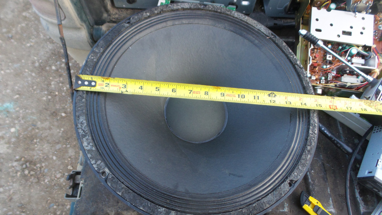

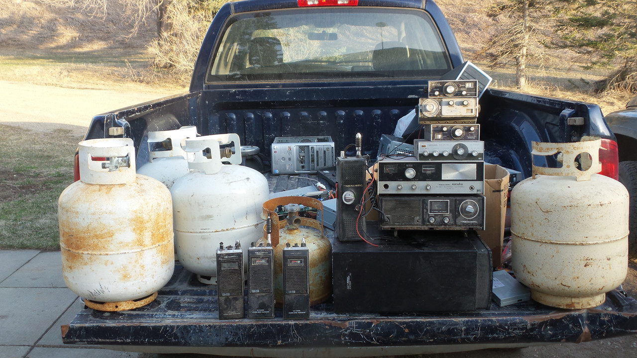

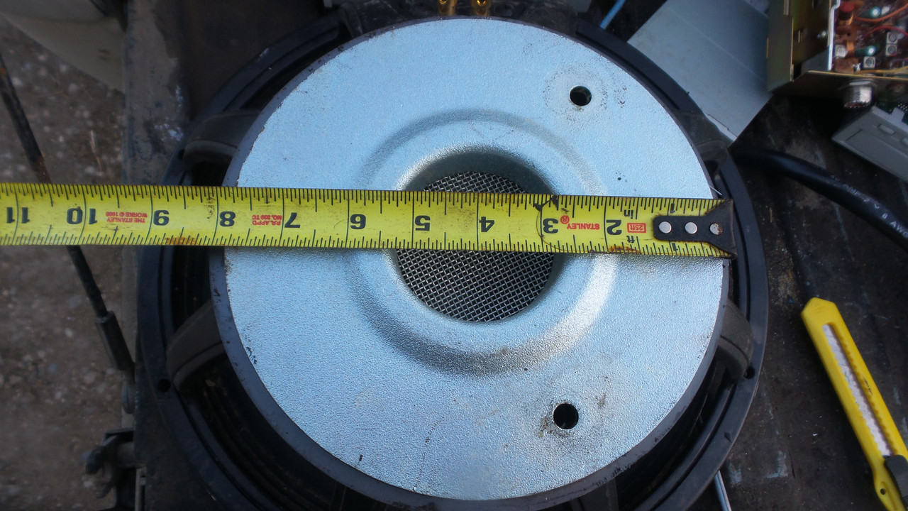

bc.gold 3,406 #16 Posted May 7, 2022 (edited) More tanks along with some old CB radio's, one large speaker that the owner wasn't aware could have been re-coned. Oh, well another awesome magnet for my collection. Edited May 7, 2022 by bc.gold 2 Share this post Link to post Share on other sites
