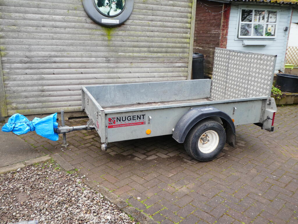

Stormin 9,987 #1 Posted May 3, 2022 After the demise of my Land Rover Discovery I replaced it with a Hyundai Santa Fee. Unfortunately the Santa Fee hasn't got the towing capacity of the Disco. Just 2 ton against the Disco's 3-1/2. So my 12ft x 6ft twin axle trailer went to live at a friends farm. At the weekend I purchased a second hand single axle trailer. 8ft x 4ft I can only carry one tractor instead of four now, but that's not a problem. Having to cut down on the shows with the way things are. It'll be also handy on my trips to my mates in Scotland for hauling logs home. I intend to remove the ramp and replace with a tailgate. Less drag and I have the light weight ramps I used with the 12 x 6 trailer. 8 8 Share this post Link to post Share on other sites

Sparky-(Admin) 24,668 #8 Posted May 3, 2022 Nice trailer! Aluminum or galvanized steel? Share this post Link to post Share on other sites
Stormin 9,987 #9 Posted May 4, 2022 7 hours ago, elcamino/wheelhorse said: @Stormin You need lessons from @pullstart (aka the flip flop kid ? he could fit 7 or 8 horses on that trailer . Problem there would be pulling it. Also I wouldn't get far before I got pulled. 7 hours ago, Sparky said: Nice trailer! Aluminum or galvanized steel? Chassis and sides galvanized. Ramp ally tread plate and floor a a composite sheet. Can't think of the name just now. 1 Share this post Link to post Share on other sites

953 nut 64,332 #11 Posted May 4, 2022 16 hours ago, Stormin said: remove the ramp and replace with a tailgate. Less drag When I saw the photo that was the first thing that came to mind, that ramp would catch a lot of air. 2 Share this post Link to post Share on other sites
Dan.gerous 2,696 #12 Posted May 4, 2022 13 minutes ago, 953 nut said: When I saw the photo that was the first thing that came to mind, that ramp would catch a lot of air. Important consideration with the fuel price these days. 1 Share this post Link to post Share on other sites
Handy Don 16,019 #13 Posted May 4, 2022 20 hours ago, Stormin said: remove the ramp and replace with a tailgate I get the convenience for landscapers who drive a low speeds on local roads to have easy on/off, but I see these trailers (and ones with the mesh ramps) on the highway all the time just causing that tow vehicle to suck fuel. Share this post Link to post Share on other sites
Stormin 9,987 #14 Posted May 4, 2022 Another thing about the ramp. The tread plate is riveted to the frame and rattles like mad due to loose rivets. 1 Share this post Link to post Share on other sites

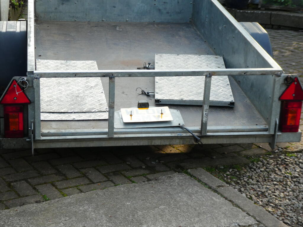

Stormin 9,987 #15 Posted May 7, 2022 Bit of work on the trailer this afternoon. Took the ramp off and ground off the insert rivets that held on the tread plate. A drill bit wouldn't touch them. Cut the frame down and cut off a couple surplus bits. Finally tack welded the altered frame. I'll take that to a local fabricator to be finally welded. I was finding things a bit difficult with my stick welder and my shaky hand didn't help. 4 Share this post Link to post Share on other sites
