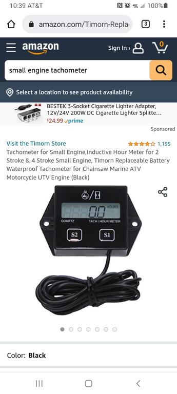

Cee245 853 #6 Posted May 3, 2022 12 hours ago, JimSraj said: Governor is going to need some more adjusting though and since I don’t have a tach I’m not sure about the high end rpms. Any help on that would be greatly appreciated. Here is a cheap tach/ hr meter I hooked up. I use it on my 417a. It has adjustable settings so you can use it on multiple applications. I set mine to 4 stroke twin and it maxes out around 3600rpm which is about what it should be. Works for me. Good luck Cory 5 Share this post Link to post Share on other sites
JimSraj 577 #7 Posted May 4, 2022 Thanks for all the advice. I’ll rechaeck that diameter tomorrow. I’ve ordered the tach that cee245 suggested. Hope I can figure out how to use it correctly. 1 Share this post Link to post Share on other sites

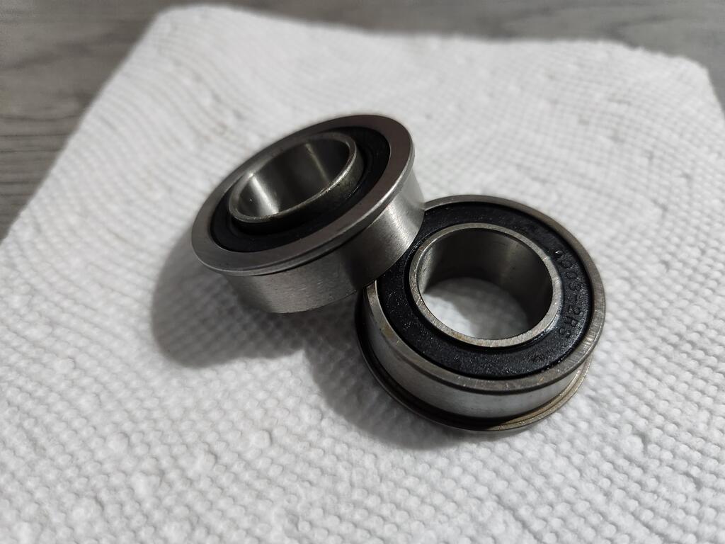

wallfish 20,002 #10 Posted September 25, 2022 1) Yes, knock them out from the inside. Just move around from side to side and around in a circle tapping them out so they go out straight. Tap them back in the same way. Fairly easy to change them. 2) Search heavy duty 3/4 ID by 1 3/8 OD flanged wheel bearing. Some are stamped steel and cheaper cost but cheaply made. Here's an example set of 4 to do them all Bearings 4 1 Share this post Link to post Share on other sites
