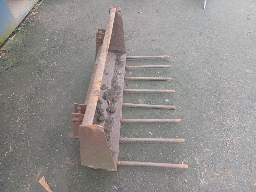

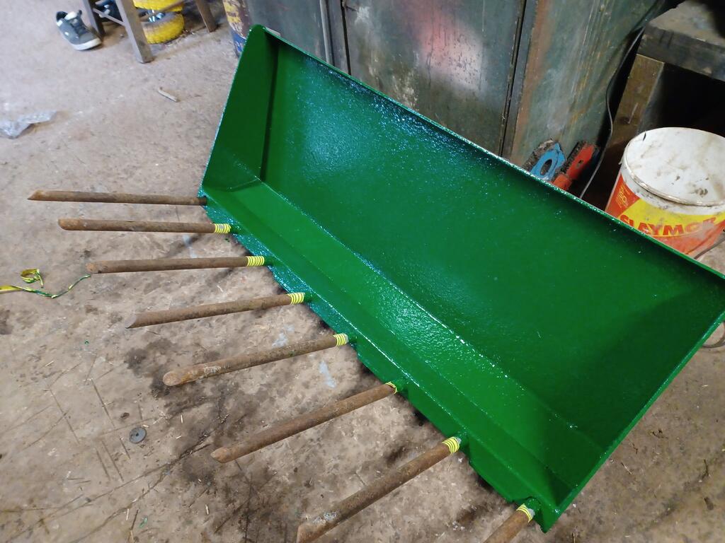

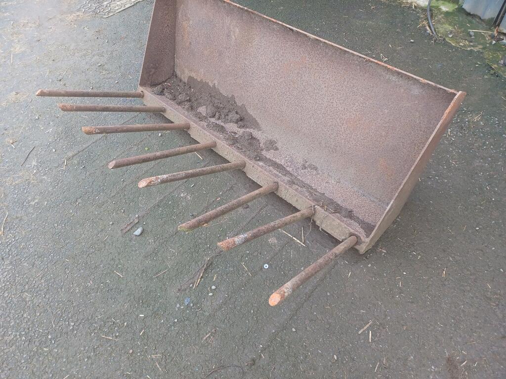

Dan.gerous 2,696 #6 Posted May 3, 2022 The backhoe also came with this muck fork. Tried to sell it but limited interest as everyone wanted the bucket fittings for their particular loader. No matter how often I explained that's its easy to chop them off and move, they didn't buy. Share this post Link to post Share on other sites

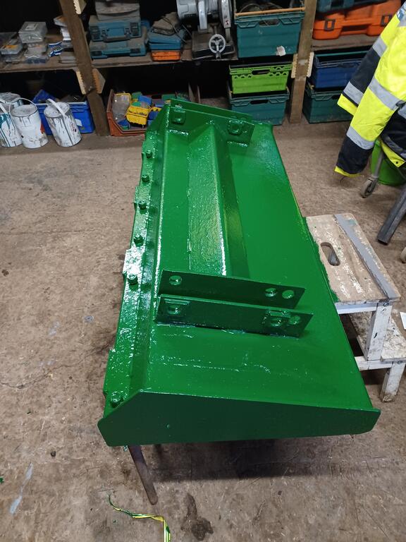

Dan.gerous 2,696 #7 Posted May 3, 2022 Even painted it and still nobody has brought it! Anyway, will just cut it down and use it for the wheelhorse when it gets its FEL. It's about 140cm wide at the moment, easily sorted! 4 Share this post Link to post Share on other sites
Pullstart 71,291 #8 Posted May 3, 2022 Cool scooper, but it’s painted the wrong color 1 3 Share this post Link to post Share on other sites
Dan.gerous 2,696 #9 Posted May 3, 2022 50 minutes ago, Pullstart said: Cool scooper, but it’s painted the wrong color I only had green left over from painting some pig huts. I actually want it black, but honestly thought it would have sold so wasn't concerned. 1 Share this post Link to post Share on other sites

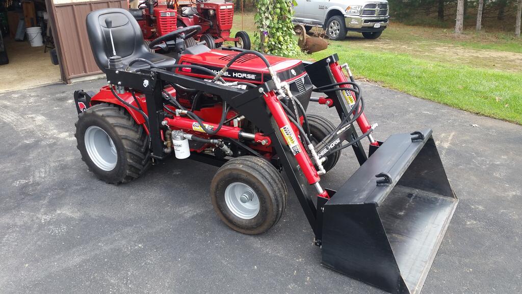

WHX?? 58,194 #10 Posted May 3, 2022 23 hours ago, Dan.gerous said: Did you build it? How much etc cheers No I did not @cschannuth here did. I got no where near the welding skills. I have some of his build pics if it helps ya when the time comes. 2 3 1 Share this post Link to post Share on other sites
Dan.gerous 2,696 #11 Posted May 3, 2022 3 hours ago, WHX?? said: No I did not @cschannuth here did. I got no where near the welding skills. I have some of his build pics if it helps ya when the time comes. That's an awesome looking machine. 1 Share this post Link to post Share on other sites

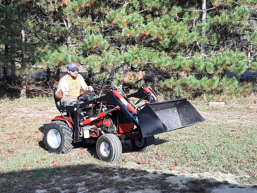

wallfish 20,619 #12 Posted May 3, 2022 I built the PF Engineering hoe. It's a perfect size for a garden tractor. Not really much good for doing daily commercial work but it does what I needed to do. It was built to dig 4-5 ft deep by about 100ft long trench for doing the power to the house underground. It did a pretty good job and it's not simple easy digging sand here in New England. Luckily no big boulders were in the path. The main thing I'd do different is to angle the stabilizer arms back 45 degrees. Straight off the sides took a pretty good beating from the leverage and I had to redo them. Something else would be joystick controls. 4 1 Share this post Link to post Share on other sites
WHX?? 58,194 #13 Posted May 3, 2022 2 hours ago, Dan.gerous said: That's an awesome looking machine. Thanks...Gets the Pullstart nod of approval. Sure is handy to have around the ranch. No idea how my back got along without it. 1 Share this post Link to post Share on other sites
Pullstart 71,291 #14 Posted May 3, 2022 3 hours ago, Dan.gerous said: That's an awesome looking machine. Aww, thanks Dan! The FEL tractor isn’t bad either! 1 3 Share this post Link to post Share on other sites
Pullstart 71,291 #15 Posted May 4, 2022 16 hours ago, WHX?? said: Sure is handy to have around the ranch. No idea how CIIIINNNNDDDDAAAAAAY’S back got along without it. 2 Share this post Link to post Share on other sites
Dan.gerous 2,696 #16 Posted May 4, 2022 @wallfishI have heard good reviews on the backhoe, and even a baby one has to be better than a shovel. I see what you mean about angling the legs back. Probably get slightly better purchase on the ground as well. 100% with joystick controls, don't want too many levers as it ruins the "flow". Share this post Link to post Share on other sites

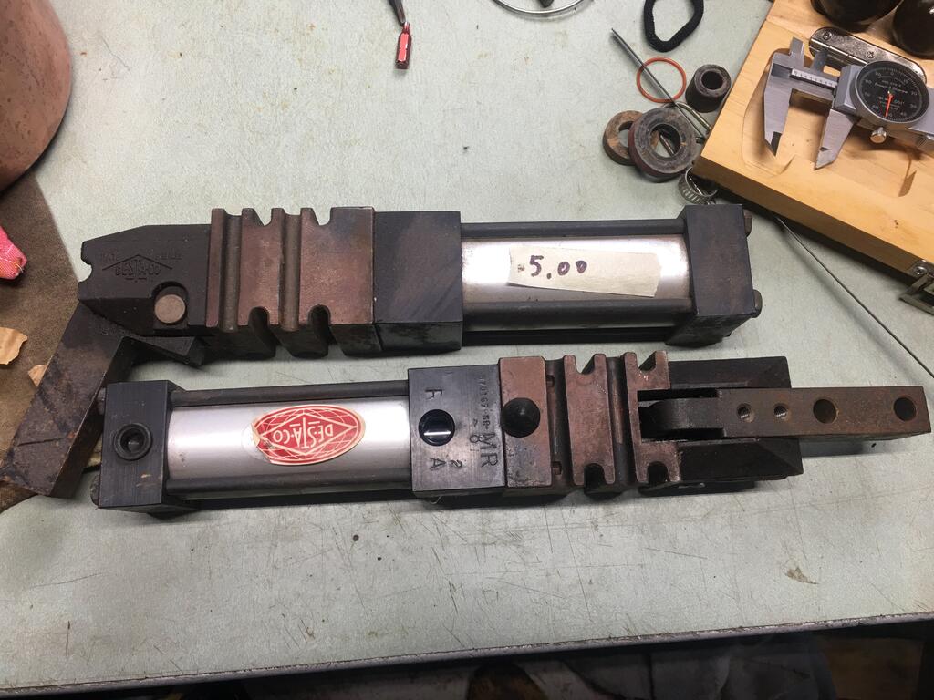

davem1111 2,373 #23 Posted May 5, 2022 (edited) 2 hours ago, WHX?? said: Yeah it would add up fast at todays steel prices. Then there's the hydraulics. Now like you said Dan if I a guy could do some scavenging repurpose some stuff??? I happened to be curious and was reading this thread, and it reminded me that I picked up these hydraulic cylinders a few days ago from the guy I was getting 2 WH tractors from. I'd need to find hoses and fittings, and fabricate whatever I'm using them for, but thought they were a steal at $5 each: A quick Google lookup says these are "clamping cylinders". I don't know much about hydraulics, so I'm not sure what application these would be good for. Probably not for something like building a FEL or a 3-point hitch, no? EDIT TO ADD: Reading a bit more about these, apparently they are supposed to be pneumatic, not hydraulic. Anyone know if pneumatic cylinders can be used with hydraulics? Edited May 5, 2022 by davem1111 2 Share this post Link to post Share on other sites
Dan.gerous 2,696 #24 Posted May 6, 2022 10 hours ago, davem1111 said: I happened to be curious and was reading this thread, and it reminded me that I picked up these hydraulic cylinders a few days ago from the guy I was getting 2 WH tractors from. I'd need to find hoses and fittings, and fabricate whatever I'm using them for, but thought they were a steal at $5 each: A quick Google lookup says these are "clamping cylinders". I don't know much about hydraulics, so I'm not sure what application these would be good for. Probably not for something like building a FEL or a 3-point hitch, no? EDIT TO ADD: Reading a bit more about these, apparently they are supposed to be pneumatic, not hydraulic. Anyone know if pneumatic cylinders can be used with hydraulics? I guess they would be like a tyre machines rim holding clamps or similar. Never thought about what they were called. I would have thought they are lighter built than a hydraulic cylinder, but that's only a guess. 1 Share this post Link to post Share on other sites
Handy Don 17,484 #25 Posted May 7, 2022 (edited) On 5/5/2022 at 9:45 AM, davem1111 said: I happened to be curious and was reading this thread, and it reminded me that I picked up these hydraulic cylinders a few days ago from the guy I was getting 2 WH tractors from. I'd need to find hoses and fittings, and fabricate whatever I'm using them for, but thought they were a steal at $5 each: A quick Google lookup says these are "clamping cylinders". I don't know much about hydraulics, so I'm not sure what application these would be good for. Probably not for something like building a FEL or a 3-point hitch, no? EDIT TO ADD: Reading a bit more about these, apparently they are supposed to be pneumatic, not hydraulic. Anyone know if pneumatic cylinders can be used with hydraulics? First, no, you cannot convert pneumatic to hydraulic. Entirely different seals and, usually, pneumatics "power" in only one direction and rely on springs or gravity for the opposite movement. Plus the tubing is much smaller in diameter (air moves lots easier than fluid). These look to me like they are from a car/truck hoist. The pivoting end forms a sort of ratchet tooth dropping into slots or crossbars on the hoist's uprights as the hoist is raised (that's the clanking sound!) This mechanical interlock safely prevents the hoist from falling due to a leak or other failure of the hydraulics. To lower the hoist, the operator first applies air to the cylinders so they retract the lock pins and then operates the hydraulic "down" valve. Edited May 7, 2022 by Handy Don 1 1 Share this post Link to post Share on other sites
