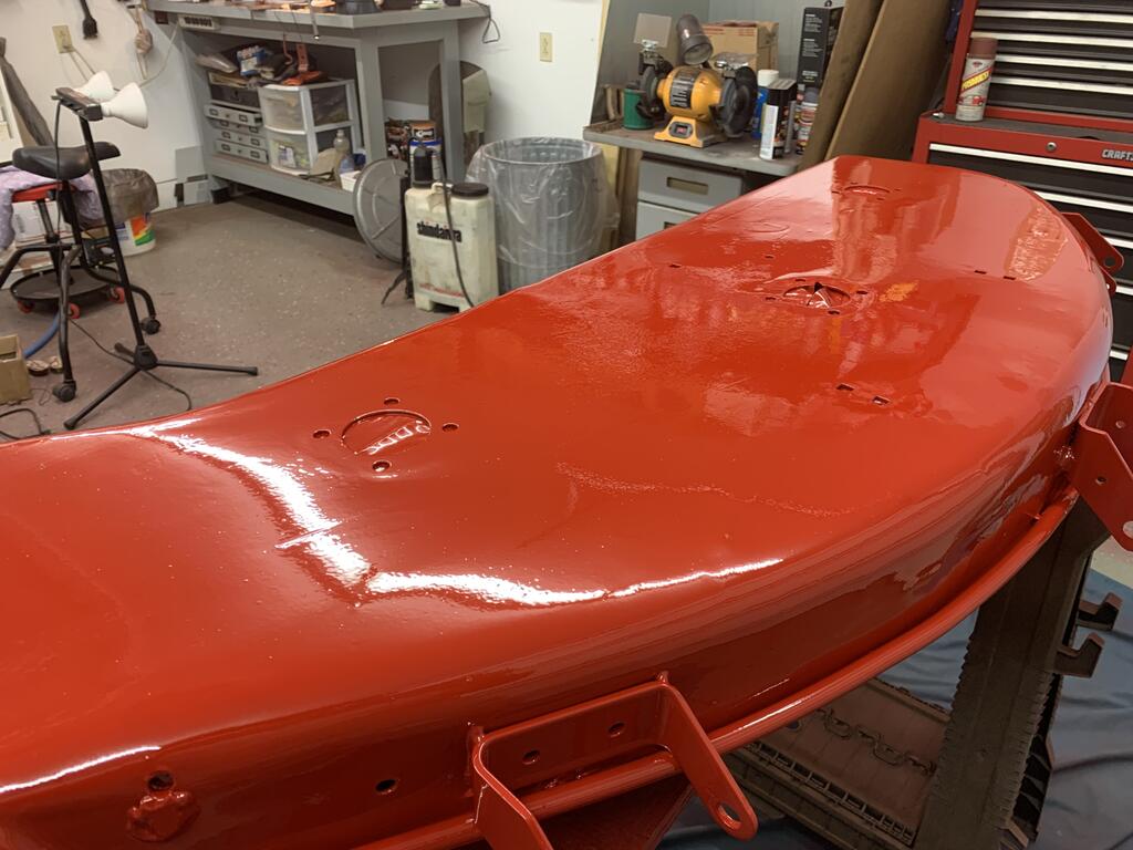

Horse Newbie 7,405 #103 Posted May 6, 2022 (edited) @davem1111 you can see my thread titled “48 inch SD Deck Restoration “ and can probably get most of your questions answered there… But keep on here and keep asking questions, we are glad to help. I know it was impossible for me to remove my pulleys from the spindle shafts without wrecking either a pulley or a shaft… I chose to get all new spindle assemblies, and pulleys. I wanted the deck to last another 30 years… Edited May 6, 2022 by Horse Newbie 8 Share this post Link to post Share on other sites
Snoopy11 5,731 #104 Posted May 6, 2022 1 minute ago, Horse Newbie said: 48 inch SD Deck Restoration If I haven't told you lately, @Horse Newbie... that deck is gorgeous! Don 1 Share this post Link to post Share on other sites
Horse Newbie 7,405 #105 Posted May 6, 2022 Thanks @Snoopy11… it is not perfect but it is better than it was already, and I’m not finished yet. Next I will be gathering up carriage bolts, and other hardware to prepare for reassembly. BTW… anybody here know if the deck belt and the PTO / drive belt for the 48 inch (1994) SD decks are the same width ? I was looking at the new center/ double pulley and it looks like the pulley grooves are different widths… 1 2 Share this post Link to post Share on other sites

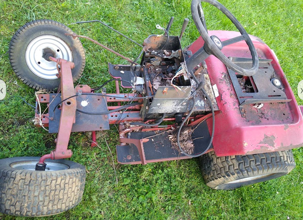

davem1111 2,453 #116 Posted May 19, 2022 Just wanted to update on the purchase and what I've done so far. The GT-1848 with the Honda GX610 ran pretty good but was fluctuating in rpms pretty wildly at lower throttle. I pulled the fuel line, re-routed it to make it about a foot shorter, and put a new filter inline. Lubed the throttle and choke cables. With the air filter off she purrs now, and that filter is pretty nasty - new one should be here tomorrow. Going to try running it again with the old air filter to see if maybe that was the major problem. In the meantime, I will need to do some work on the steering, not sure what's broken in there but it's jumping teeth. Want to clean it up but won't have time for about a month. The 416-8 I bought in this deal is siezed, as far as I can tell quickly. Not sure what I'll be doing with that. Working on refurbishing one of the two 48" decks, but I need some parts (spindle shaft and a couple of pulleys). Got the major parts repainted while I'm waiting. That's a few weeks down the road also. I'll probably be selling some parts later this summer, most likely starting with the stuff I can ship easily. I also have a lead on a parts tractor that is basically a frame with an Eaton 1100 trans, steering, front axle and wheels, and rear wheels, for maybe around $100. Might be worth it, maybe better if I can get it for $50. 5 1 Share this post Link to post Share on other sites
ebinmaine 81,284 #117 Posted May 19, 2022 5 minutes ago, davem1111 said: 416-8 I bought in this deal is siezed, as far as I can tell quickly. Not sure what I'll be doing with that. When you get a minute or six, pop the head off and the engine tins and see why it's seized. Not overly likely but it is legitimately possible it's an easy fix. Could be something ridiculous like a mouse nest. I've actually had it happen to me. You'll have no problem at all parting that one out if that's the way you decide to go. If you were closer I'd be after those rear wheels and tires. That 8-speed transmission has some value too. 7 minutes ago, davem1111 said: have a lead on a parts tractor that is basically a frame with an Eaton 1100 trans, steering, front axle and wheels, and rear wheels, for maybe around $100. Do you know what series that is? What front axle it has? If that's a 520 with a forward sweep the front axle and steering is worth three times the asking price. 3 Share this post Link to post Share on other sites
davem1111 2,453 #118 Posted May 19, 2022 40 minutes ago, ebinmaine said: When you get a minute or six, pop the head off and the engine tins and see why it's seized. Not overly likely but it is legitimately possible it's an easy fix. Could be something ridiculous like a mouse nest. I've actually had it happen to me. You'll have no problem at all parting that one out if that's the way you decide to go. If you were closer I'd be after those rear wheels and tires. That 8-speed transmission has some value too. Do you know what series that is? What front axle it has? If that's a 520 with a forward sweep the front axle and steering is worth three times the asking price. I hope to have time to poke at the Kohler 16 later in June - going to be traveling a bit so tinker time will be a bit tight. This parts tractor is on CL in Southern IN near Louisville KY, listed for $120 but I am betting I can get him down to $100 or less pretty easily. Yeah, even if the hydro is shot there's easily more parts value here than that. I've already been in contact with the guy - he said it's part of an estate sale for his dad and he doesn't know any more about it but will be looking tomorrow to see if he can get a model number or S/N. Obviously that only works if it's on the frame or rear fender - isn't that where most of them are found? See if you can tell from this picture: 1 Share this post Link to post Share on other sites
