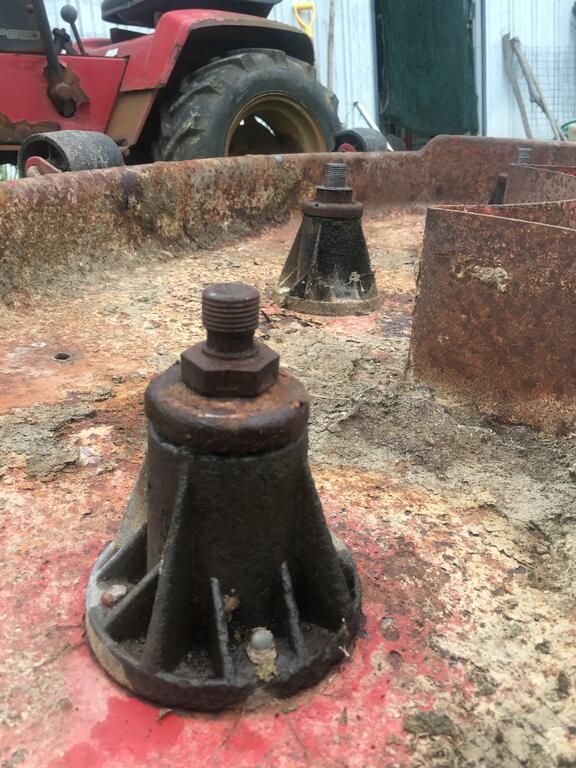

davem1111 2,453 #82 Posted May 4, 2022 Mixed luck with the "new" decks. Both are 48" cut. Oddly, the best of the 2 was on the 416-8 that doesn't look like it has run in 10-15 years (or more). I thought I'd sharpen the blades on the better deck because they were pretty dull. Took them off and found that one spindle was missing the washer under the blade, and the blade has been slopping around and wore into the shaft on the spindle. Luckily I have another old 42" deck that I think is beyond being worth repairing (at least in my case with all these decks) so I'm going to pull a spindle off that when I get time. This nicer 48" deck is going to be worth a full refurb I think. 2 1 Share this post Link to post Share on other sites

balconio 606 #93 Posted May 6, 2022 On 5/4/2022 at 7:58 PM, davem1111 said: I thought I'd sharpen the blades on the better deck because they were pretty dull. Took them off and found that one spindle was missing the washer under the blade, and the blade has been slopping around and wore into the shaft on the spindle. i have this exact same problem on a 42" SD deck, where the base of the spindle shaft is wallowed out and the threads are gone. i thought about trying to weld/grind to build it back up but i'm not sure i can be precise enough. i might try some Steel Stik putty and a wet finger to sculpt it smooth though 2 Share this post Link to post Share on other sites
davem1111 2,453 #94 Posted May 6, 2022 On 5/4/2022 at 7:58 PM, davem1111 said: I thought I'd sharpen the blades on the better deck because they were pretty dull. Took them off and found that one spindle was missing the washer under the blade, and the blade has been slopping around and wore into the shaft on the spindle. 1 hour ago, balconio said: i have this exact same problem on a 42" SD deck, where the base of the spindle shaft is wallowed out and the threads are gone. i thought about trying to weld/grind to build it back up but i'm not sure i can be precise enough. i might try some Steel Stik putty and a wet finger to sculpt it smooth though That sounds like it might be a workable approach. Although, it seems like a less desirable approach than either replacing the spindle with a "known good" used spindle, or a new one. Haven't priced the new ones lately but I'm thinking it's around $100 for a new set of 3. I'd rather not spend that now, when I have usable ones around. That said, can someone please give some pointers on removing old deck spindles? I've gone over the manuals, and it's not 100% clear to me. Once the blade nut and blade are removed, and the nut on top of the pulley is removed, do you need to use a puller to remove the pulley? Or are you supposed to immobilize the pulley and turn the nut that was under the blade? I'm not sure if I'm just dealing with rust here, but these things seem to be nearly impossible to remove (well, impossible so far...). (Obviously you need to remove the 4 bolts holding the actual spindle body to the deck, but that doesn't help with the pulley still on it.) 1 Share this post Link to post Share on other sites

Handy Don 17,736 #97 Posted May 6, 2022 1 hour ago, davem1111 said: That said, can someone please give some pointers on removing old deck spindles? I've gone over the manuals, and it's not 100% clear to me. I've only done this once. I used a puller on the pulley after leaving it soaking in penetrant for a couple of weeks (I had actually put it aside and forgot about it for most of that time). 1 1 Share this post Link to post Share on other sites
