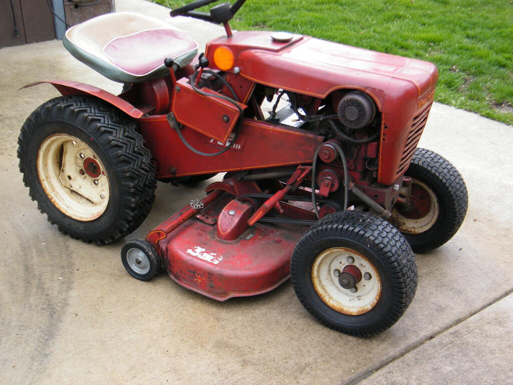

stevasaurus 23,627 #5 Posted May 1, 2022 Ed, my decks are the rear discharge,36" decks from the early 60's. RMR-364 & RMR-367. Here ya go, my 702 sporting the new deck tires. 2 Share this post Link to post Share on other sites
