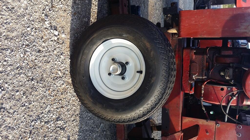

tractorhogg 667 #13 Posted April 29, 2022 3 hours ago, 76c12091520h said: Wheel bearings for this application are non-existent. As hard as it is to believe, Wheel Horse was about the only application for this bearing and there is no crossover to any other manufacturer. The only thing you can do is watch for some that occasionally pop up on Ebay, or search for some nos bearings. I sold a couple sets in the last couple years, and they are not cheap. You can switch to a 5.70-8 tire and wheel and use 1" timken bearings, but you will have to use a dexter shorty cast iron 4 bolt hub. Steering is much easier and save wear on the steering components Share this post Link to post Share on other sites
tractorhogg 667 #14 Posted April 30, 2022 13 hours ago, JoeM said: Yep. Had a D160, not much on power. I could actually bog it down with the hydro. I had the common hydro coupler issues with the o'rings that leaked from time to time on the steel tube lines running the rear hydro motor. I think the frame would twist slightly to cause the leaks. I installed the same FEL on a 520H. The 520H was way better for work and dug much better. D160 went west to a collector. Pretty much unmolested and had the rear PTO with 3 point. Hydro cooling fan I've never experienced any overheating or leakage, but I'm only using the front blade and rear box blade on one D-160 and a 54" shaft drive tiller on the other, both are 16Hp kohler singles and they've never bogged down. I'm running 5/70-10 tires on 4 bolt 10"-3.75" steel wheels with cast tron trailer hubs and timken tapered bearings Share this post Link to post Share on other sites
JoeM 10,252 #15 Posted April 30, 2022 42 minutes ago, tractorhogg said: I'm running 5/70-10 tires on 4 bolt 10"-3.75" steel wheels with cast tron trailer hubs and timken tapered bearings that is a nice up grade. That 16 onan was on the tired side. add in the weight and FEL not mention the taller tires it was lackluster. A couple pics after I completed the build. I did get a lot of work out of it. 1 Share this post Link to post Share on other sites
